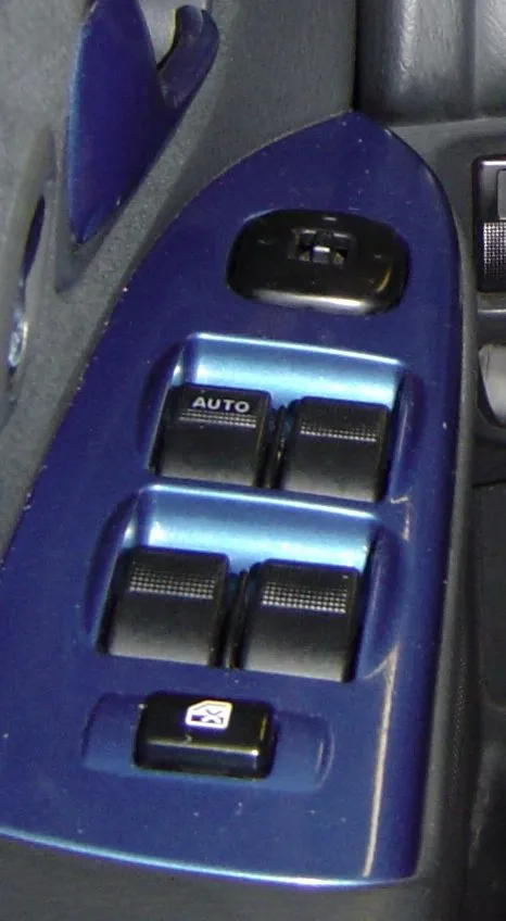

Why dont you just paint them?

actually I did... but these turned out REALLY nice.. like. I get complements on them all the time..
no chipping..
hmm.. is there a how to?
I could do one I guess
Basically just take off all the silver panels (mostly all clips..)
Sand them down with 600 grit.. till they are nice and smooth.. wash off the dust.. let dry. umm
spray on some primer, I used just black primer,.. did like 5 coats..
then I used Midnight Blue paint.. did like another 5 coats of that.. then I sprayed on some sort of clear coat.. I think it was clear coat for furniture.. super strong stuff..
did another 5 coats or so..
turned out perfect.. looks like it came that way from the factory.
