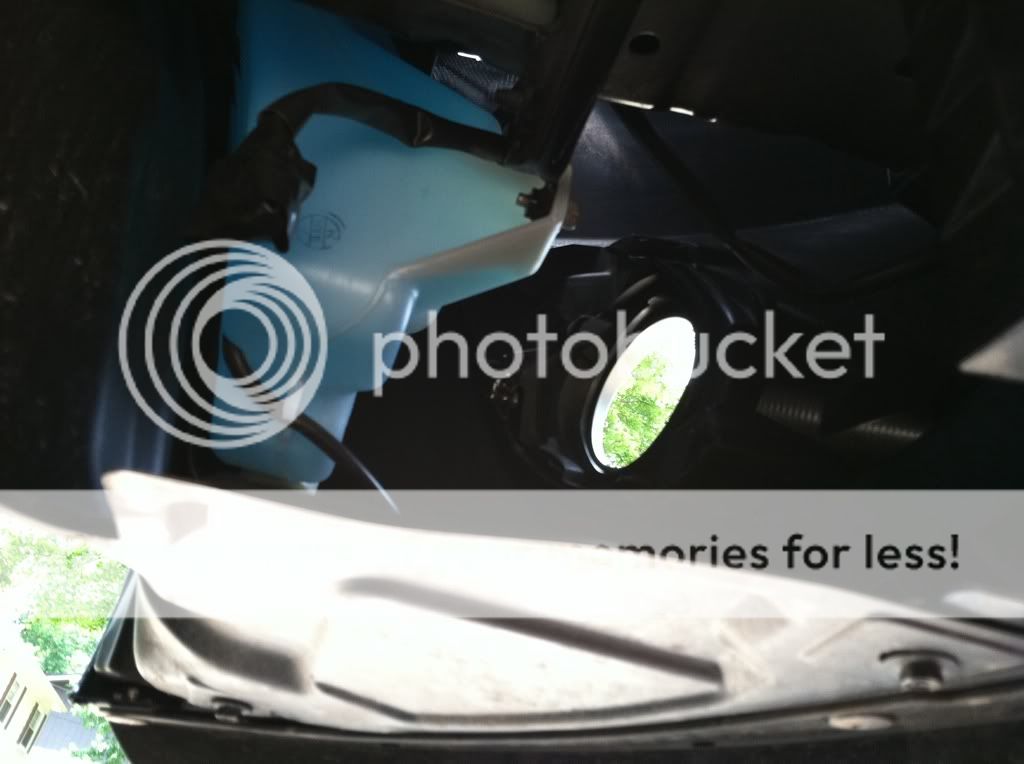

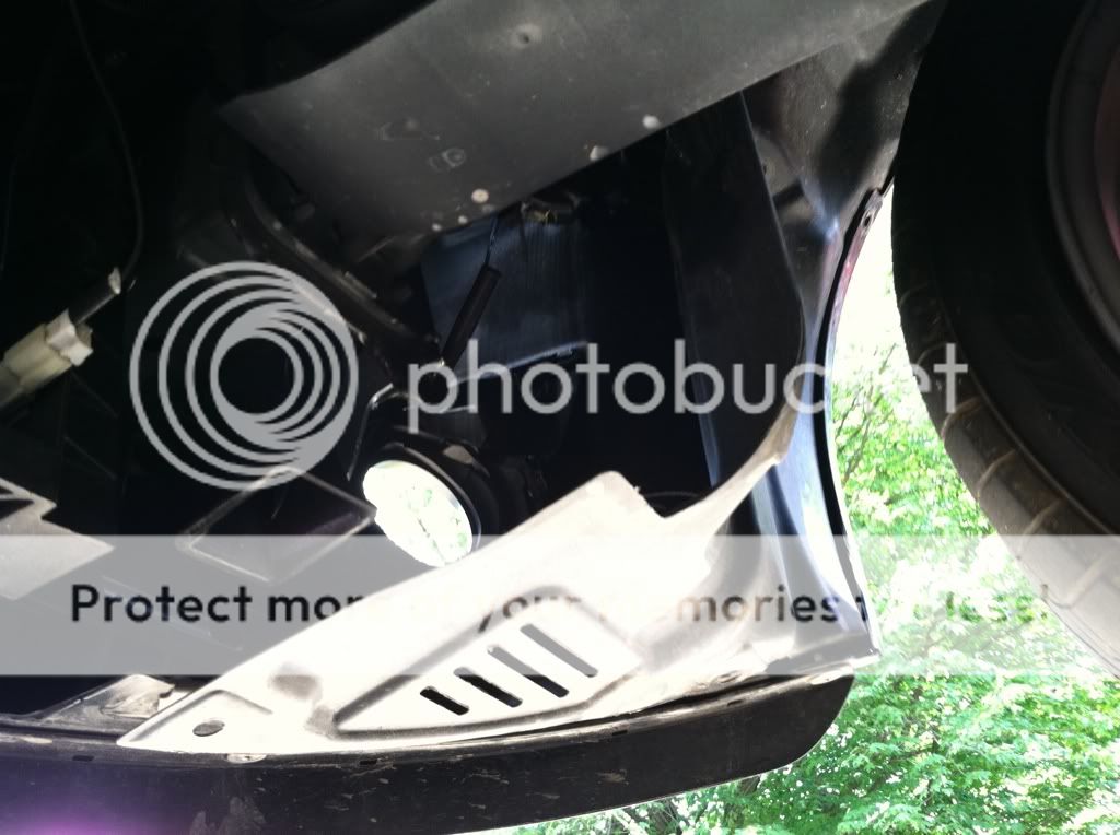

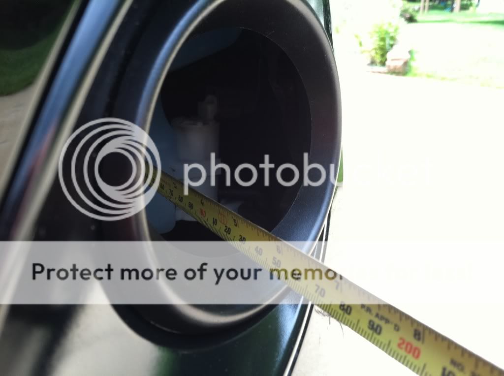

There's a ton of room where the fogs go. I'm planning on mounting some projectors in there. I have some old 3" E55 projectors which would be free since I had them (except buying bulbs/ballasts).
The driver side has less room than the passenger side because of the washer fluid bottle, FYI. I will try and measure today how much room there is from the front of the fog cover to the washer bottle.
Edit, pics:
The oem lens sits about .125" in from the surface of the bezel. You have just about 5.5" flush to the bezel from the washer fluid bottle, Which should be plenty to mount some Projectors :)
