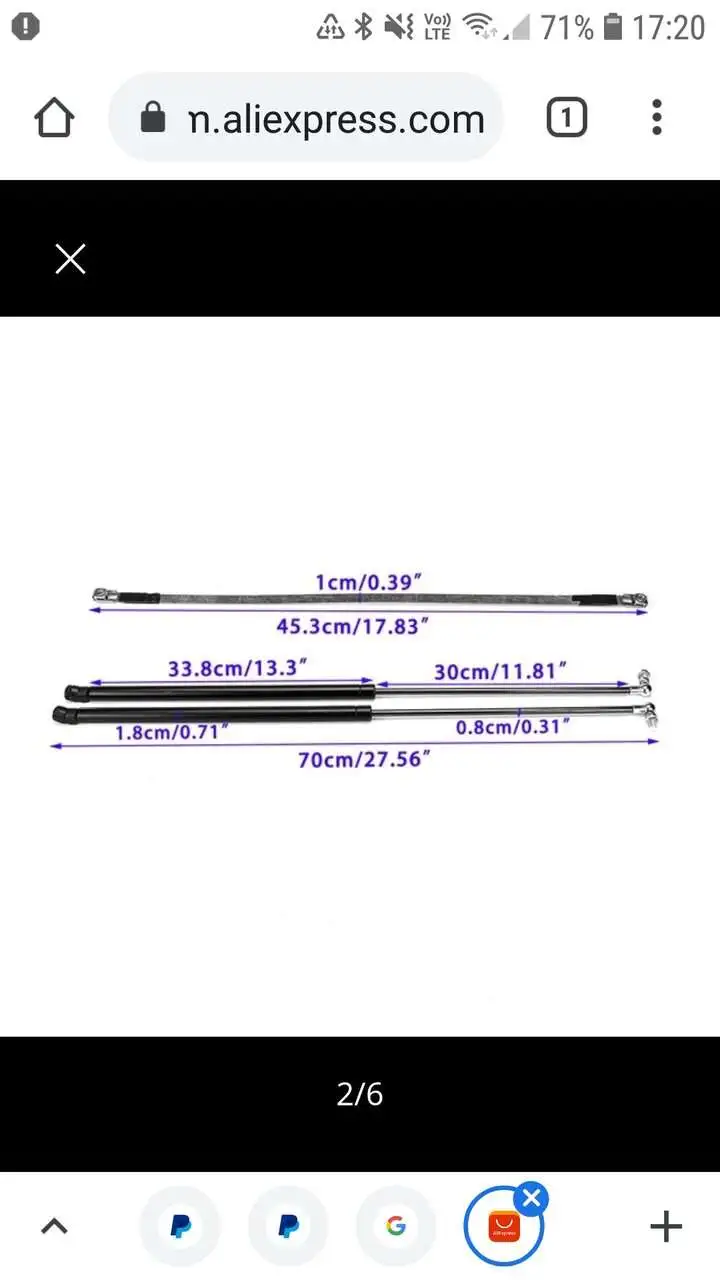

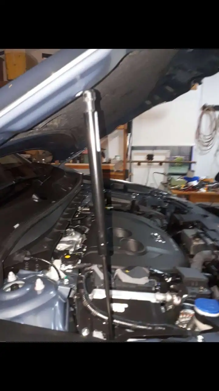

I have been researching this and even bought a pair from Mikstore.ph and they appear flimsy and short compared to boot dampers and a hood is so much heavier. Today I found some on Ali for 2018 model which look as though they are more appropriate. Does anyone have both 2018 or little earlier as welll as 2022 model to compare hood weight size mounting possibility.
