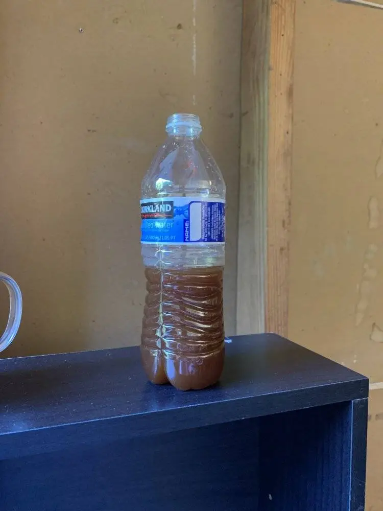

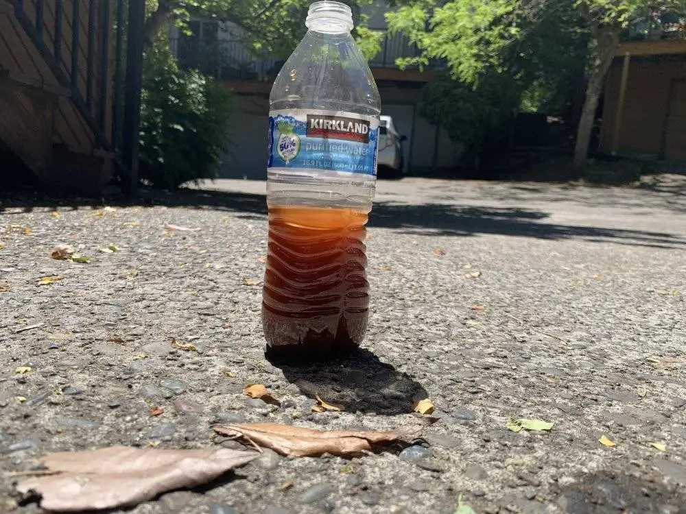

Anyone else do DIY oil changes at every 3-3.5 k mi? I do have a turbo, and installed a corksport oil catch can that i empty at each oil change session
Btw this is the gunk my OCC usu picks up (after around 3500 mi or a long road trip ie 750 mi)
Wow, that's a lot more than I'd expect in 3500 miles.
Are you adding oil between changes?
That's a lot of gunk . . . but I don't see any oil at all, do you?
I had an Ebay OCC installed on (now traded) Hyundai 2020 Tucson. After 1 yr/10,000 miles, it collected maybe 2 oz of water and an ounce of dark oil.
Just got a 2019 CX-5 Signature a month ago, had a fresh oil change done myself, going to install an oil catch can I removed from the old Tucson, let's see what I'll get.
If its only water in your self installed catch can, then that will burn/ evaporate away. I am sure Mazda knows how to deal with that. Also installing anything whilst under warranty still - be careful!
I asked the dealer if its ok to rust proof the car, he said if they drill holes in the car to inject, and there is rust around holes, it will void warranty if you raise rust issues! Any excuse dealer finds they will use against you. I think this catch can option is probably good for older cars. Your better off replacing the PCV valve regularly.
It looks like it is mostly water.
I dont think it looks mostly like water. Doesnt even smell like water lol i think the OCC catches residual vapors from the exhaust (ie residue from air/gas combustion) before it is reintroduced into the engine (ie blowby)
