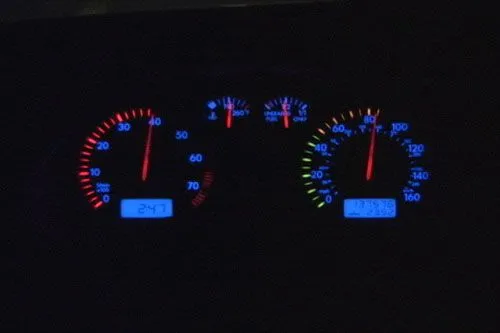

Yeah I'm bringing those old thread back to life too...is there a how-to on the LED installation? I want mine looking more like the Volkswagen display.

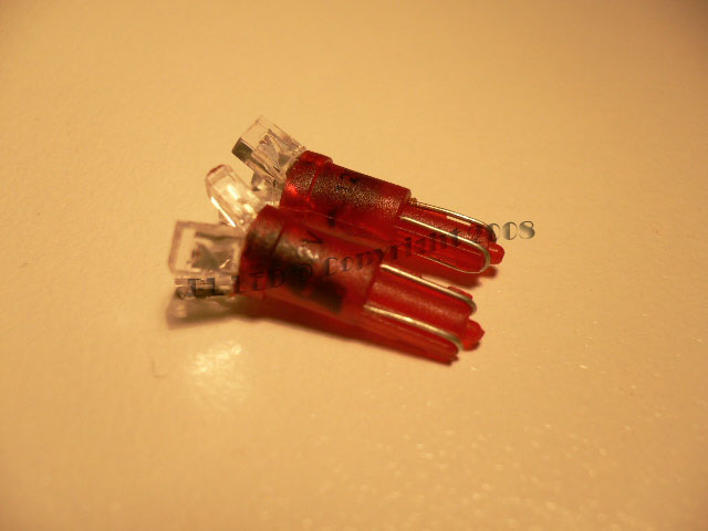

If you get 194 and 74 LEDs they just plug in like the stock bulbs. Some LEDs do not dim with the dimmer switch like regular bulbs do, and some LEDs can.
I don't really care about the dimming ability, are these LEDs brighter than the incandescent bulbs? I just want my gauges to be bolder like the Volkswagen set up.

If you get LEDs with multiple lights on the end that shine in all directions they should light up brighter than regular bulbs, especially if the bulbs are old. Some cheap LEDs only shine light forward and that creates uneven light in spots and looks strange.
