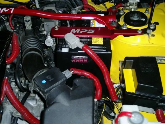

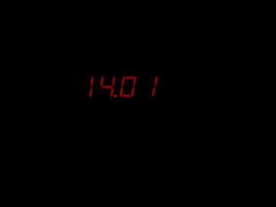

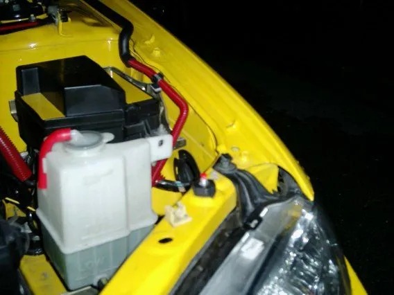

DVM installed!
here are some pics of the installed display. all were taken at night and because of the flash, you can't see that the display is on - but it is. i also installed a switch which turns of the display when the hood is done to conserve on battery power and prolong diplay life.
Thanks Rick (redwagon02) for ******* around...uh, i mean helping me out. I wouldn't have done it with out you.
