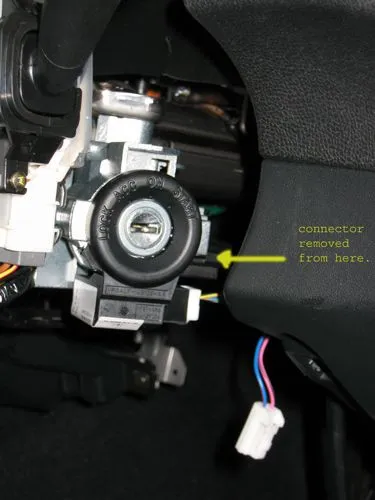

Did you know that disconnecting this connector (with the blue and pink wires) from the ignition switch will kill the key reminder/ door open chime and allow you to enjoy the stereo (chime free!) with the doors open?
Gomez has attached this image:
almost every mazda car is like this.
