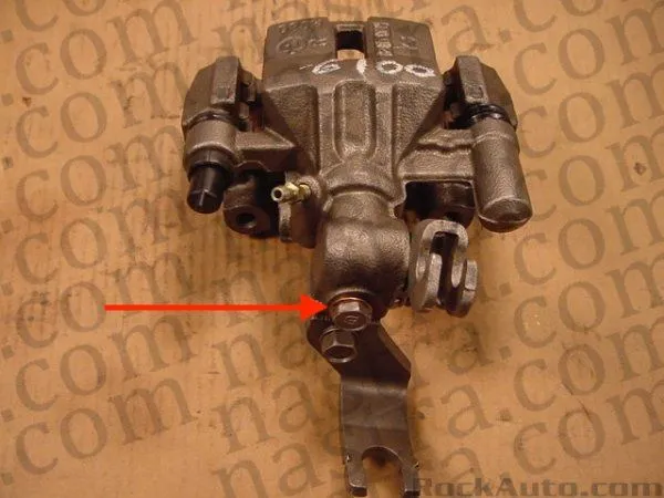

There is a bolt on the backs of the calipers. IIRC, it has a copper gasket on it.
You remove that, and inside the hole is the adjuster, you a hex/allen wrench to tighten down the piston, it helps if you have some one spin the tire while tightening.
When the tire stops spinning, and cannot be moved by hand, back off maybe a 1/4 turn.
Then adjust your parking brake.
Don't forget to put the bolt back in.

I am not anywhere near my P5 right now, but I will try to find a picture for you.
I put a red arrow pointing to the bolt with the copper gasket that you need to remove to get to the adjuster.
The adjuster is loose inside, and it might come out with your hex/Allen wrench. I think it is clockwise to push in the piston, and counter-clockwise to release it. But, I am not 100% sure.

As for the OP,.. If you've got your rear pads and rotors installed with the P-brake hooked up, you can just get in your car push the brake pedal hard, then pull the P-brake handle about 30-50 times.
This operates the self adjusters to set the rear calipers.
If you don't have your rear brakes installed or fully connected, you'll need to back off the calipers to make room for the thicker new pads.
You can also rotate your brake piston to turn it in but you could rip your boot if it's stuck to the piston and it's best to use the adjuster screws.
