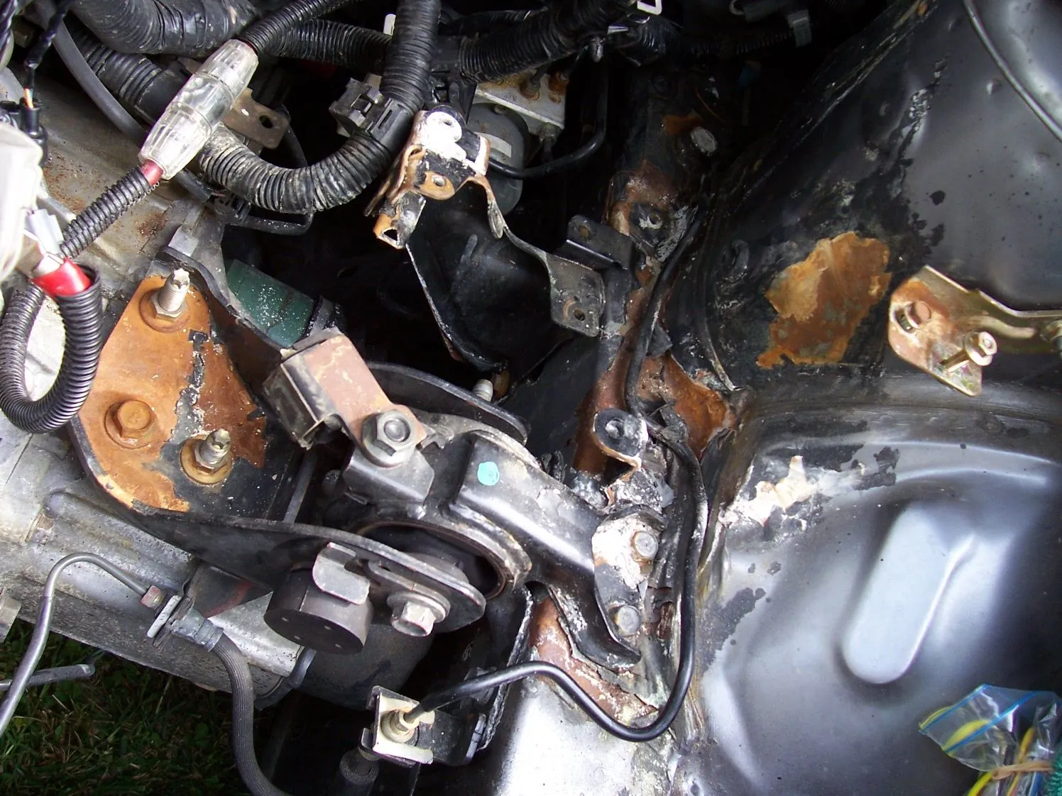

did a lot of work over the weekend heres pics
benflagg
03 ms protege, 91 mr2
old battery blew up and corroded the s*** out of the engine bay, so I stripped it down and treated it, then painted it.

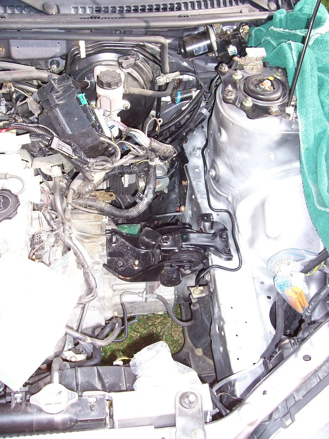

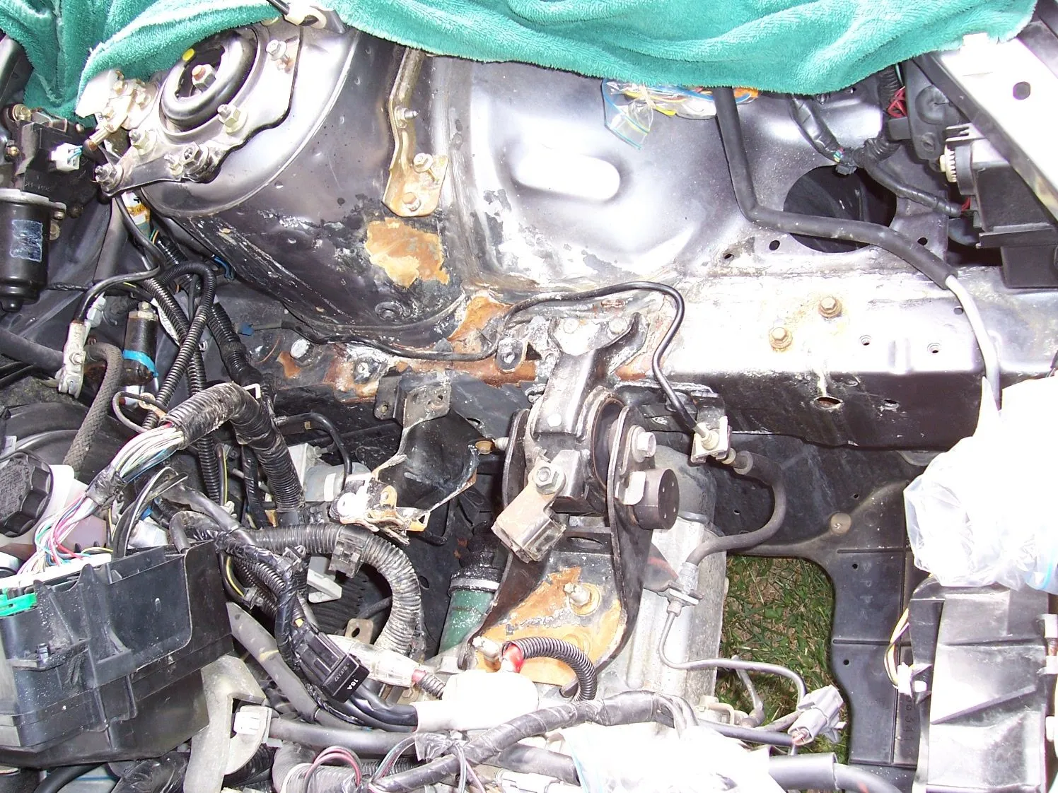

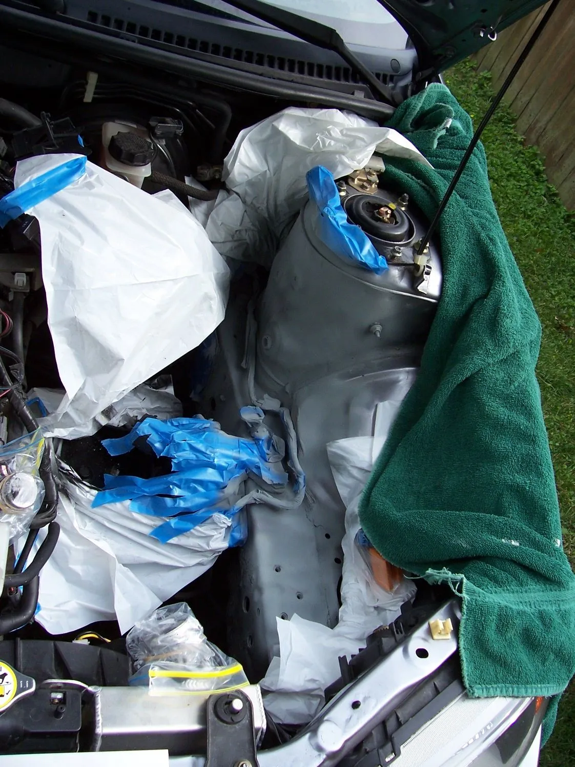

looks pretty good. can hardly tell that anything ever happened. Did you use heat resistiant paint or is it just some regular body paint?
its reg paint , I figured thats what was on there before, the primer was a high heat mix though
