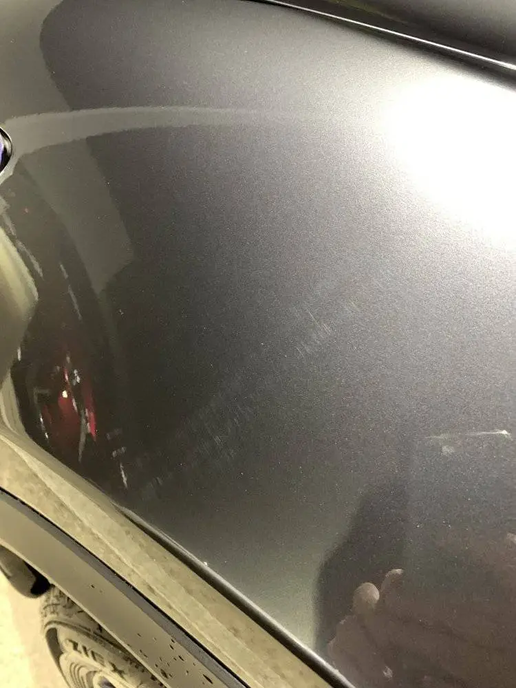

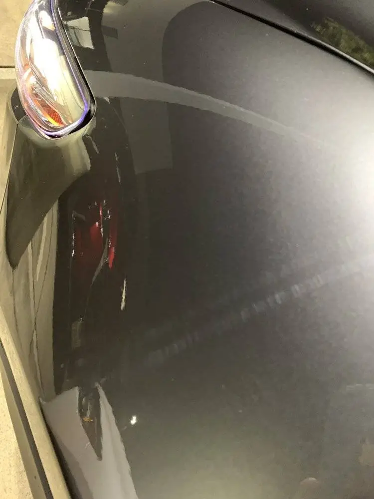

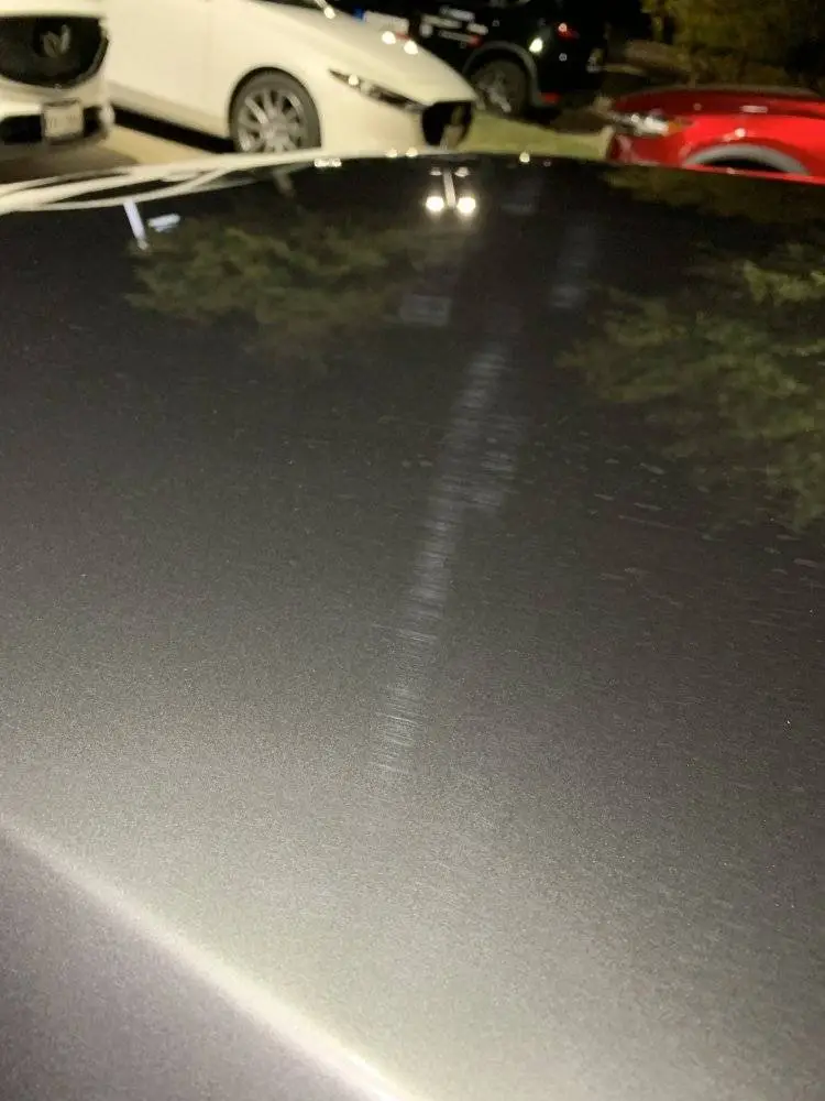

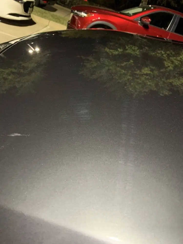

Here are some photos I took in the parking lot the night it happened. To me the swirl marks jump out and slap you in the face. To someone that doesn’t either know what they are looking for or aren’t very particular about swirl marks they may not be that easy to see.
My car had zero swirl marks before this

^^ clear as day. You've got the swirl haze from uneven clear coat which is high edges cut into the clear from sand/grit that reflect back from the sunlight. It needs a mild cutting polish to knock down the high edges and smooth it out. A couple hours required and will be corrected.
wow, it looks like they used sandpaper. what's weird is how uniform the marks are. that doesn't look like it's from hand drying. are they really in two strips like they seem?
