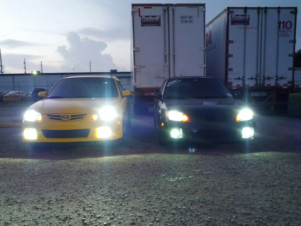

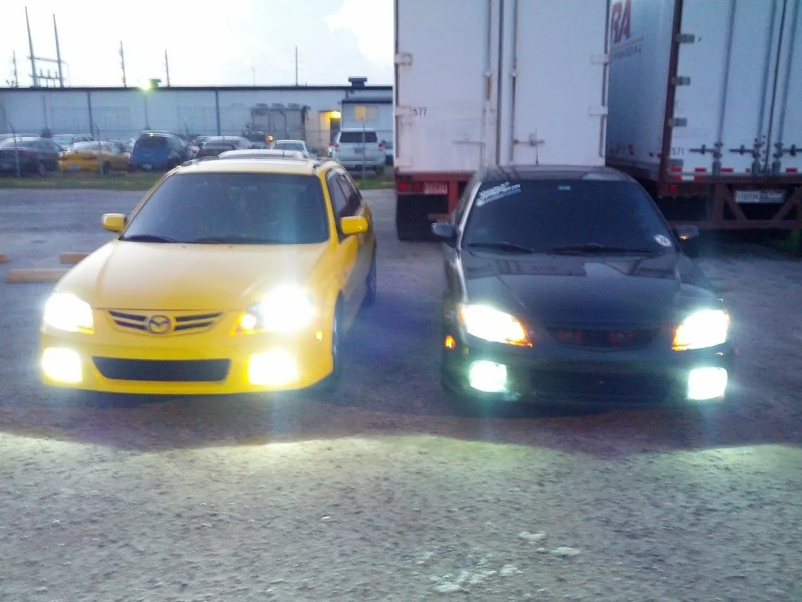

In case anyone is curious. Yellow P5 is DDM Raptor Slim 55w, @ 6000K low/fogs. The black P5 is no name brand 35w low/fog @ 8000K
