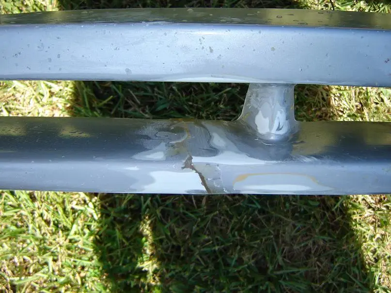

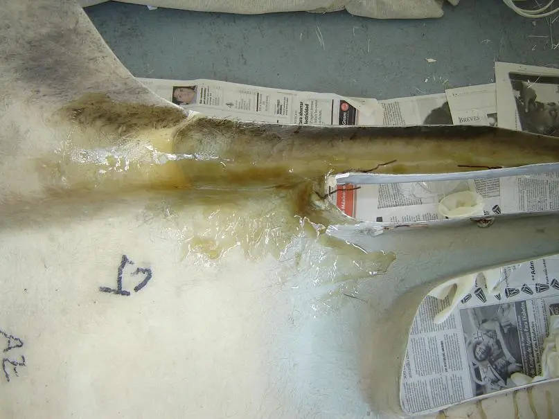

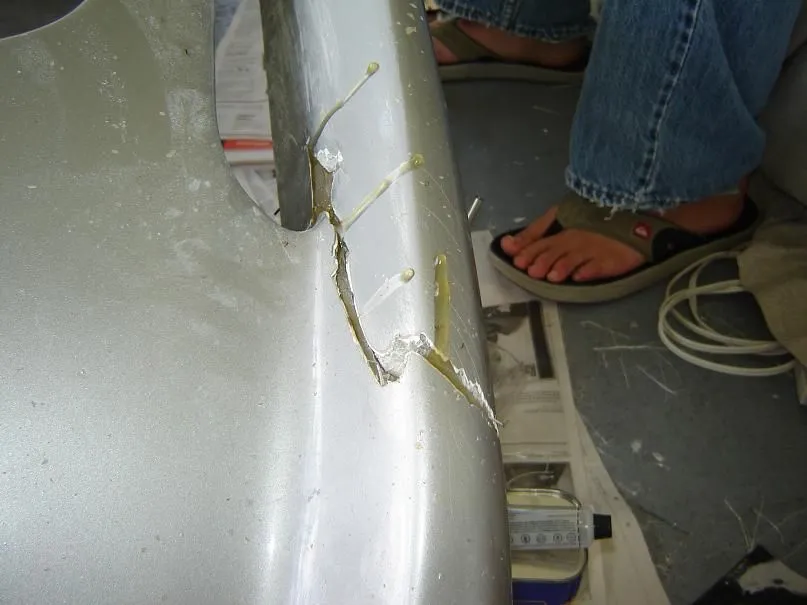

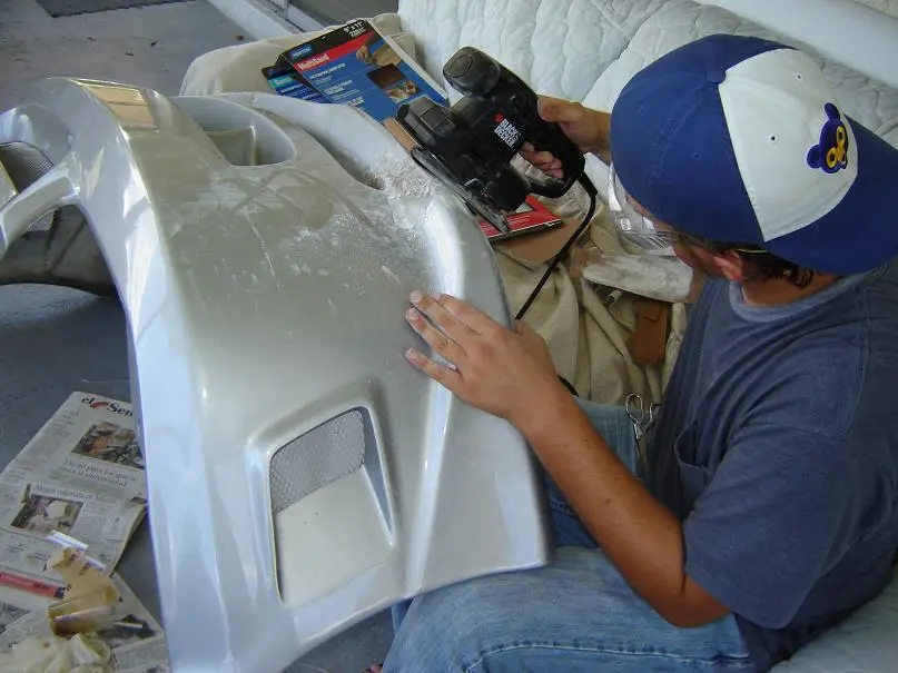

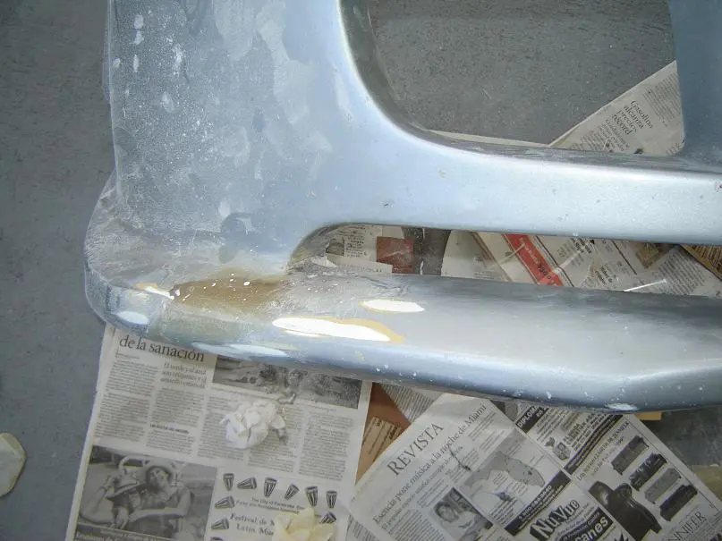

Finished Fixing The Bumper
(band2) hell yeas! finished and I gotta say it looks great! it took us about 3 1/2 hours. it wasn't bad at all. all that is left is to paint it.
Here are the Pics

Did you add any fiberglass matte to the back? Everything I've ever read on repairing fiberglass in kitcar mags and books says that just glueing it back together won't hold up, you have to add some reinforcement. The epoxy or vinlyester resin is too brittle on it's own.
reinforcement is would be angle hair fiberglass matt, u are supposed to cut away the frayed cracked part and resin, and fiberglass mat the cracked area, looks like you did a good job though maz pro, should hold up
