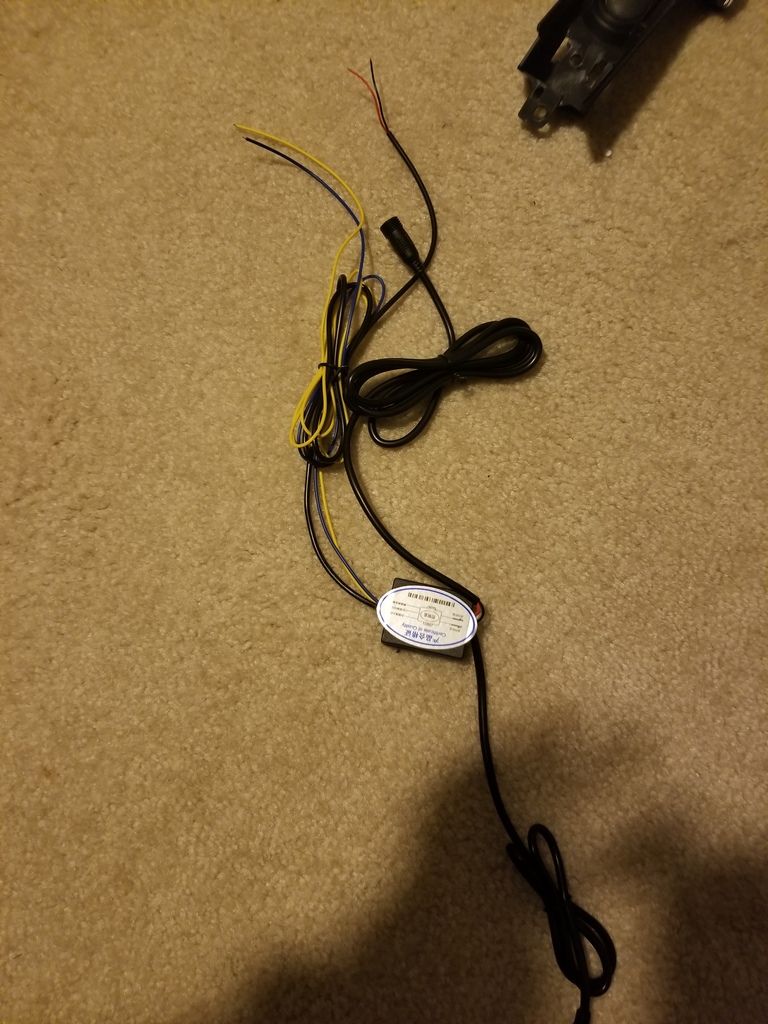

Hey CharlestonMX5 and anyone who might know,
I have a question about the wiring (I received the kit from https://www.ebay.com/itm/DRL-For-Ma...ing-Light-Fog-Light-Bezel-W-Turn/264050349187 )
I have 4 wires- Red, black, blue, and yellow
I plan on using a fuse for the red and the ground box on frame for black like CharlestonMX5 (btw thanks for the great pictures)
I want to double check, where do you tap the yellow and blue wire to? L & R turn signals (Red/white wire)? Is yellow for the left turn signal and vice versa? wish I knew mandarin (doh)

Look at the second picture (post #50) and read the instructions above the picture. Remove the turn signal bulb from the housing and take the wiring out of the little plastic wire holder (blue box). The turn signal wires tap into the red/white wires. That's the same seller I bought mine from, they must have changed wire colors. The longer wire is for the passenger side turn signal. I wired mine outside the vehicle to make sure everything worked before doing the final install. I'm considering moving my red wire to the fuse box, because they only come on when my foglights are on now.
Thank you CharlestonMX5 for the fast reply! Your pictures gave me the courage to push along with this project. I didn't see a mention of the aftermarket wire color so I was thrown off. I stretched it out and the yellow is the longer of the wires, thus it's the one for the (U.S.) passenger side (But knowing life, if its's too good to be true, you better check (spin). I'll try to get a few pics for everyone once I wrap up.
I'm thinking of using the marker light fuse via a fuse tap.
I also noted they slimmed up the control box.
Mine had yellow and yellow/white wires for the turn signal wires. I looked inside the control box when I first got it to make sure everything was sealed, there wasn't much in there and was probably just a circuit board but was completely sealed and very small, they could very easily put in a smaller box half the size of the original. I just took a test light, removed the bulb, and checked the connectors in the bulb socket the touched the wire to that lead. Also you will notice one of the DRL wires is longer than the other.
