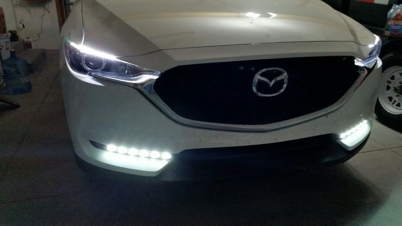

CX5 - LED fog light + turn signal
Wow, those look cool!
I like the way they are white LED when driving and then turn amber when turning. Is there a way if you can find out WHERE he bought them?

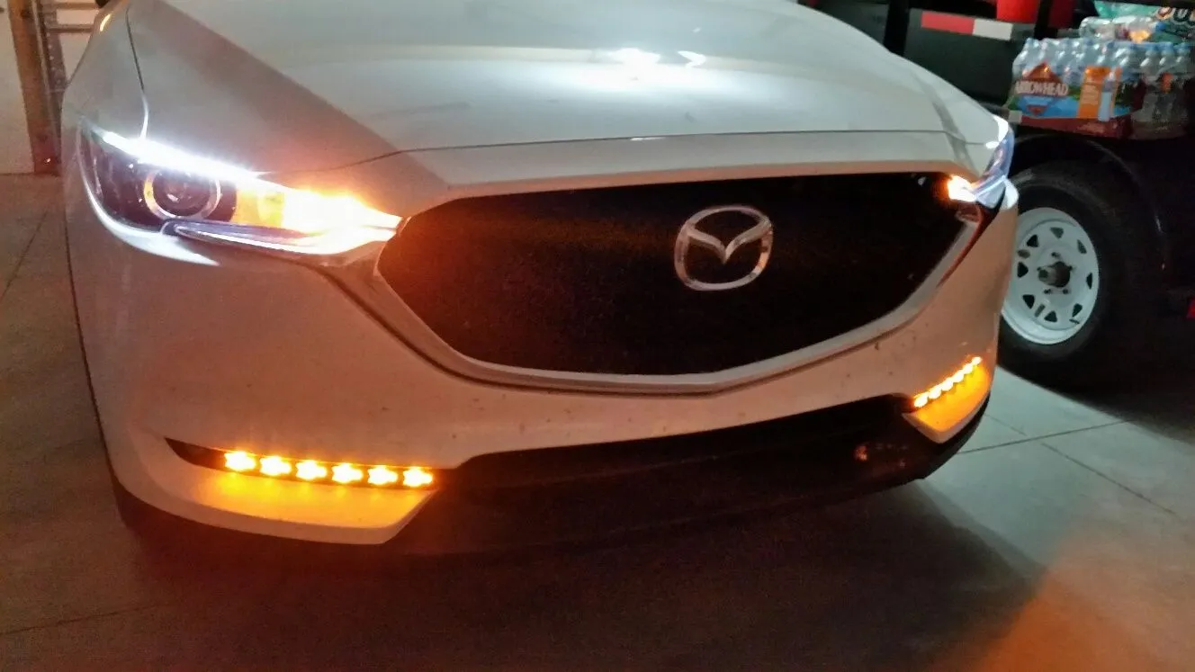

What's nice is that they are white LED DRLs and then become amber turn signals when activated.

I ended up with these lights. So far so good after almost 1 year. They are white when driving and then they flash in unison with the turn signals and turn amber.
One thing to remember is that these are NOT headlights, more of a daytime driving light, which is different than headlights. 99% of LEO would have no idea about the lights and violations
