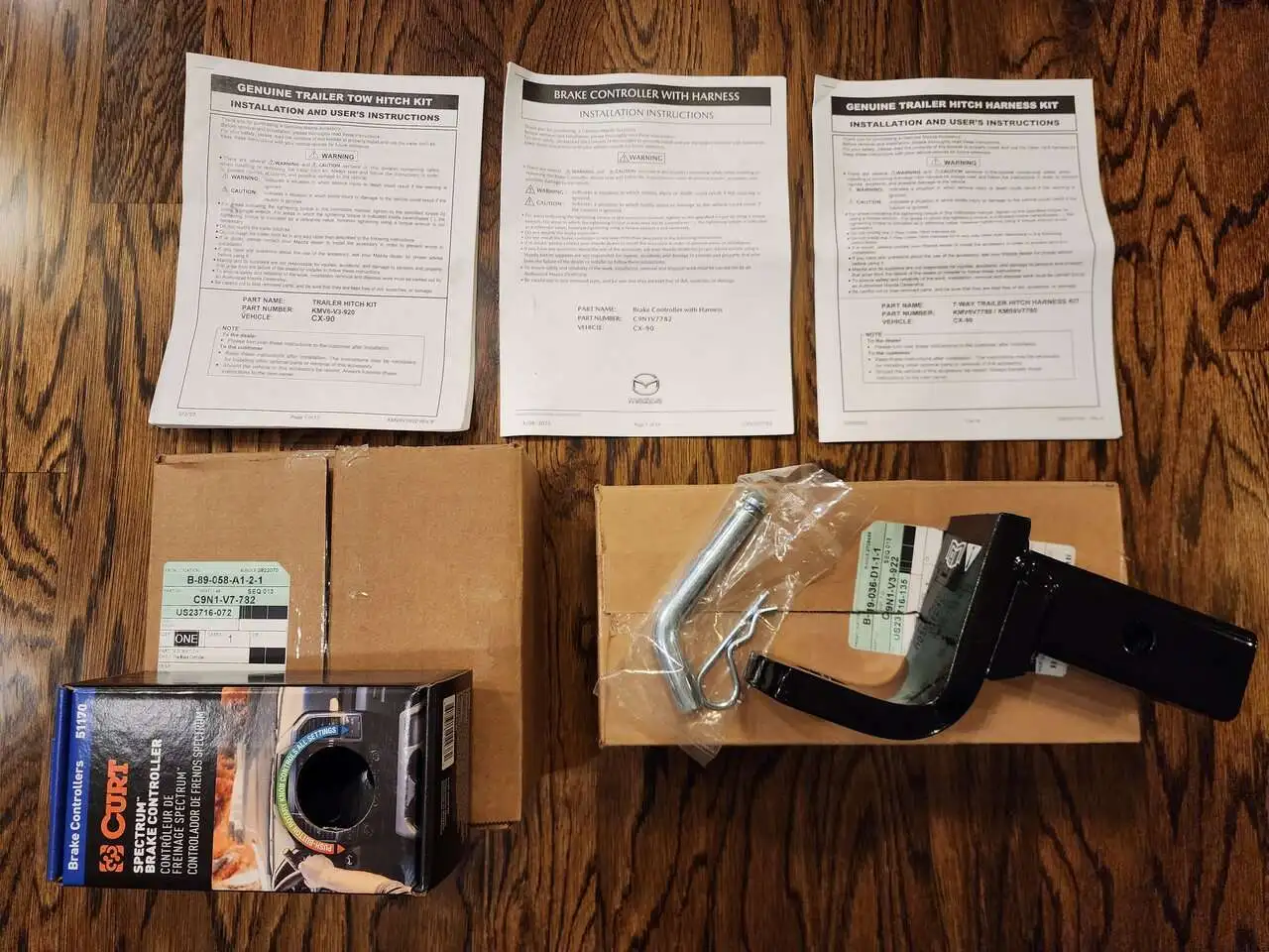

I finally got my “Premier Tow Package” installed by the dealer yesterday. Bought my CX-90 at the end of April and made the deal with the dealer to have them include and install the “Premier Tow Package” even though it was not yet available for them to find in their parts system at that time. Their Parts guy had to call Mazda help desk a month later just to find out what is supposed to be in the “Premier Tow Package”, and we had to wait another 2 more months after that to get the brake controller to come in.
The parts list:
KMV6-V3-920 Trailer Hitch Kit
KMV6-V7-780 7-Way Trailer Hitch Harness Kit
C9N1-V7-782 Brake Controller With Harness (Curt Spectrum Brake Controller)
C9N1-V3-922 Hitch Ball Mount (It’s about a 4 inch drop/3 inch rise)

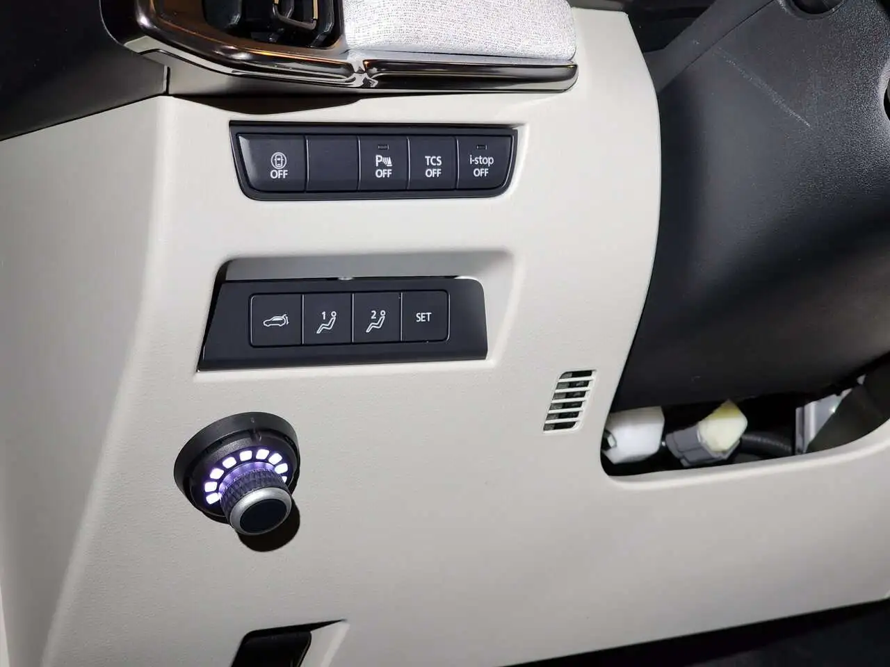

Installed location of the brake controller

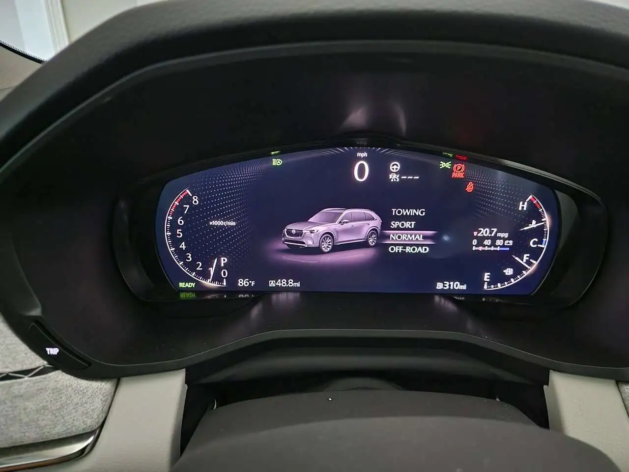

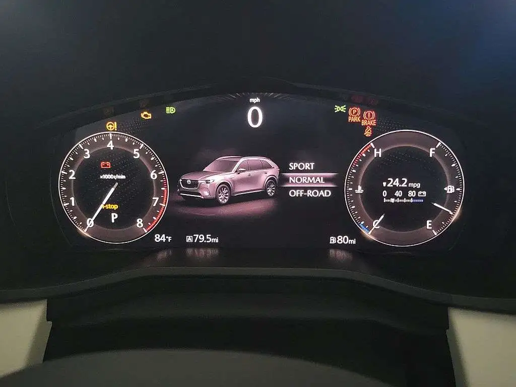

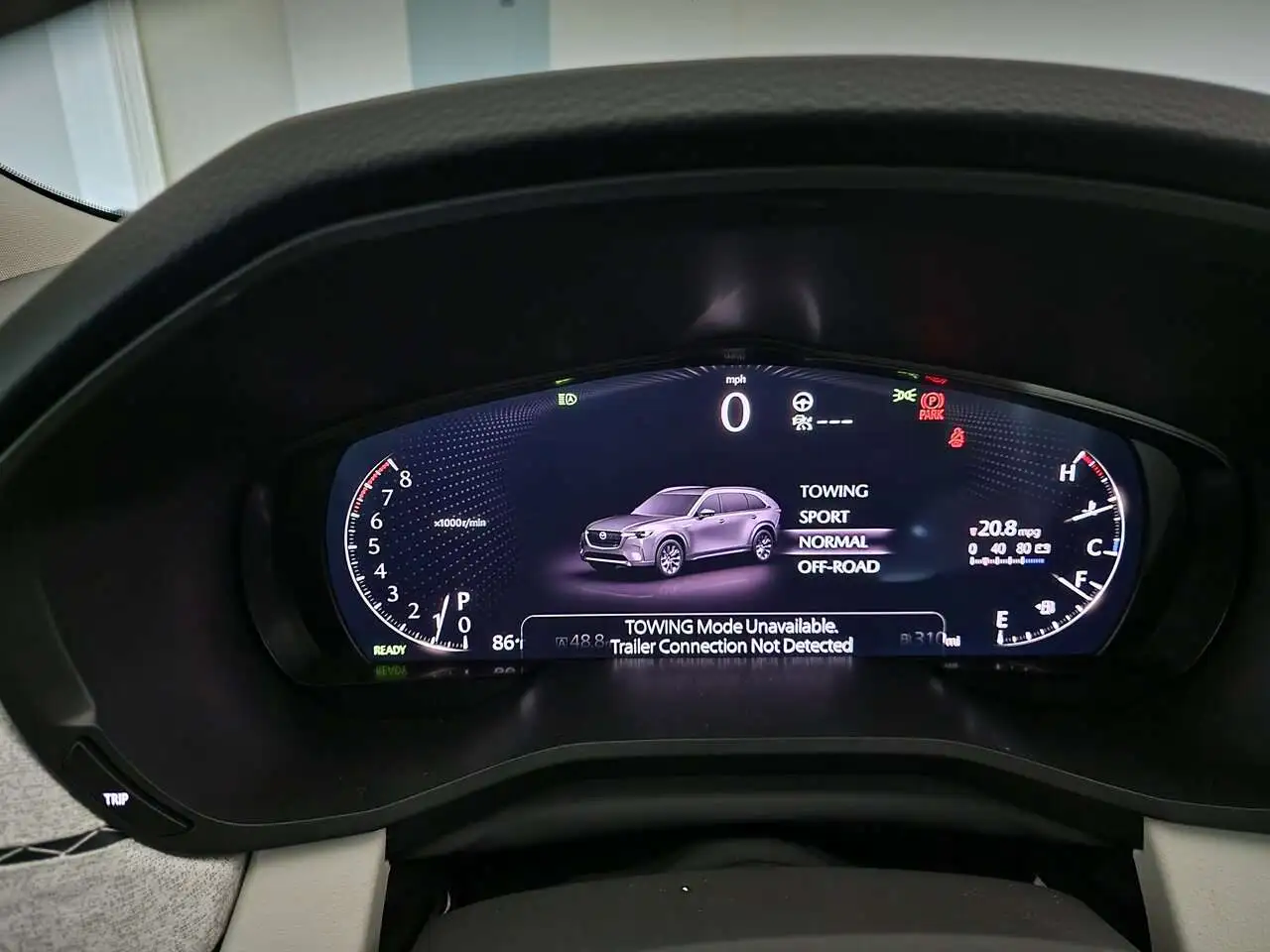

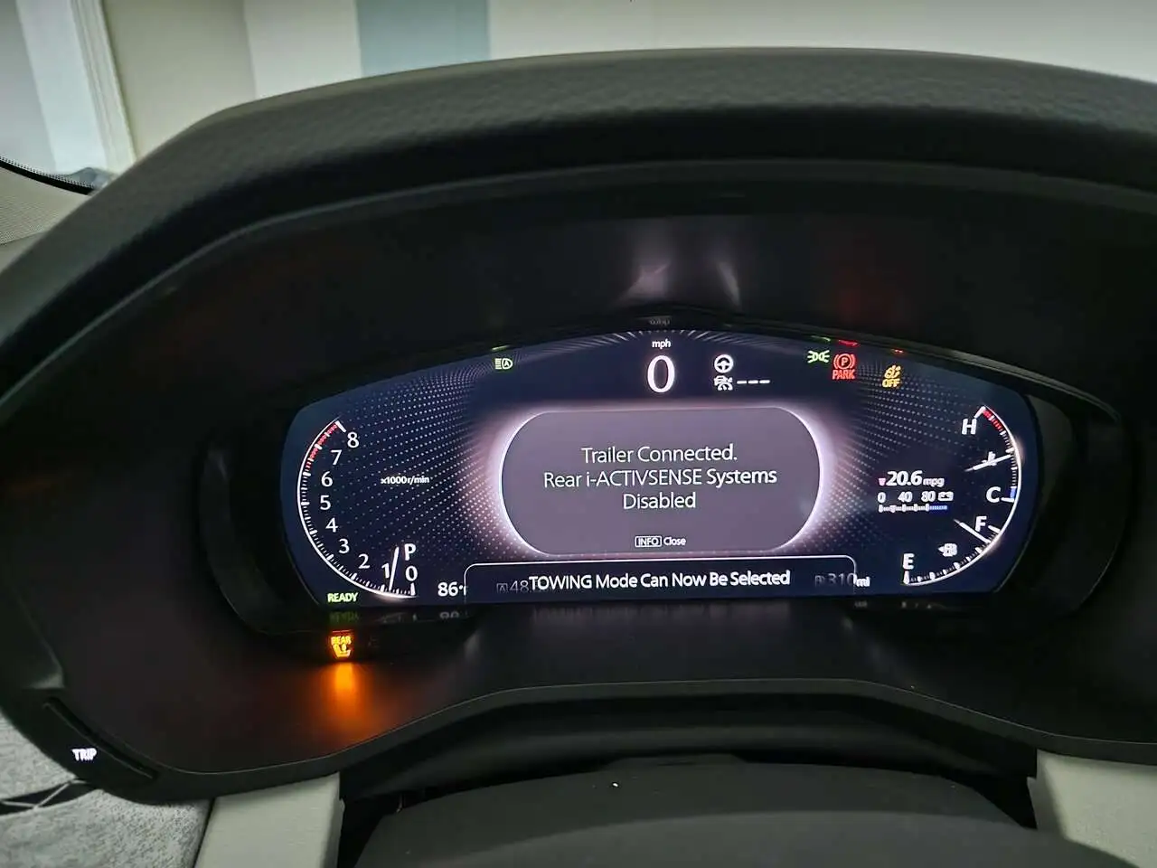

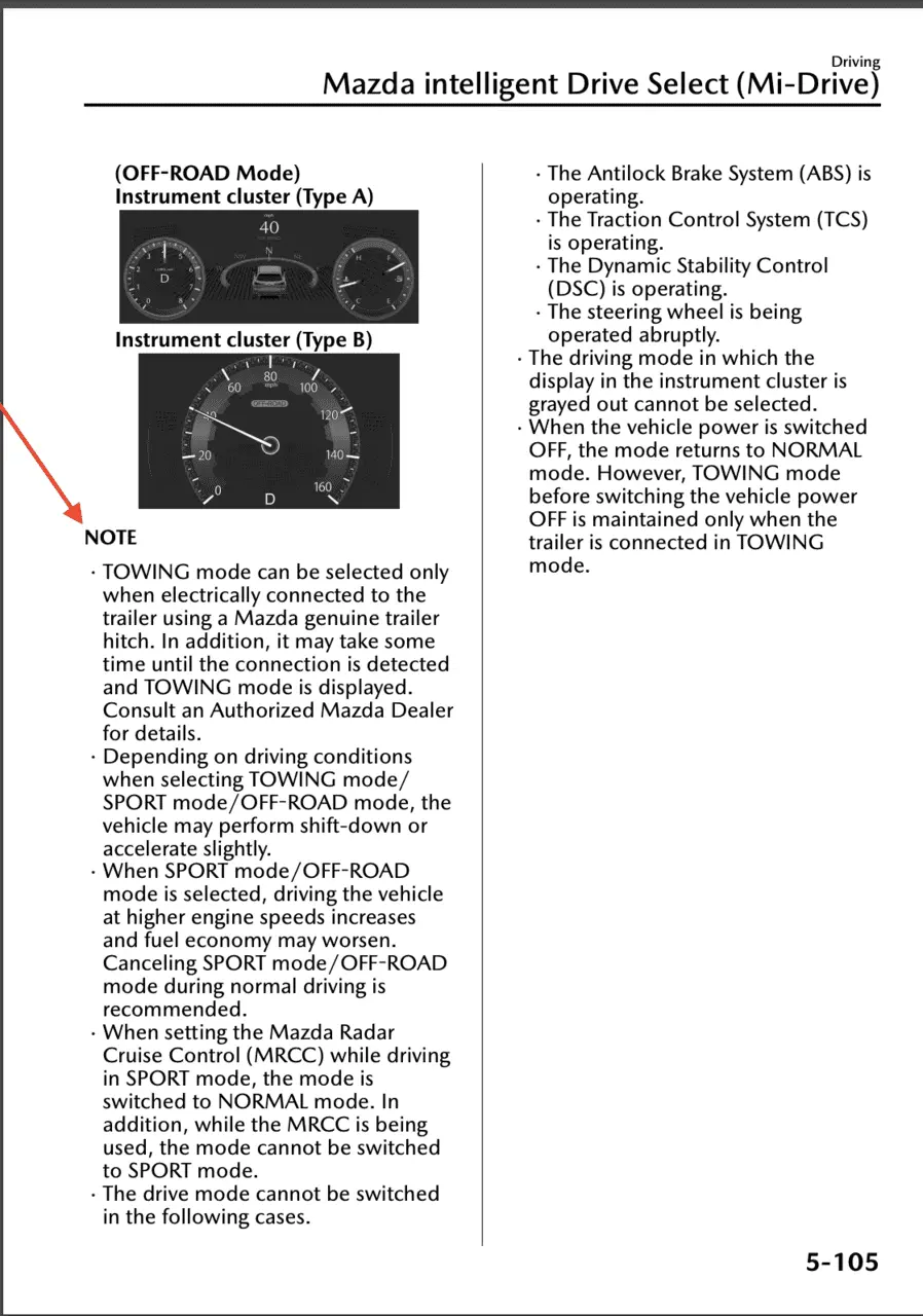

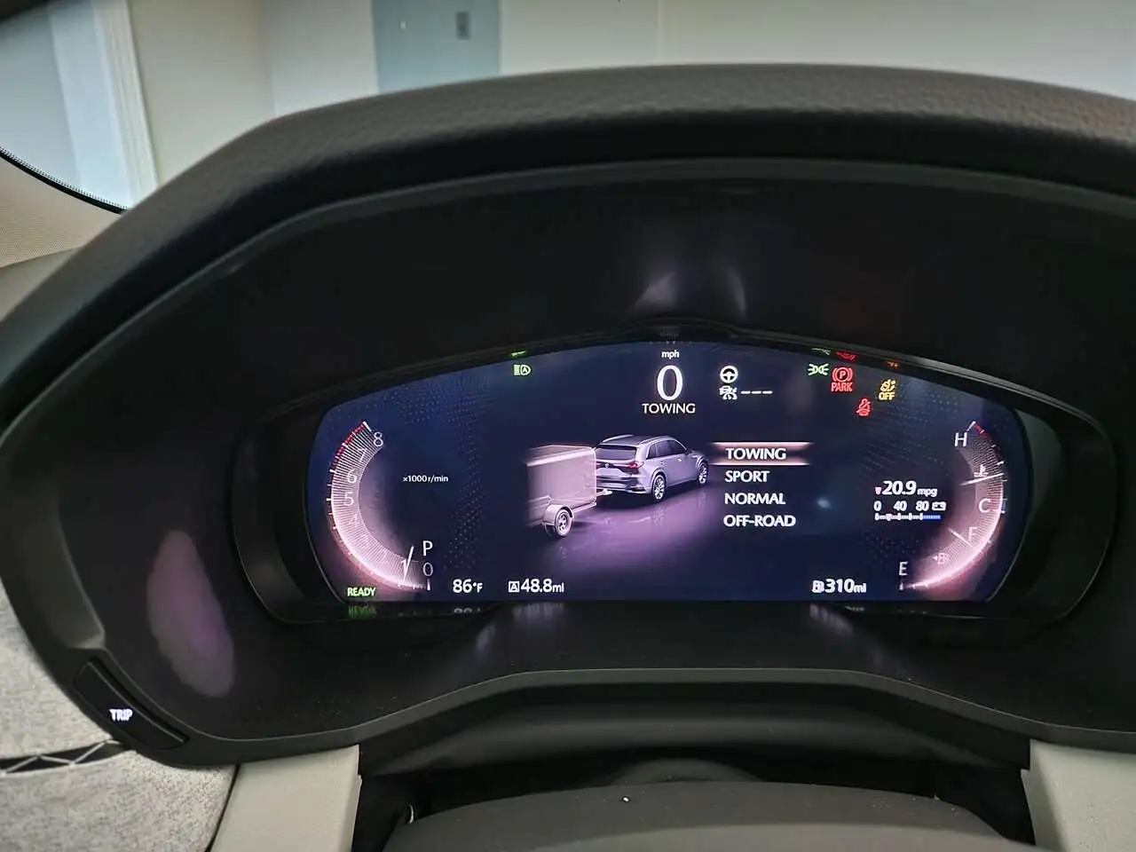

After installing them, do you see "TOWING Mode" showing up in Mi-Drive?
My car doesn't have TOWING mode displayed now. Does it show up once towing equipment is installed to the car?
Towing mode only shows up if you have the KMV6-V7-780 7-Way Trailer Hitch Harness Kit installed.
Most people only need that and the KMV6-V3-920 Trailer Hitch Kit to be able to start towing.
The brake controller in the Premier Tow Package is not necessary, unless you plan to tow heavier trailers that have electric brakes on them.
