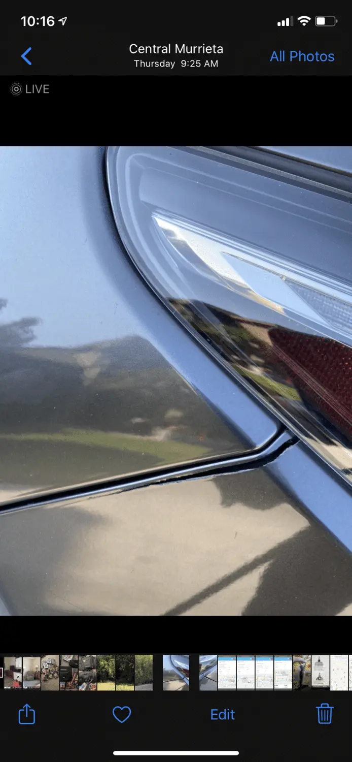

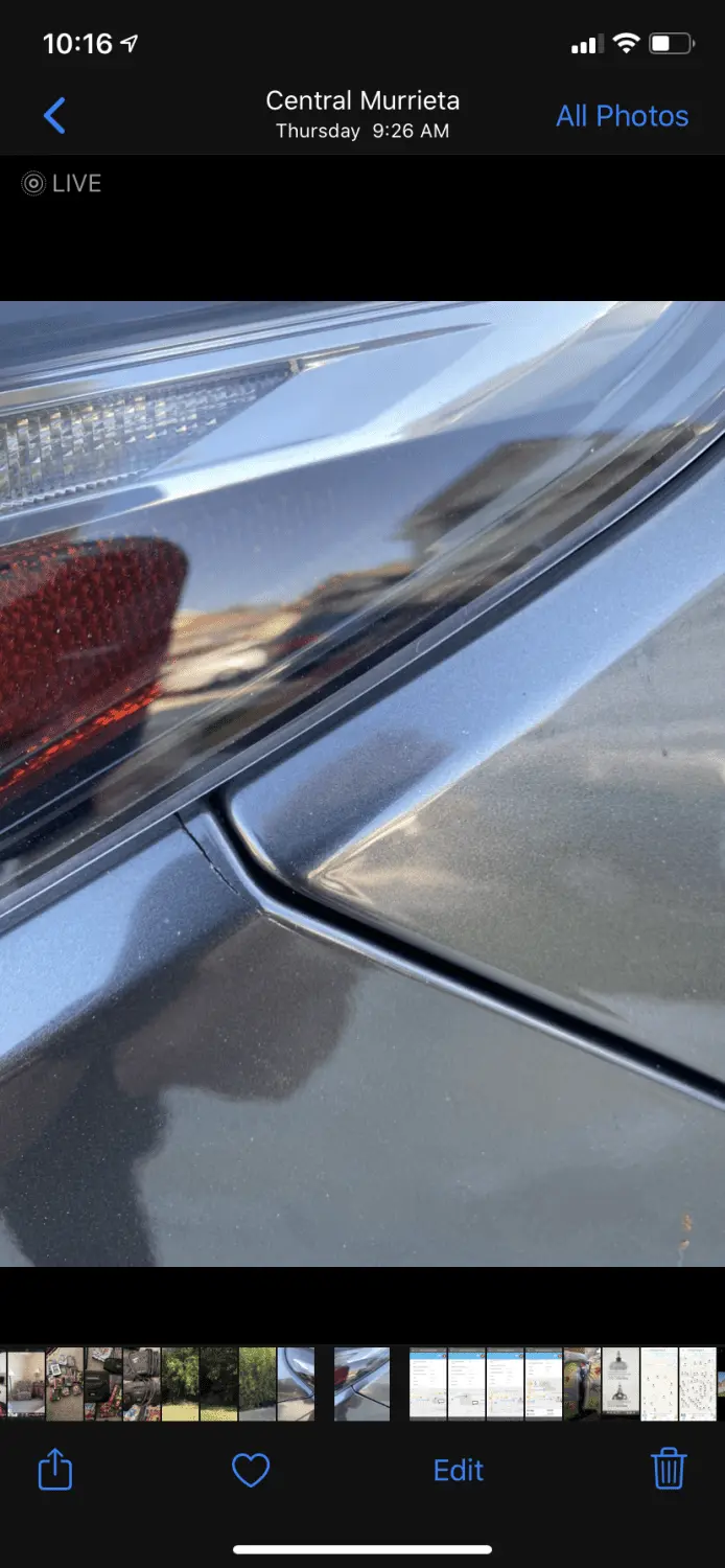

Just curious...is there is anyone else out there experiencing stress fractures in the body of the car. We first noticed one on the left side...next to the joint...next to the front headlight. Now...we have one starting on the right side in the exact same spot. We r the only owner...and have had no impact...as inferred by the dealership.

There is another thread on this forum entitled "disappointed with the CPO warranty" or something similar. There is a TSB referenced in there that covers this exact problem. Your photo looks like it was copied out of the TSB document (it's on the internet). You have a textbook case, I'd say.
Thank you SO much, i will look for that thread.
See link. This is what I had on my 2017 CX-9. Luckily, after some major headaches, it was all fixed under the CPO warranty.
