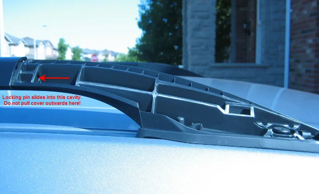

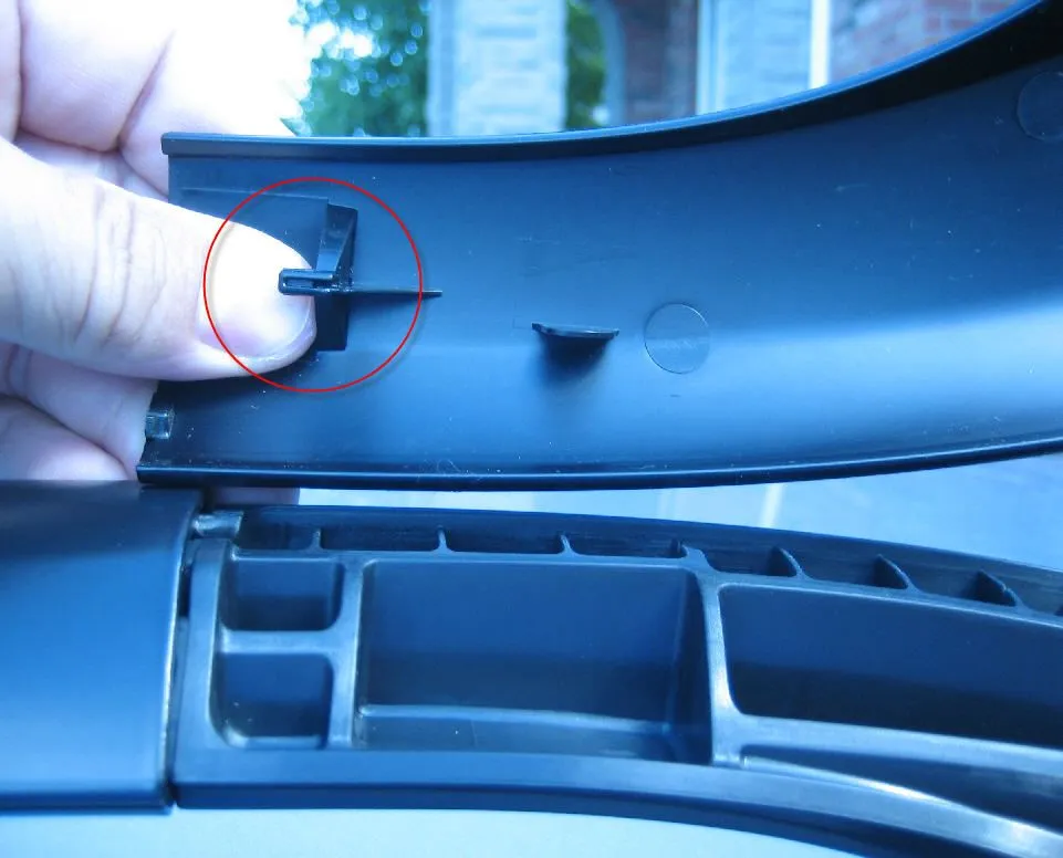

Before you get the plastic clips... Here are two pictures of the installation. Be careful with the removal of the front cover, there is a locking pin that can break off (circled with red) from the front cover. This is not shown in the Installation Instructions!
Good luck,
George
