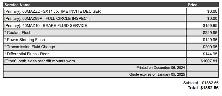

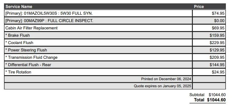

To sm1ke,Sorry for your car...now we are having doubt with our cx9,just purchased it used for 4.8k$ 2010 @ 142k miles,got hurt already with a rear shock and 2 tires replacement due to "tire cupping"...
just went for an oil change with dealership last week...and all fluids was flag to be replaced (Excluding transfer case)...pls see how much they charge here in ILLINOIS...i tried DIY already for coolant,power steering and differential.i have not seen any metallic aluminum in the magnet,hoping all are ok,and went back to the dealer for brake flushing and i requested transfer case fluid to be replaced as well,surprisingl they declined and stated not serviceable...i have seen you tube with this and will attempt this weekend...now they flag the front differential bushings for 1k$ :-( ...
overall the car is running smooth,engine is really quiet ,response is also good...we initially plan to just trade it in however value is not really good...so we decided just to keep and expect for the worse...
overall car is running ok ,smooth ride and quiet engine...there are just many ticking time bomb such as differential,transfer case and water pump...which all are huge bills...first mazda also and may be the last....
posted some items in this forums but very hard to get response...
Honestly I would recommend getting a second opinion from a reputable independent shop to make sure the rear diff mounts need to be changed. Some dealerships are not as honest as they should be, and will quote repairs and services that may not be needed just to get more money from you.
