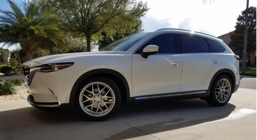

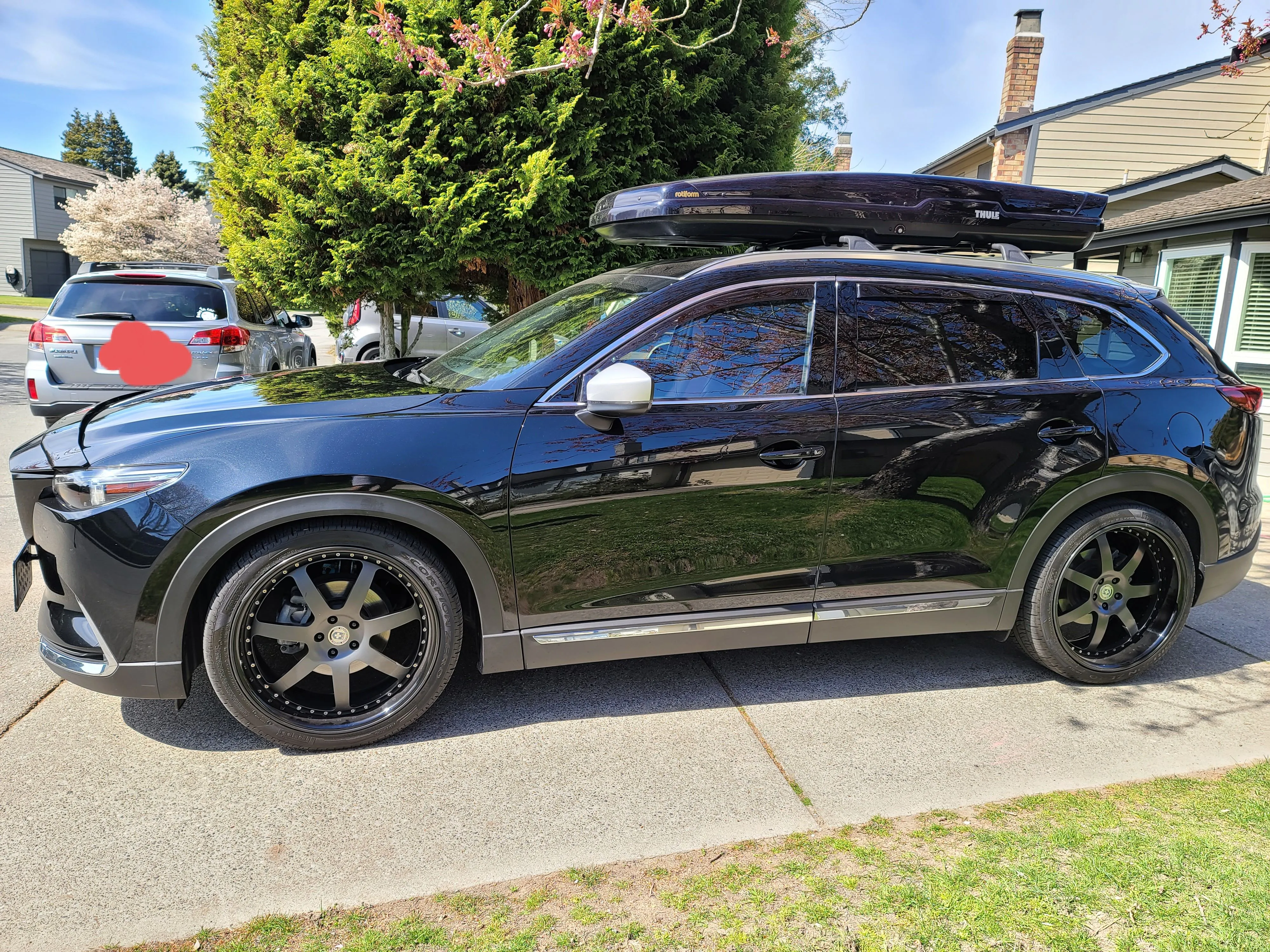

The Ceika Coilover 1M’s are installed in the 2017 GT CX9 with Avant Garde 610 wheels and Michelin 255/45/R20 10” AS/3 look great, ride nice and handle much better.

Nice, thanks for the feedback! These are on my shortlist for sure.
Interested to know if you’ll eventually have some axle issues. I’ve had extremely shortened life span of axles in every lowered car I’ve owned. I want to lower my 2019 but worried about those future axle issues.

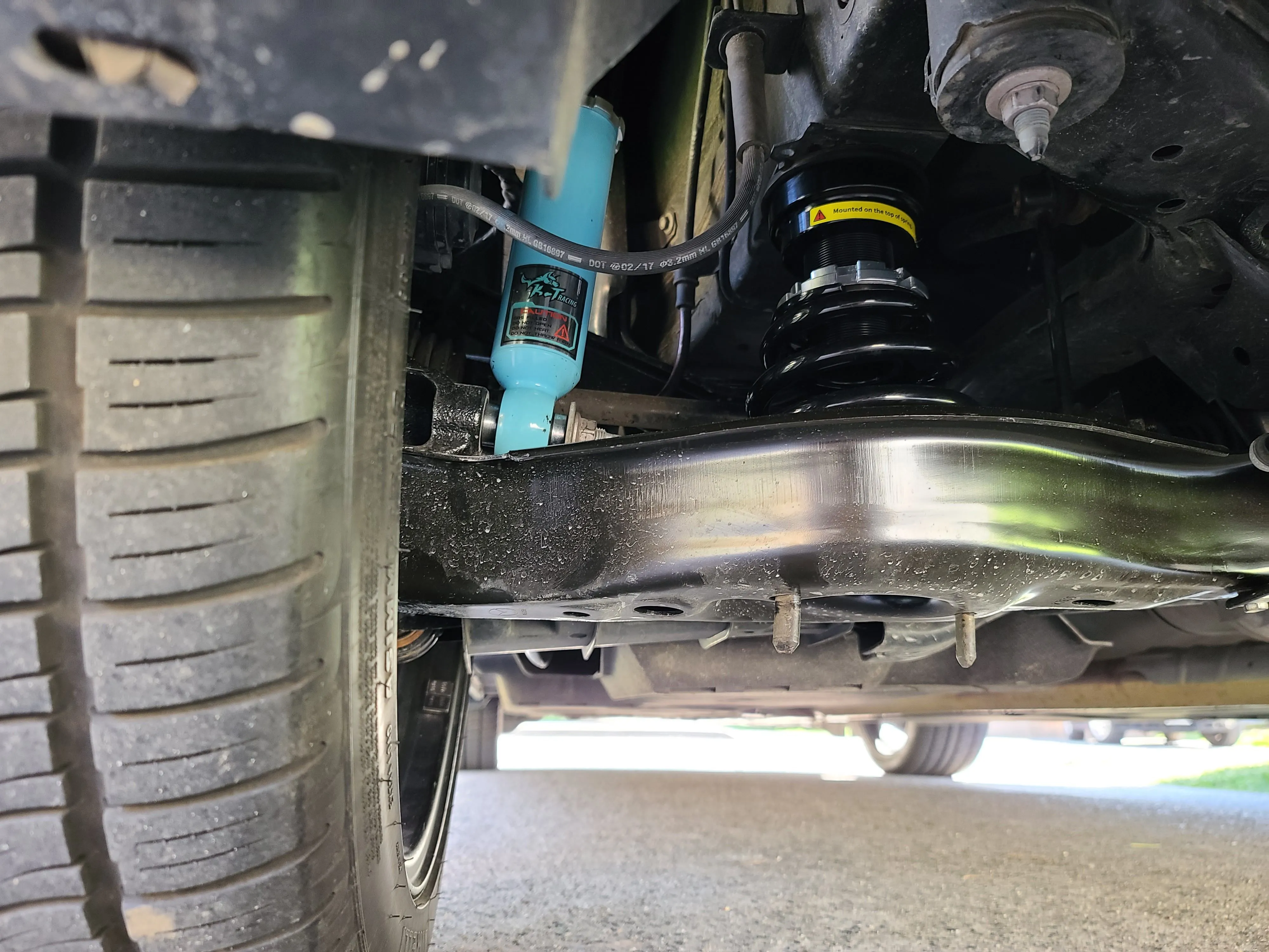

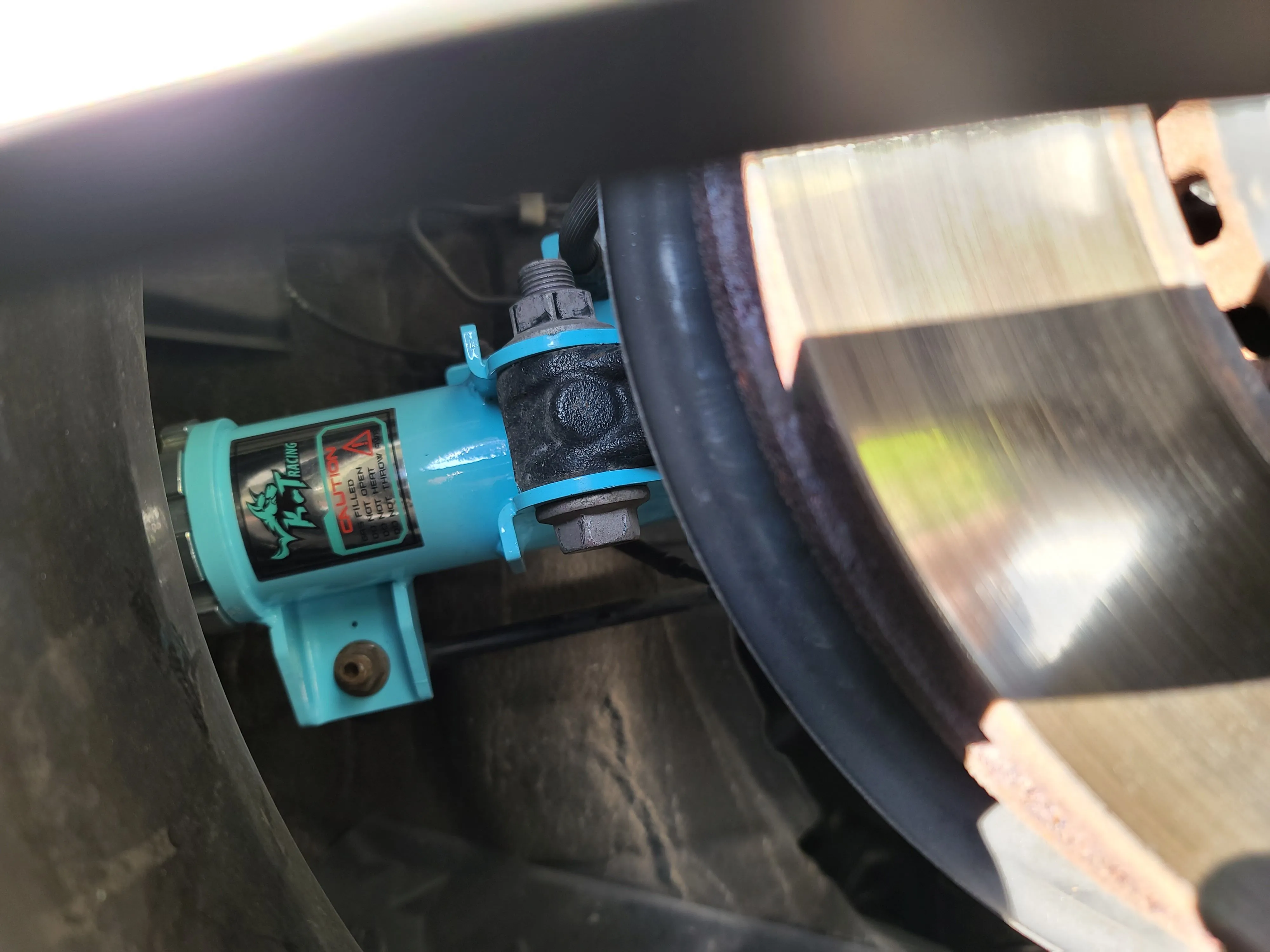

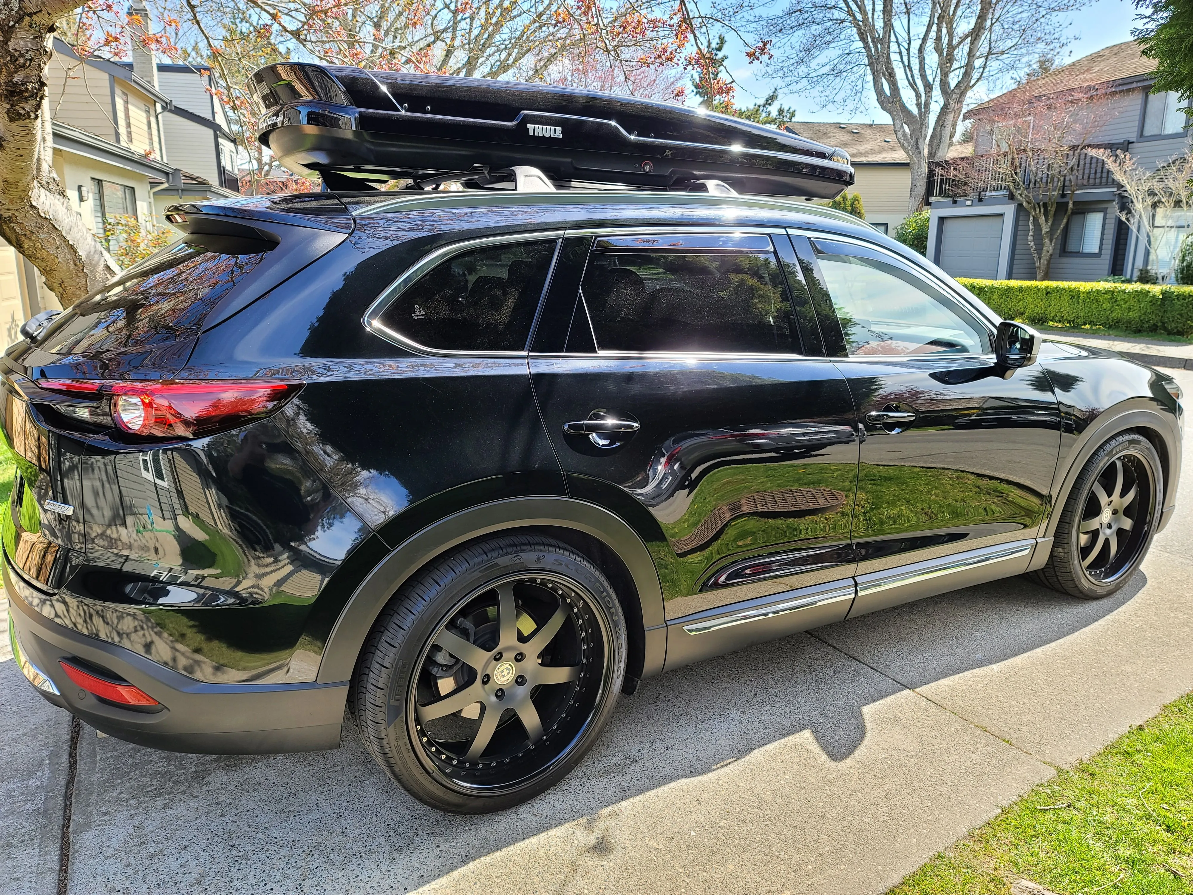

I don't mean to hijack your thread but I have lowered mine with coilovers recently. I didn't go with the Ceika Coilovers, I went with a brand call KT Racing in Taiwan and I think Ceika is made in Taiwan as well. KT Racing actually have YouTube videos of their coilovers installed on a CX9 but the video is in Chinese.
There is about 2 and a half fingers gap from tire to fender all around and I am running 285/35/22 tires.
The coilovers are high quality from what I learned on the YouTube video. Have 30 dampening levels and the ride is very comfortable on soft setting and I adjusted both from and back to 12 clicks and it's perfect with some good firmness.

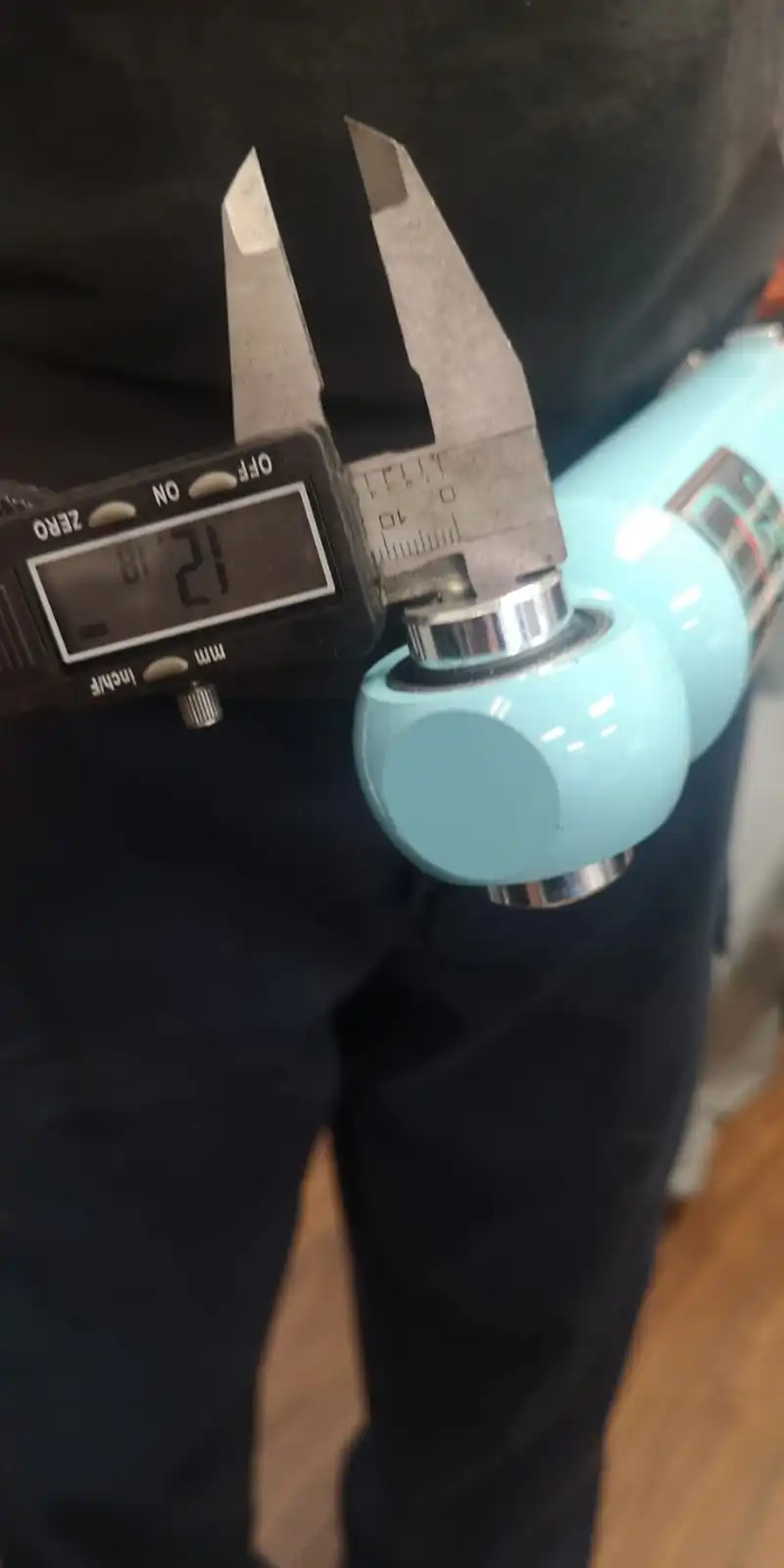

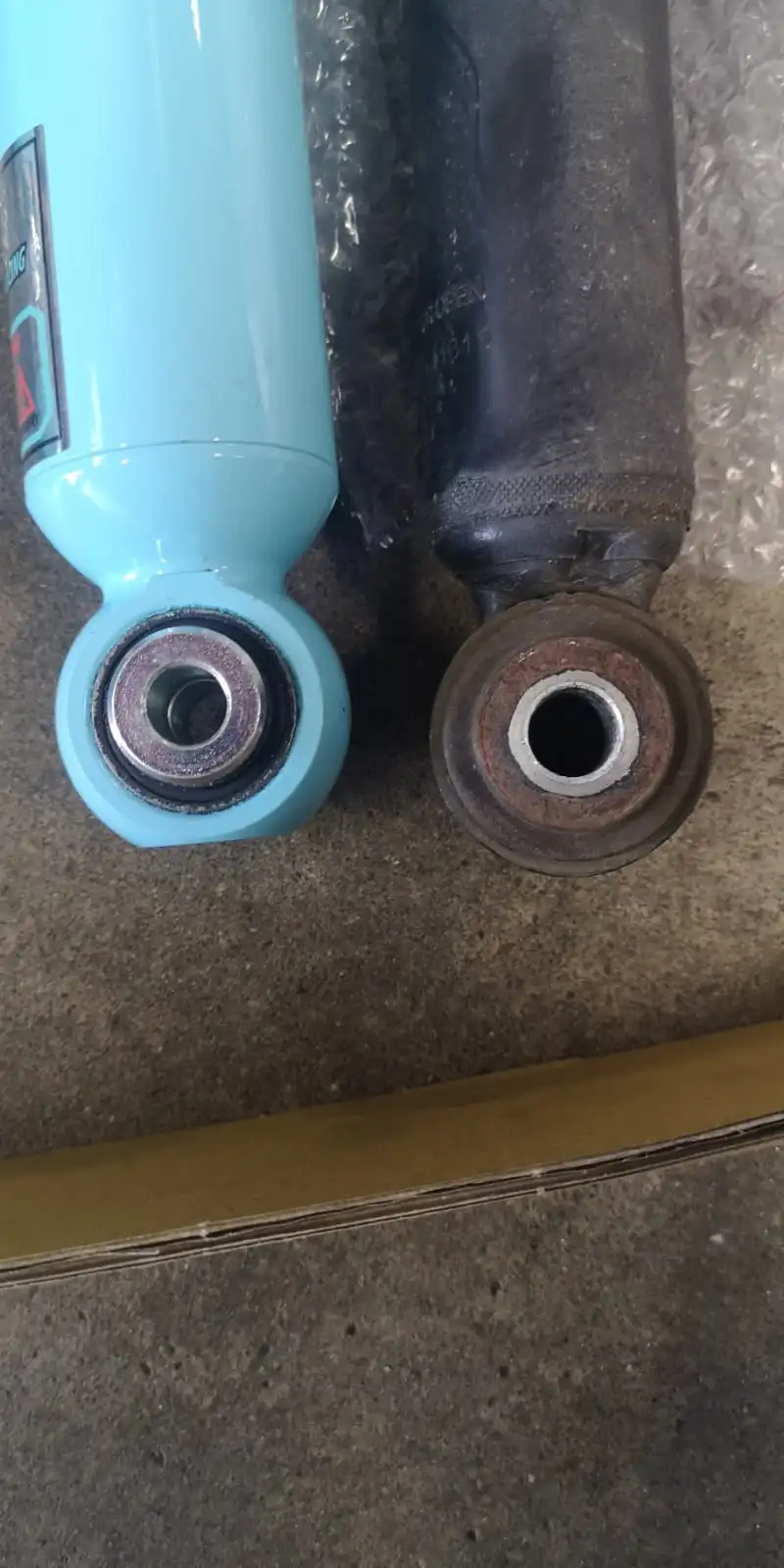

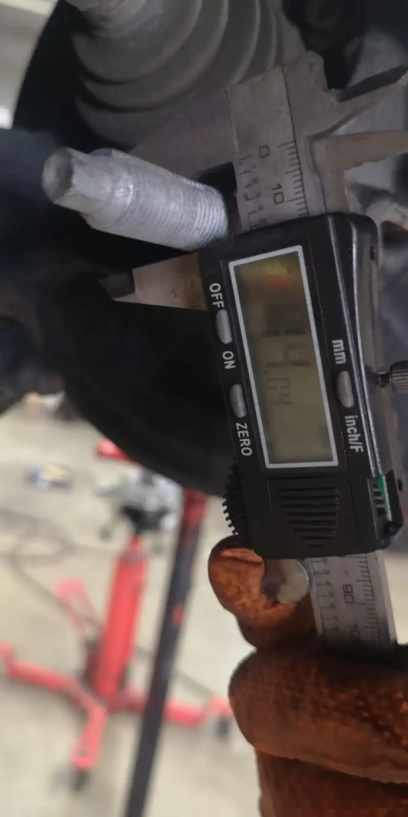

There was one issue with the rear coilovers and that is the rear strut OEM bolt is 14mm in diameter but their rear coilovers bolt opening is only 12mm but when I messenged them they send me replacement right away. Mine is a 2017 so I am not sure if the newer version has a smaller opening. Other than that, the coilovers are excellent value and this company actually just specialize in coilovers, that's all they do.
