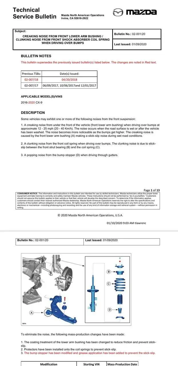

2021 looks like they changed the coating to reduce friction. You should be able to find it just by doing some googling. But even with the new coating the bushing still sticks slips as the control arm swings thru its travel. I was going to jam some silicone grease in there but I didn't want to temporarily fix it.. And even though this TSB does not apply to 21 and after that doesn't mean it still can't occur. Don't let them try that bulls*** on you. I dislike dealers generally but this dealer I'm using in Minneapolis down in Burnsville Minnesota it's pretty solid. Walser Mazda Burnsville Mn

Thank you for the info, I have a 2020 but my VIN is apparently out of the range of VINS listed on the TSB. I found the complete PDF of the TSB and attached. Was thinking about trading in for a new carbon edition even though I only have 19k miles on the odo. My engine is on the list of one that is affected by the cracked head and coolant leak which really pisses me off that it will occur sometime in the future. My headlights also flicker and bounce like they are loose and of course the dealer says it's normal. I love when they say they compared it to a similar car and it does it too. That means nothing. That vehicle could also have the same defect or issue. Dealing with dealers is really draining. Everone is so incompetent.
Yea, like talking to a brick wall. Just because the TSB only covers to model year 2020 doesn't mean later model years are immune. The new coating was an attempt to fix it. My car proves it didnt fix it in all cases. Feel free to site my repair. Work was done May 24th. 2022 CX-9. Walser Mazda Burnsville MN. The dealer and myself can confirm the diagnosis and repair. But if your gunna get rid of it, not worth the heartburn. Smokin deals on 2023s right now. Getting rid of mine did cross my mind but I dont know what I would buy. No car is perfect. You can try shooting some lanolin based spray like fluid film or Surface Shield in that rubber bushing. It's item A on the diagram. That's what I'm going to do if mine starts creaking again.
