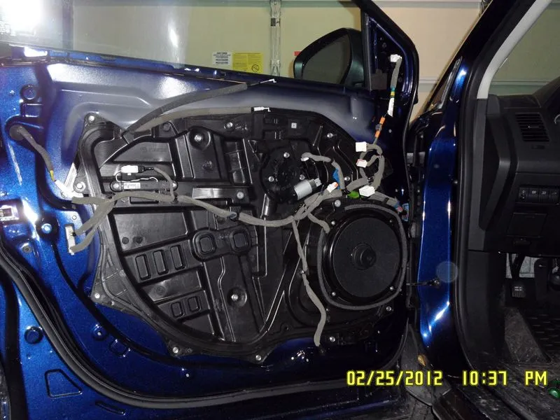

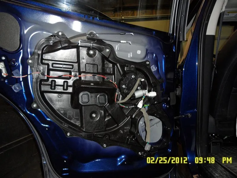

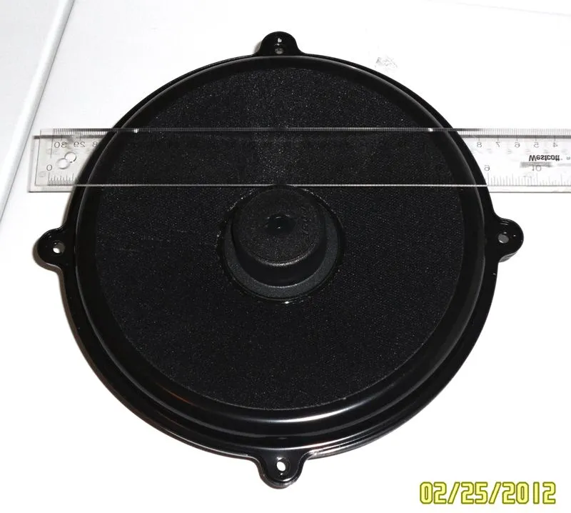

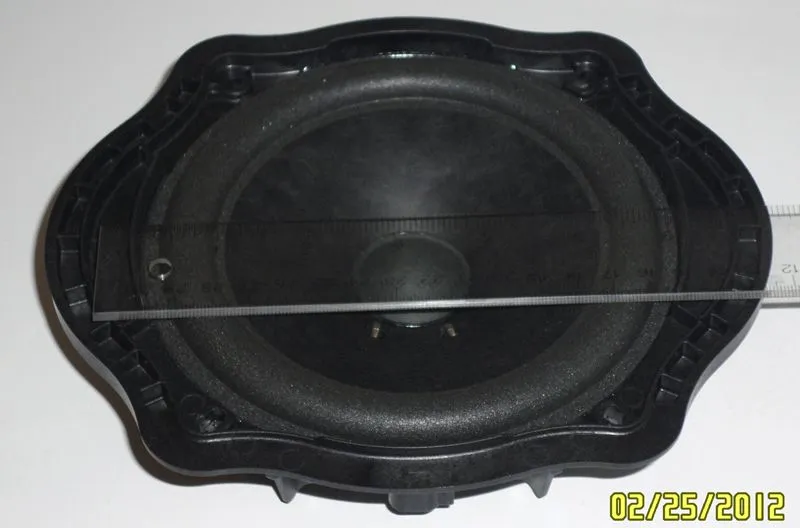

Front door is NOT 6x8. Mazda threw us a monkey wrench. It is some odd size speakers that I don't know where to get. See pictures. The speaker measures approx 8.5" in diameter, mounting holes are approx 9" across diagonally. I always hate the sound of this car, now I understand why, the front door spears have the oversized woofer.
Anyone know where I can find adapters to bolt on a set of 6.5 or 6x8? Thanks.

It looks to be a co-axial, with an overly sized woofer. Makes everything boomy and lacks definition. Well, what can we expect from Bose.
