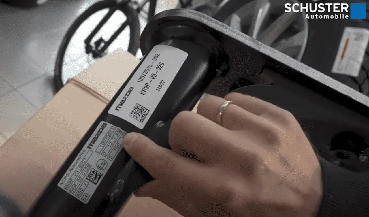

Oh, and BTW it is an Oris H5D retractable tow ball (ACPS brand).

I was about to order it when I learned, from the same link, that the thing weighs 44kg... Are all tow bars this heavy? Is there a chance there will be an aftermarket one with half the weight?

@Gajdzin where did you find the info on the 44kg mass?
