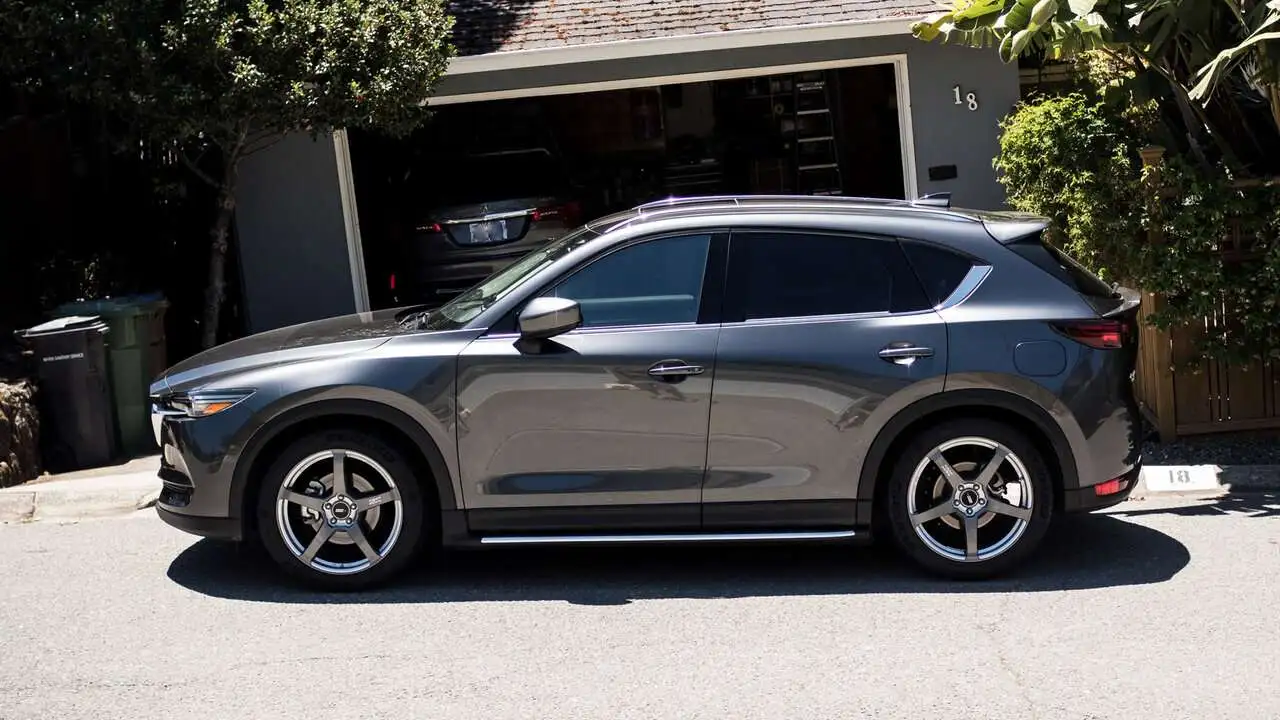

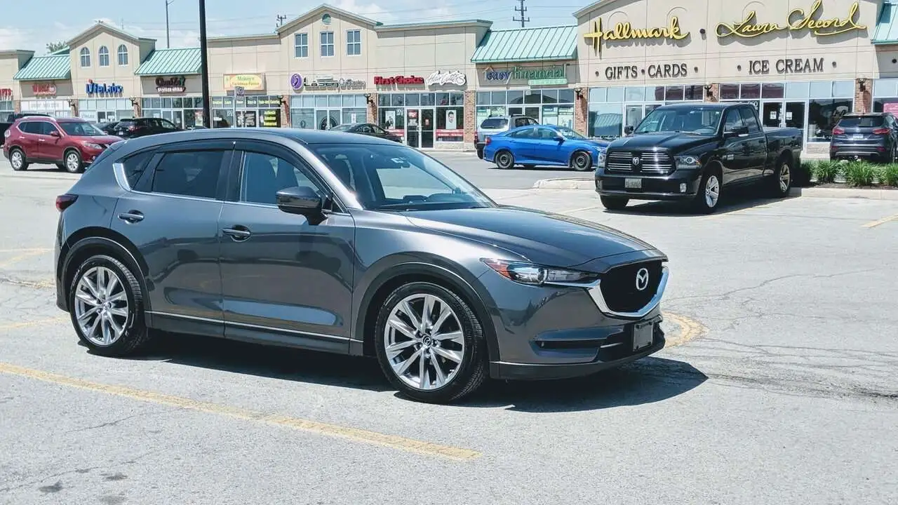

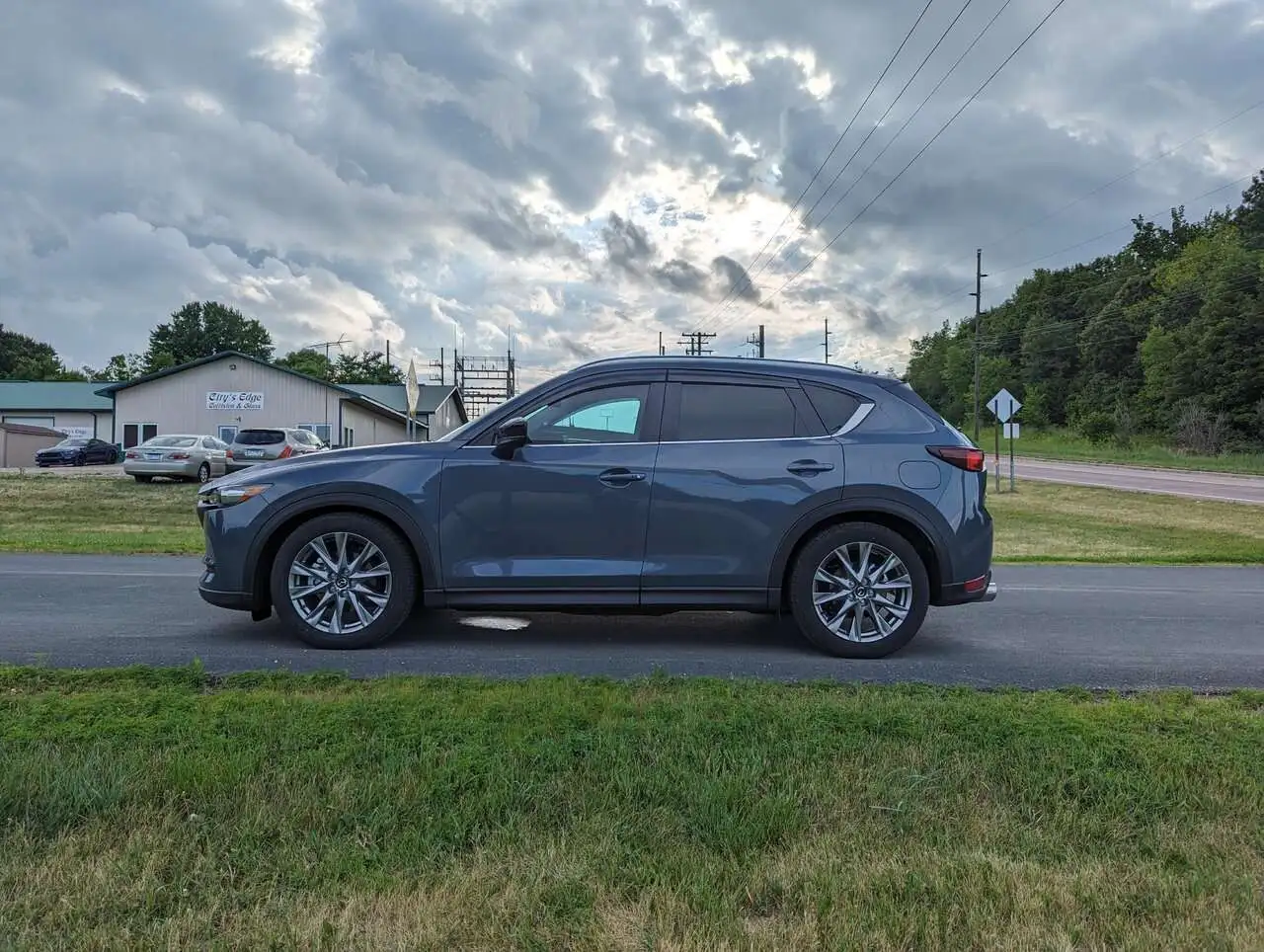

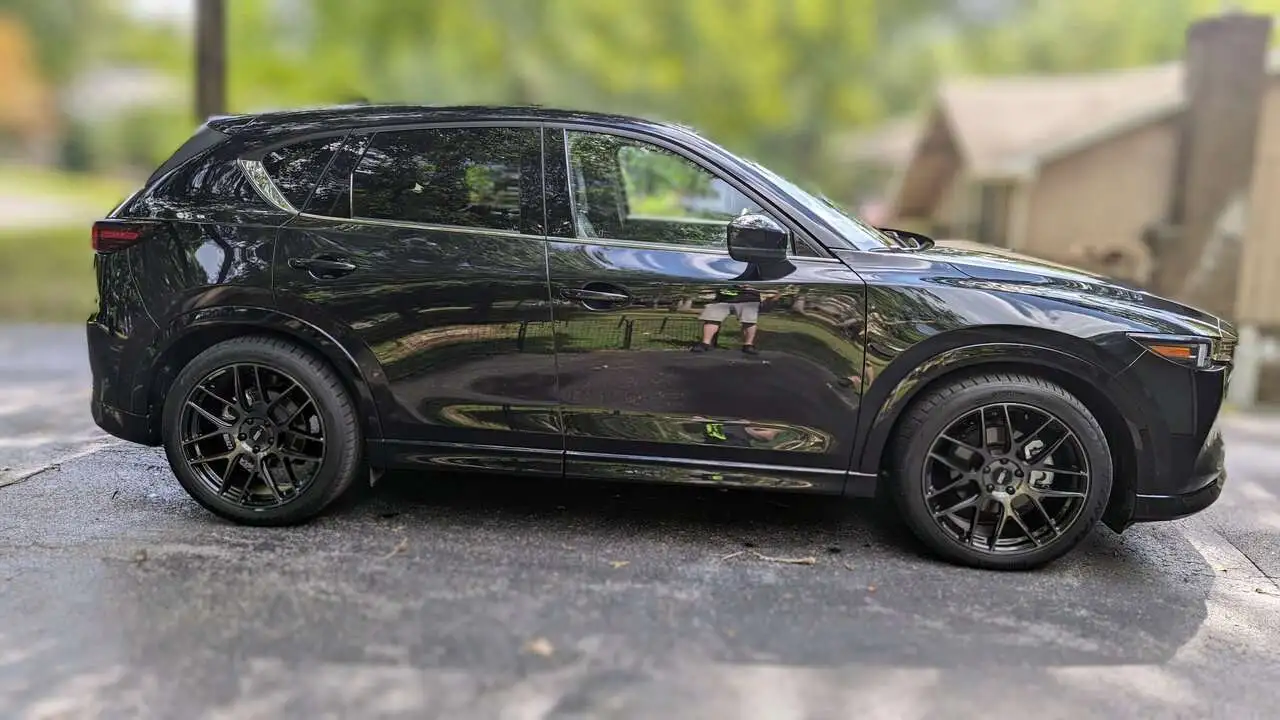

Here are some CX-5's with 20" wheels I've gathered over the last couple of months that had good fitment. I believe they are all running 245/45/20.
Flow One F2 20x8.5 +45 Continental DWS06+
Flow One F5 20x8.5 +45 Michelin Pilot Sport A/S
