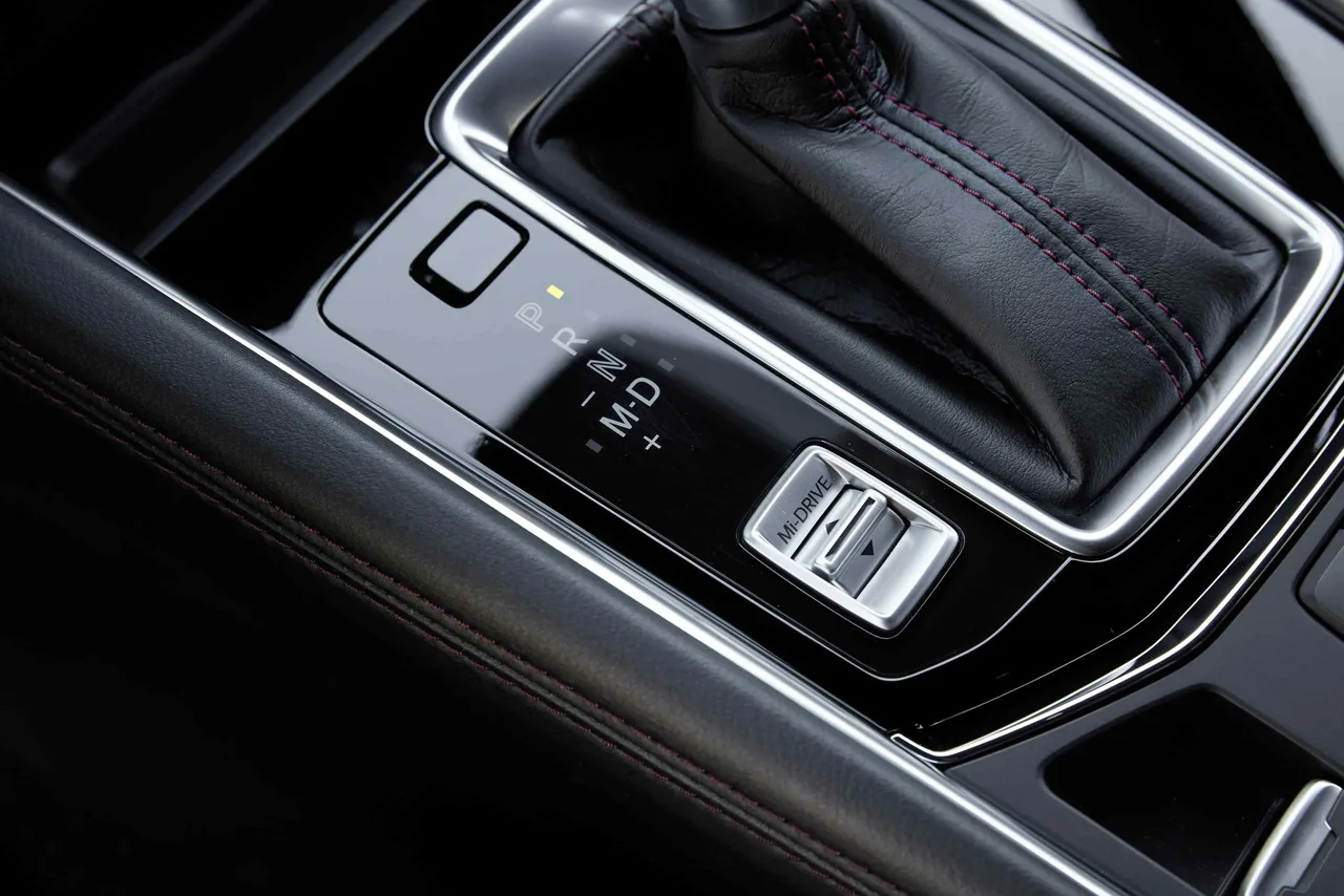

1) try pressing the end of the keyfob with the Mazda emblem against the start button (foot on brake, use the keyfob to push button instead of your finger)
2) check the shifter. There is an interlock that prevents starter if not in park or neutral. The micro switch can fail and not sense that vehicle is in park.
If it were my car, I'd do #1 ^^ above first (simple easy to rule out a problem with fob comms [the light on the button will be orange instead of green if a fob comm problem] )
Then put the parking brake on. How does that electric park brake motor sound ? Normal or slow turning straining? (Could indicate low battery power if not normal) . With park brake on, foot off brake, press start button twice turning the ignition to "on" or "run" , then foot on brake, move shifter to "N" keeping foot on brake should get a green light on start button and press start. If the car starts, I would suspect that shift position sensor is wonky .
You can do both of those in one minute sitting in the car. If no success, then check battery connections and voltage of the battery with a multi-meter. If low voltage, a jump pak or jump start would likely solve it (for the moment)
Those are my first thoughts. My gut feeling is the shift position sensor. Good luck to you. Let's us know what you find out.
(It's awesome you have a '16 with such low mileage! That's a good year 👍😁)
All the above suggestions are worth trying. I'd start with the shift position sensor. Just try rattling the shift lever while in park and see if that affects it. Else move on to the battery - if you can jump start it, then it's a pretty sure thing your new battery is faulty.

I have tried to adjust the shifter but it won't move. Is firmly in park. Doesnt matter what I do with brake, it won't shift in to Neutral.
The brake is stuck half pushed in - it's not fully out like it is typically before it starts.
Tried the key fob to starter - didn't work.
Put the parking brake on - seems to go on fairly easily. I can hear the motor engaging it. But starting with different combinations (pushing start button twice, then once, long hold, jiggling the stick shift, etc).

You can't shift out of park unless the engine is running. I just tried it on my 16 Touring.
Hm. Had a Mazda 3 where @50Kmi the sensor that's part of the brake pedal assembly had failed. Was wonky for a couple of months, occasionally disallowing shifting; then it failed completely. It locked the shifter in "Park" and the thing wouldn't move.
Uncertain if the CX-5 has the same sort of sensor for the shifter, but it wouldn't surprise me. If you do a lot of braking, it might well have failed by now. That could be the "stuck shifter" issue. Worth checking, at least.
That sounds like exactly the problem. Will have it towed and check the brake sensor as well as the battery.
I think you can—pry under the little plastic cover above P to remove it. This will gain you access to the shift-lock override.
