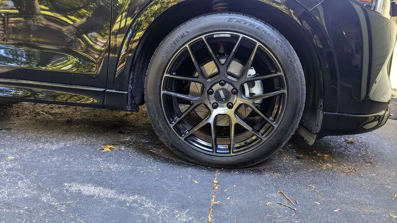

That was my thinking as I went with stock size slotted rotors made of better iron and improved pads on my Turbo as it already has dual calipers up front on a 320mm rotor (12.6").
I am very pleased with the performance of it, but every time I come down on the brakes hard, I see $$$$ float out of the window as those slots cut into the pads. LOL
