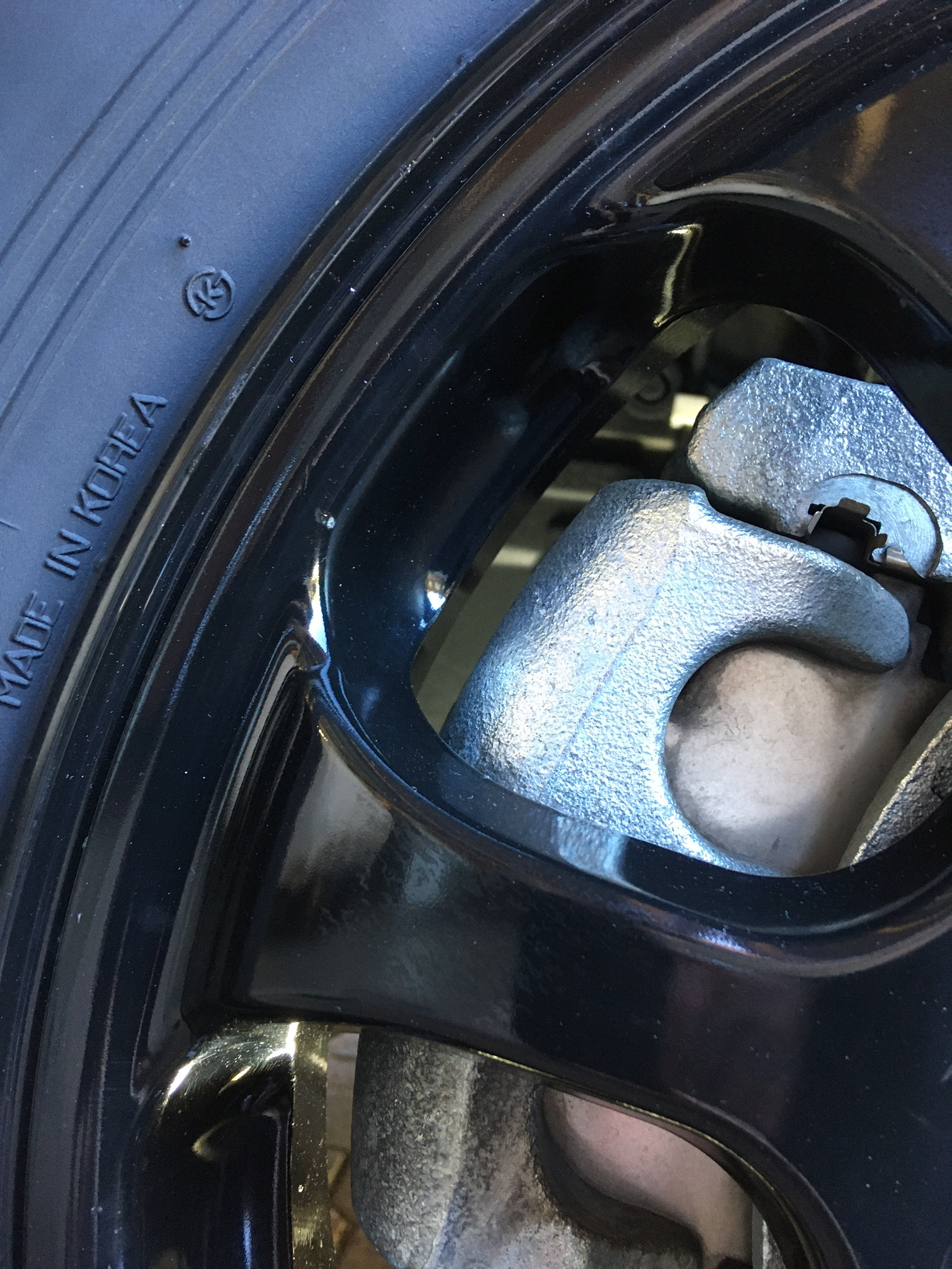

So the 17" spare won't clear the brake calipers?
This is the clearance on a turbo model with a 17" Hyundai Sante Fe spare. I measured the gap at .400", maybe a few thousandths less at the center of the caliper. The T165/90R17 tire has the same diameter as the road tires so I wouldn't hesitate to run it on the front, the only limiting factor is the tire's recommended max speed is 80kph (50 mph) which seems ridiculous. They make bicycle tires that can handle higher speeds than that! I have a feeling the nanny corporate lawyers had their hand in that speed rating.
