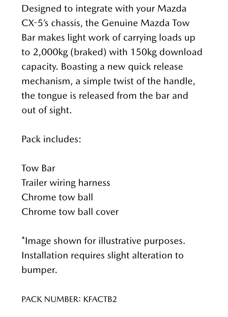

This’s the problem by Mazda North American Operations, and the same problem happens on OEM Remote Start accessary. I’ve seen the pictures of OEM trailer hitch offered by Mazda Australia and it’s much nicer, and no cutting on rear bumper!

Looks like down under they include all the necessary parts, unlike in North America, or at least the US where it seems all these parts are required for the 2017-2021 CX-5:
0000-8E-R06A Trailer Hitch Class I
0000-8E-R13 Trailer Wiring Harness
0000-8E-R10 Trailer Hitch Harness Re-Route Kit
0000-8E-R08 Ball Mount Trailer Hitch
0000-8E-Z14 Cover, Trailer Hitch Receiver
