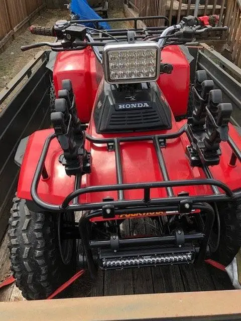

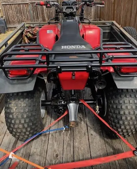

Yeah.. I've towed quite a bit in the up to 1500lb range with my '15 CX-5 GT. No issues so far... in fact going to tow with it again tomorrow with just my old '85 Honda TRX 250 ATV.

Plan to tow this new one I picked up today as well when needed with my CX-5...overkill to tow it with my GX 460.. supply chain took me 6 months to get
