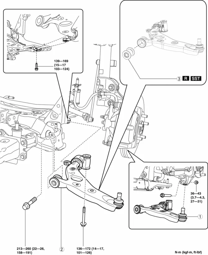

Sorry to hear the incident, an incident I’d seen before but only happened on much older cars, not on an 8-year-old car with only 73K miles. Luckily for you it happened at slower speed and nobody got hurt.
I assume your front suspensions have never been serviced before at 73K miles, unless you had done some LCA bushing job from some TSBs. I believe the failure is from the ball joint on lower control arm. The nut on ball joint has cotton pin and it shouldn’t get loosed easily. The stud of the ball joint is very strong and it shouldn’t be broken easily either.
This kind of incident is very rare. If I were you I’d report this incident to NHTSA and BBB websites complaining this major safety issue. I then will contact Customer Experience Center, Mazda North American Operations and express your major safety concerns on the issue. Depending on whether or not if you want to go further, some lawyers may be interested in your case seeking for compensation from MNAO.

Hi
Thank you so much for the time you've taken to provide such a detailed reply with drawings.
I'm based in the UK although it may still be helpful to report the incident to Mazda. I've currently lost faith in the car. Although I was very lucky, someone else suffering the same serious problem may be less fortunate.
