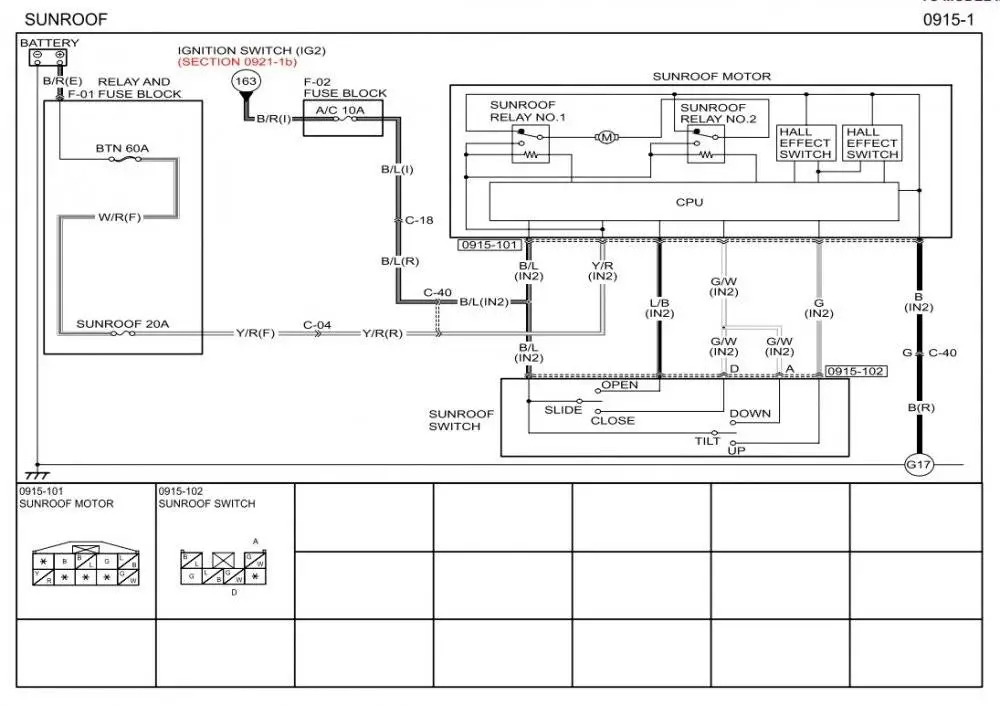

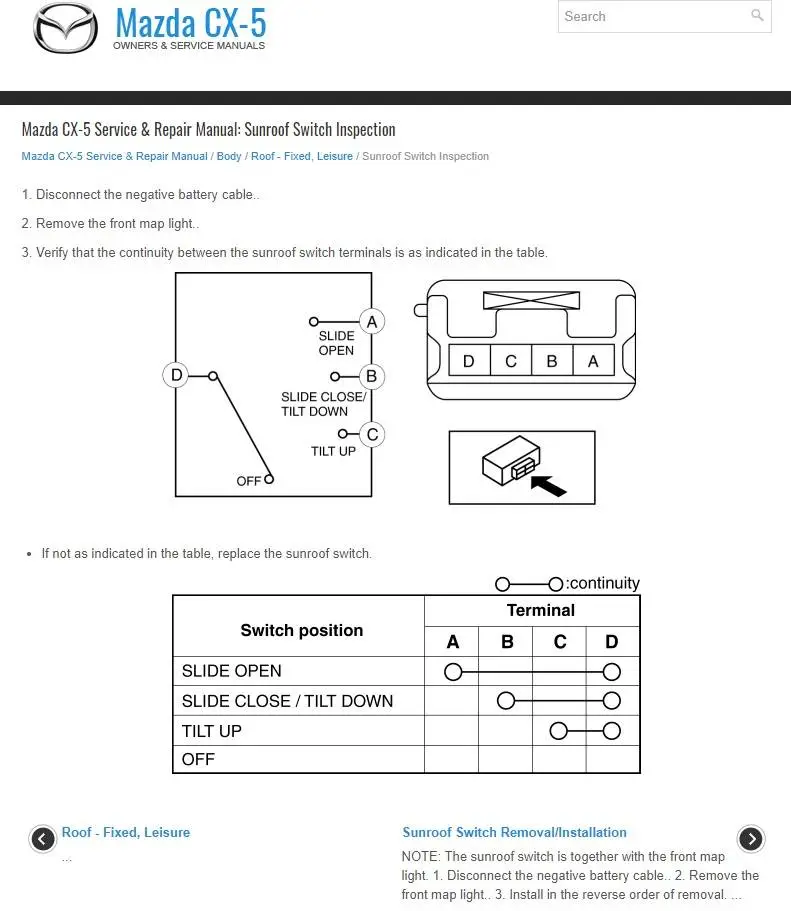

Reset didn't work. Motor makes zero sound or movement. The switch has felt loose over time and a few times the sun roof didn't respond until one day it wouldn't close. I manually closed it with the allen key, swapped fuses around with no luck. Any idea how to test switch vs motor?
Update. I saw a Youtube video that somebody posted about a small piece of black plastic that had broken off into their sunroof switch. They discovered it after dismantling their roof console, removed it and it worked. My switch turned out to be broken/ dead. Maybe there was a little piece of plastic inside it, couldn't really see. The switch housing is glued together and you have to basically destroy it to look inside. I bought a replacement used sunroof console on ebay and this took care of my issue. Note: you have to buy the whole console with the lights, sunglass drawer and phone mic just to fix the sunroof switch. Good news is that the Cx-5 shares parts with Mazda 6 and Mazda 3 so I was able to find a fairly affordable one for $55. Other note: To test your motor, cut a small piece of wire and strip the ends. Insert one end into the sunroof switch harness (A or D side) while the key is in accessory mode. Insert the other end into each slot until the sunroof does something. If nothing moves, your motor or motor relay might be dead.

Not sure why you have to replace the whole console instead of just the broken sunroof switch. A picture or two about the switch and wiring you described would be great!
