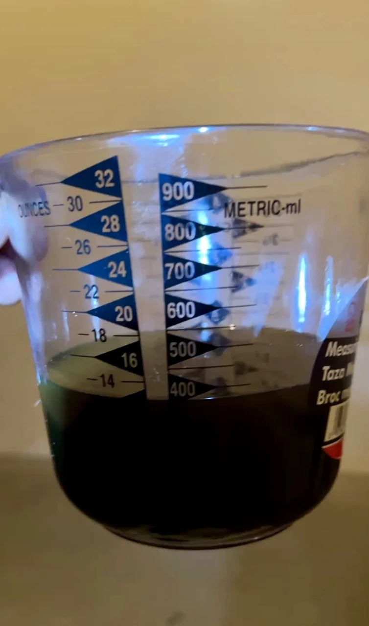

Front factory fill is little bit less than 400ml or 13oz.
Took aprox 450 ml (which is what the workshop manual says for front).
so it appears you were able to fill both front and rear to the brim of the inspection holes with a single qt? I am getting ready to change mine and cheaper to order than buy locally by a bunch so I don't want to only order one and be short. thanks..
1 Qt is 946 ml. I used 1 or for both diffs.

1 Qt is 946 ml
yes indeed. I am wondering if cz5gt actually got to the brims with only 1 qt. as he said approximately 450mls and approximately 500mls. ie would be approximately 950mls total.. 4ml is pretty small.

yes 1 qt is doable but bear in mind I used a pump - some oil stays in the pump lines plus the pump cannot pull when the bottle is near empty plus there is spill when filling to the brim and the extra drips out.

you could add aprox 450ml front and 450-460 rear (50/50). May not end up to the exact fill hole on the rear but still great than factory fill.

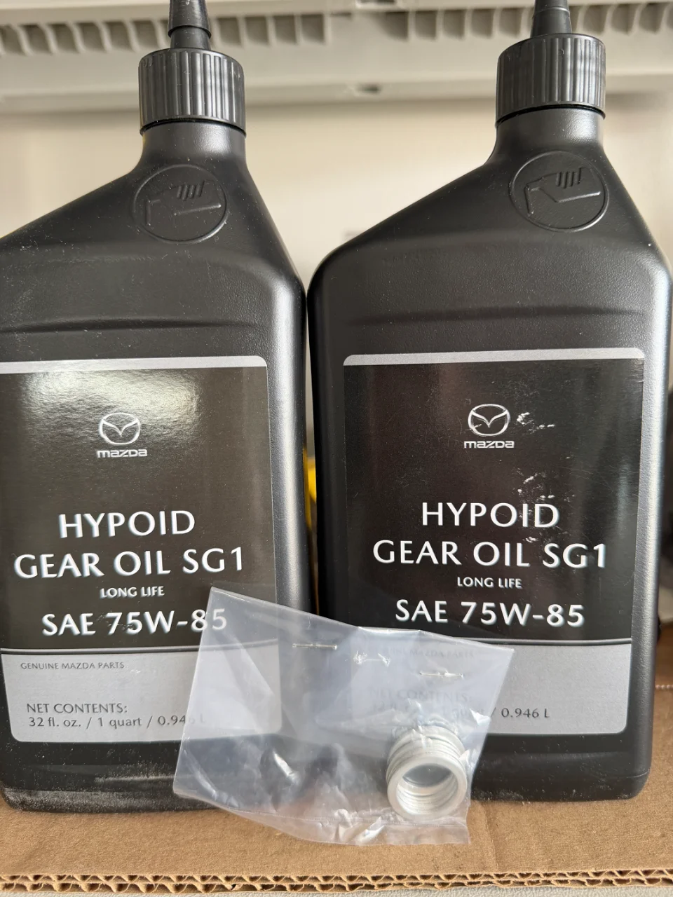

thanks I will get 2 qts.. just called my local mazda and they sell a qt for $35 so not terrible and washers $3.25.
35.27 is the msrp :) some dealers give 15-20% discount when you ask. My closest didnt but another one gave discount. Had to pick in person.

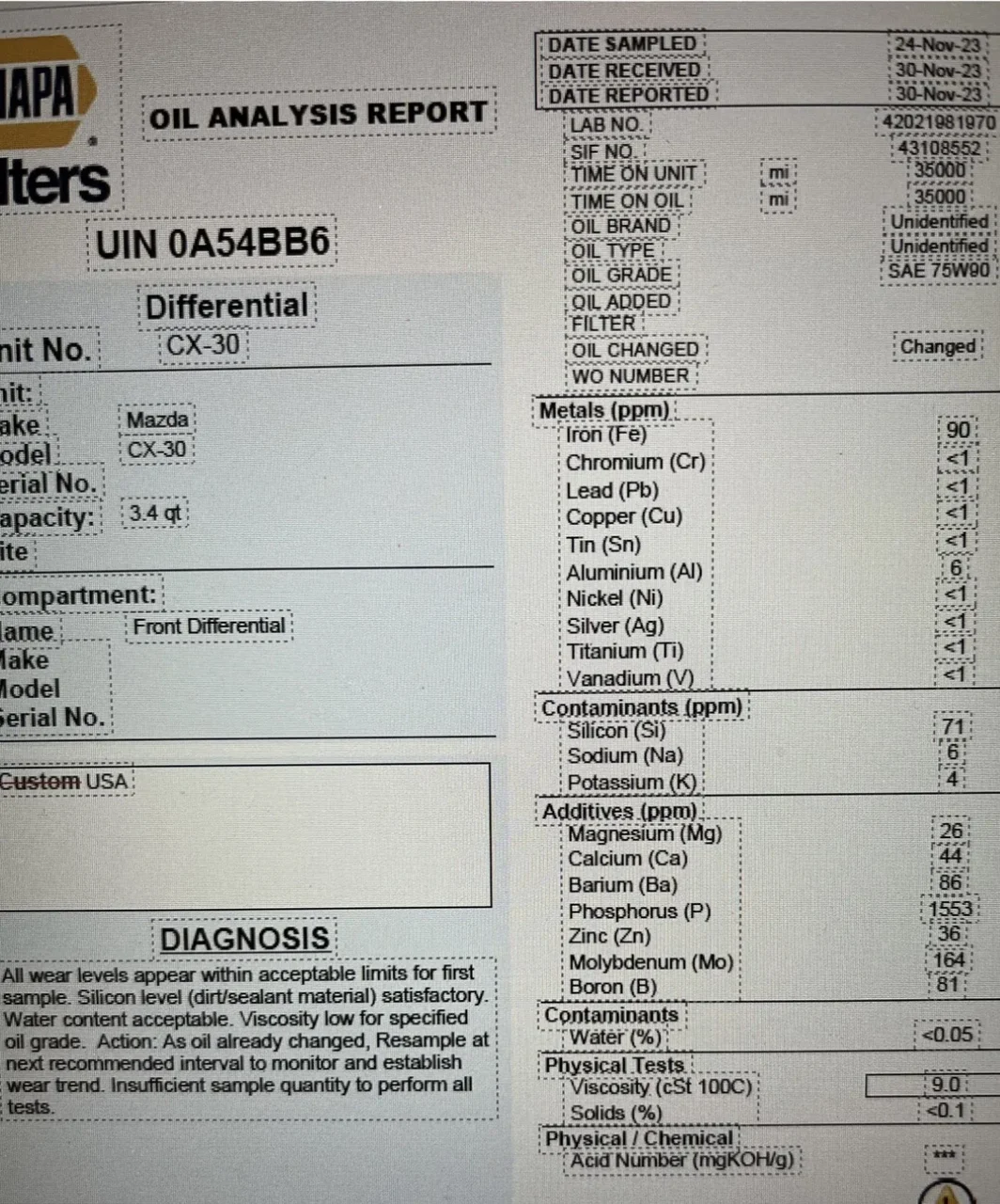

Gear oil normally doesn't change color very much. What we don't see is the fine dust that leaks past the O ring and lip seals. The dust acts as an abraze.
We don't think of these items as open. They all have imperfect seals, the diff goes through heat cycles and expands and contracts pulling in contaminants we can't see. It might be worth sending in a sample and have it analyzed...
somebody already sent a sample...forgot where I saw it ..whether here or in another forum
found it.. so seems around 30k miles mark is good time to change it..
You will need to get 2 quarts, you won't need it all but you will have a little leftover.
Silica contamination confirms imperfect seals in differentials. Mazda should have a diffs change intervals in their owners manual......
We don't know if the owner was off road alot vs paved roads.
Good find!
Good find!
first change I would not necessarily say that is true. silicon can be from the seals themselves or different assembly lubes and the gear oil itself etc. also would need to compare it with a virgin sample. silicon and silica are not always the same. if on the next test they come down you might figure it is just from sealants etc.
