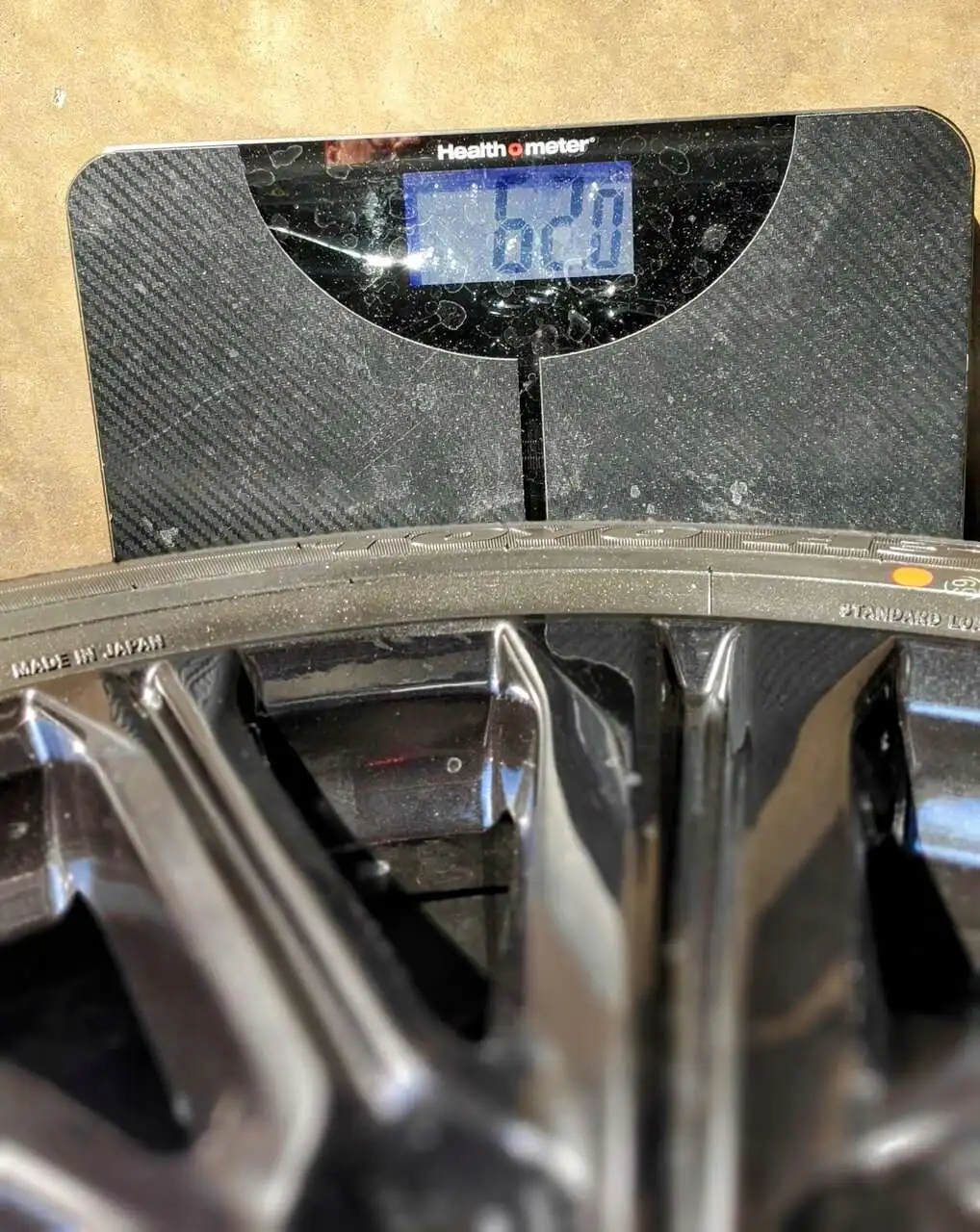

I weighed a 19" wheel today from our 24 CX T.
62#s as mentioned. Yikes. It the tire weighs 29#' then the wheel weighs 33#s.
7I'm going to order a set of 19 x 8 +4 flow formed wheels. They weigh 27# each. 24# of unsprung weight can only help.
I'm going to order a set of 19 x 8 +45 flow formed wheels. They weigh 25# each. 32# of unsprung weight can only help.

What wheels did you end up ordering? Depending on the design, that sounds a little heavy for a 19x8. Many I looked at were 21-23 lb in 19x8.5. They must have a thick spoke design.

We picked a flow formed wheel for strength and weight.
There was not much of a selection in 19 x 8 wheels. We couldn't find any of the wheel we liked in the USA. Found a set in Japan. I wanted to stay in a width to for a 255/55r19 tire. This is a DD my wife will mostly drive. We will most likely buy Conti TrueContact Tour next. They are almost 4 pounds lighter than the Toyo A36 on the car. Another 16 pounds for a total of 40#s unsprung weight. Now we are talking....
I found some 19 x 8.5 as light as 20 to 21 pounds. They were recommended for the track. Not saying folks don't drive on the street with them. My wife will be driving the car. Driving around pot holes, NOT. So I elected for more strength and a little more weight...
