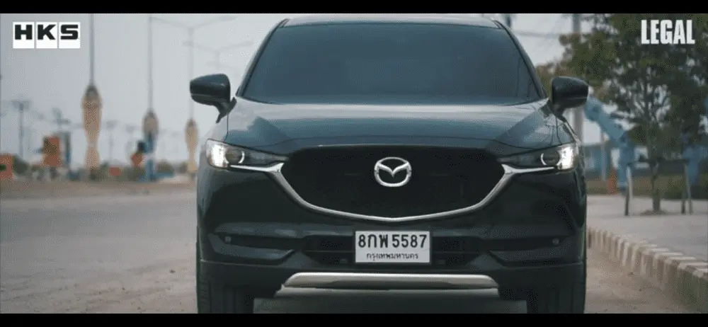

Noticed on the cx5 HKS exhaust video that the car had different headlights. Took me a while to figure it out. But on the JDM GL models the parking lights are on the outside The inner blinkers only flash and are not on constantly with the parking lights.
I know its a minimal pointless change, but I like this much better than the USDM models.
I wonder what it would take to achieve this.
The USDM models have a 'blank' in the headlight, I wonder if the reflector is behind the 'blank'. It may be an easy mod.

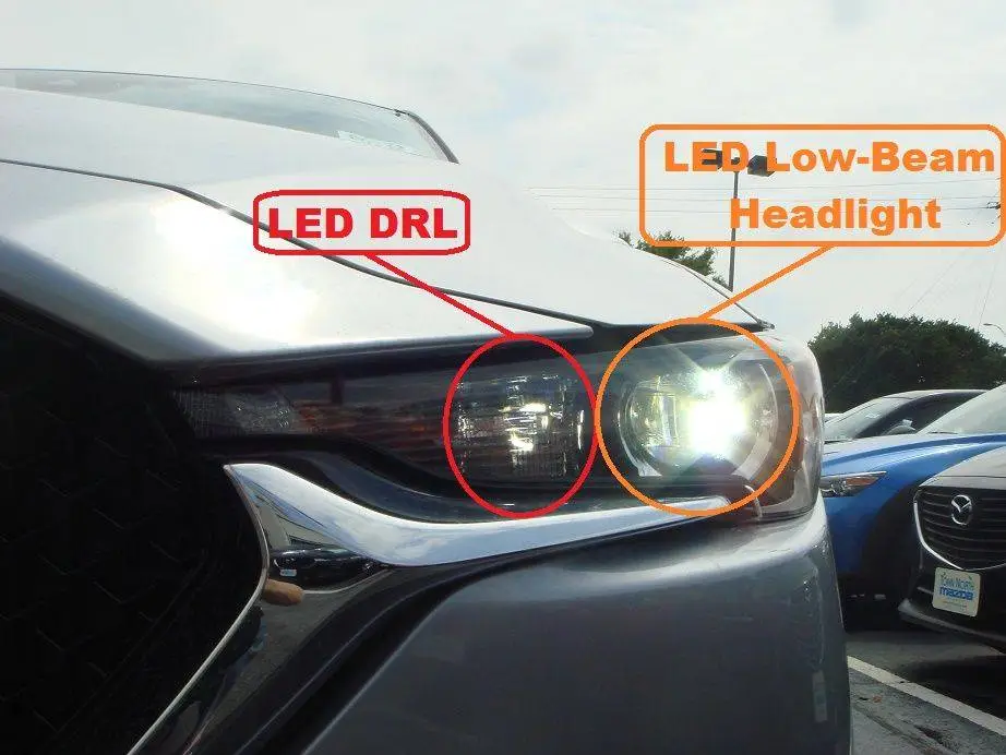

I did a similar mod to front turn signals of my 2016 CX-5 GT with Tech Package which has LED accent strips serving as parking lights and DRLs. The front amber turn signals do have dual-filament 7444NA bulb which also serve as parking lights. I disabled the parking light on the 7444NA bulb so that the LED headlights look like those on other regions including the JDM. The only thing left is the US only front amber side reflectors.
Simplest Mod for Your 2016 CX-5 Front Turn Signals with LED Lightings
On gen-2 CX-5 if you have LED accent strips that have served as parking lights, the turn signals are dedicated although the visibility is very poor due to the in-board location. If you don’t, not much you can do to preserve both functions at two different locations. You may have to get entire headlight assembly with LED accent strips which will be costly. The easier way to get something better than USDM version is to get 7444 LED bulb with “switch-back” function. You gets white light as parking lights, and on-off-on-off effect on turn signal mode.

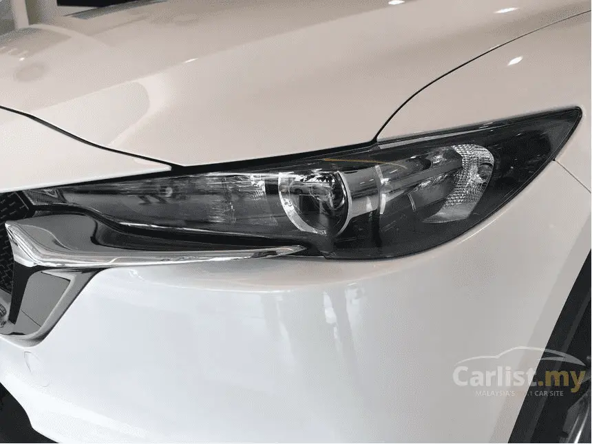

The screenshot you have isn’t the JDM based on the front license plate. The parking lights are on the outer side for gen-2 CX-5 which is the first time I’ve seen.

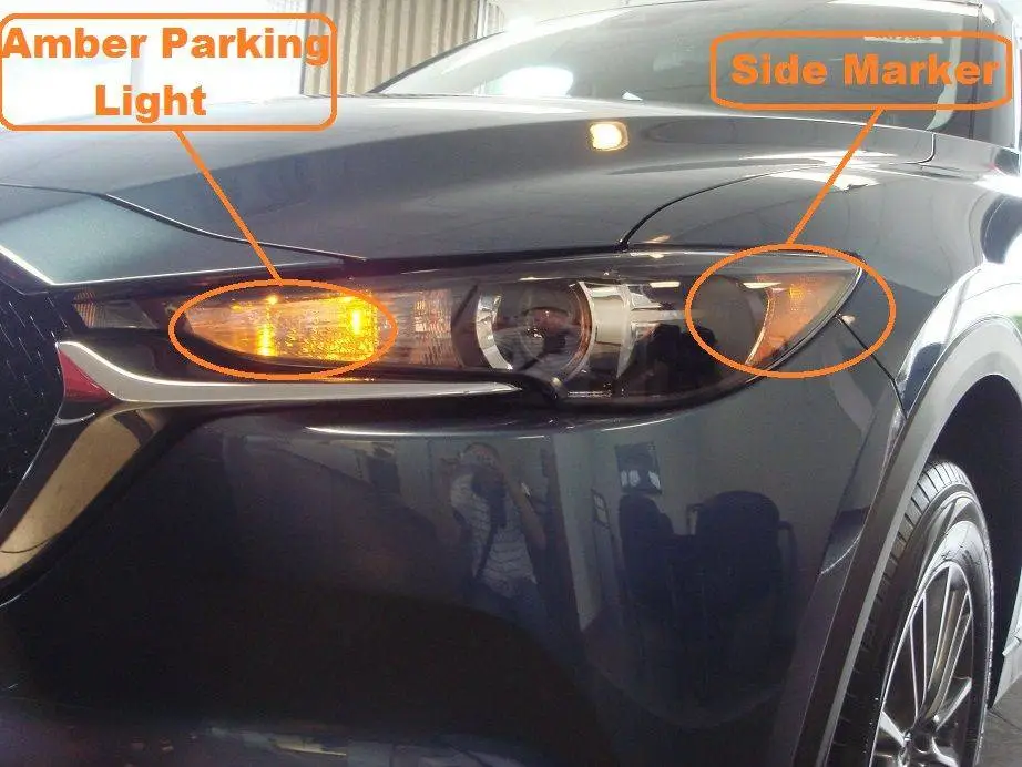

For US version lightings here are gen-2 CX-5 Touring without LED accent strips which should be your version:

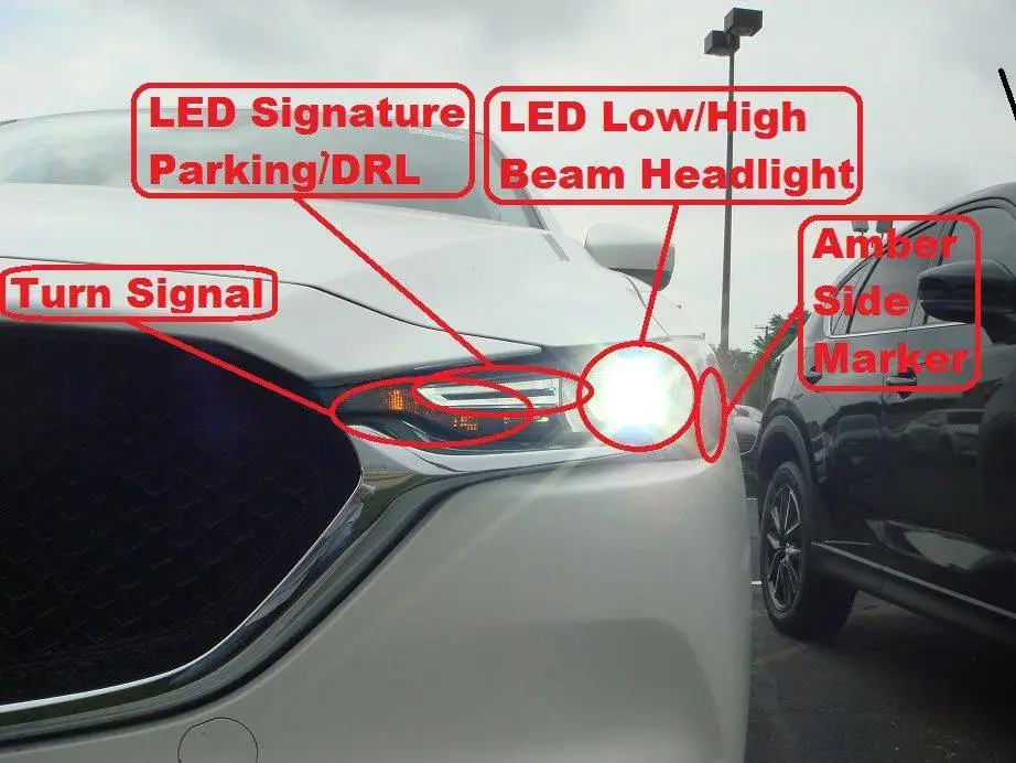

Here are gen-2 CX-5 GT with LED accent strips:

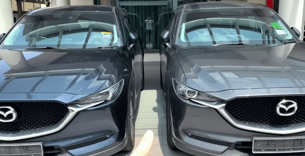

here is another comparison shot of the CX5 GL compared to the , note the reflector on the outside of the LED headlight.
a close up
Really makes me wonder if the reflector is behind the cover in the USDM models. I really doubt Mazda would make a whole new assembly or part for a lower-model vehicle as opposed to just installing a panel.
Again, it's a small detail, but it raises my curiosity.

You can’t simply just swap out a US-spec headlight assembly with a JDM version, due to the light pattern is opposite with RHD vehicles in Japan. Besides, those LED headlight assemblies are very expensive (>$1,000USD EACH) especially with AFS!
