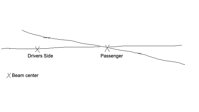

Minor accident and my headlights look like this:
Is there any way I can manually rotate the projector led back to horizontal?
My other vehicles I have retrofitted projector lights. Looking at what your looking to accomplish, may make require opening the headlight.
I haven't seen any adjustments for that sort of movement. it's usually left-right, up and down. From that figure, it looks like the passenger headlight itself isn't installed correctly or there's something going on inside of it like vrsick noted.
Obviously, your accident bent the mounts, the only way to fix is to fix the sheet metal. There are no rotational adjustments (as said above).
So it's what I thought then. The front bumper on that side is sticking out about 1cm~ more than the drivers side. And it looks to me like if that extra bit was flush, the entire headlight would sit back to horizontal.
Repair shop said its a clip on the side of the bumper that may have bent or broke.
