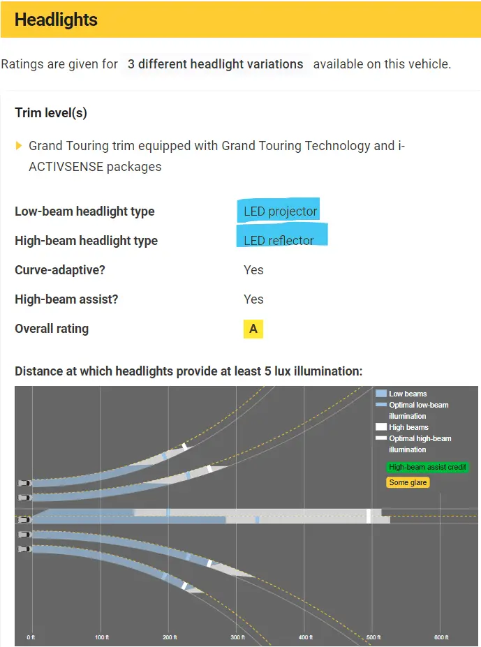

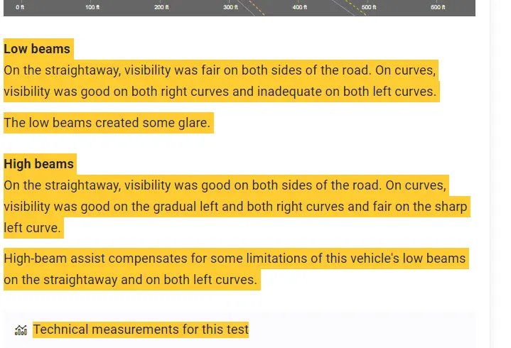

Referring to the 2016 Mazda Owners Manual it would seem that LED headlights with AFS are available equipment and the IIHS does confirm the GT with Technology Package has LED headlights. The yellow "A" rating shown means "Acceptable". You can see the straight ahead throw of the headlights is not optimal, a little short of optimal, as is the left side.
The best IIHS rating is a green "G". Below "A" is an orange "M" for marginal, and a red "P" for Poor.
That being said replacement of the LED headlights is not likely or easy. These LED headlights are not, to my knowledge, user replaceable as halogen headlights are, and to a lesser extent HID headlights, both of which yrwei52 discusses. I would caution that the cited color temperature 41K should be 4100K.

In addition, the LED headlights you have include the Adaptive Front-Lighting System (AFS) which swivel headlight beams as you steer the car giving you added visibility. You can see that the left swivel is not as effective as the right swivel, which I suspect is largely due to the purposely asymmetric headlight beam pattern (typically, for left hand drive vehicles, the left side beams do not throw as far as the right side beams, because the left side beams can impact oncoming traffic).
Automotive headlights can be a complex subject, and I am not aware of much that can be done with the LED headlights. You can ask the dealer to check/readjust them, but I am going to guess they will decline or say there is no adjustment.
