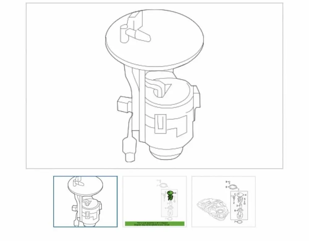

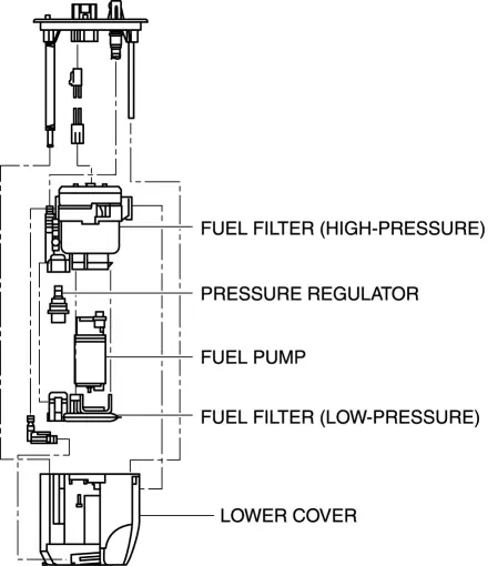

There’re always 2 fuel filters and 2 fuel pumps in modern fuel system on the vehicles. Usually the smaller low pressure fuel pump and its filter right in front of it are build-in with fuel gauge sending unit submerged in the fuel tank. The bigger high pressure fuel pump and its canister-type filter usually are external and the high pressure fuel filter most often located in the engine bay. The canister-type high pressure fuel filter on my 1998 Honda CR-V mentioned in my previous post is located on the firewall.
Now, Mazda put canister-type high pressure fuel filter right with the fuel gauge sending unit above the low pressure fuel pump and its filter (or strainer).
Apparently the video made by our great felixd didn’t change the “real” canister-type high pressure fuel filter in his video; nor as the video posted above by ceric:
Guide - Mazda CX-5 Fuel filter strainer replacement

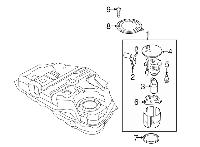

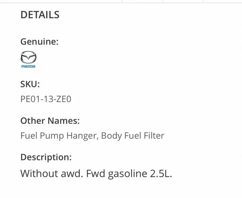

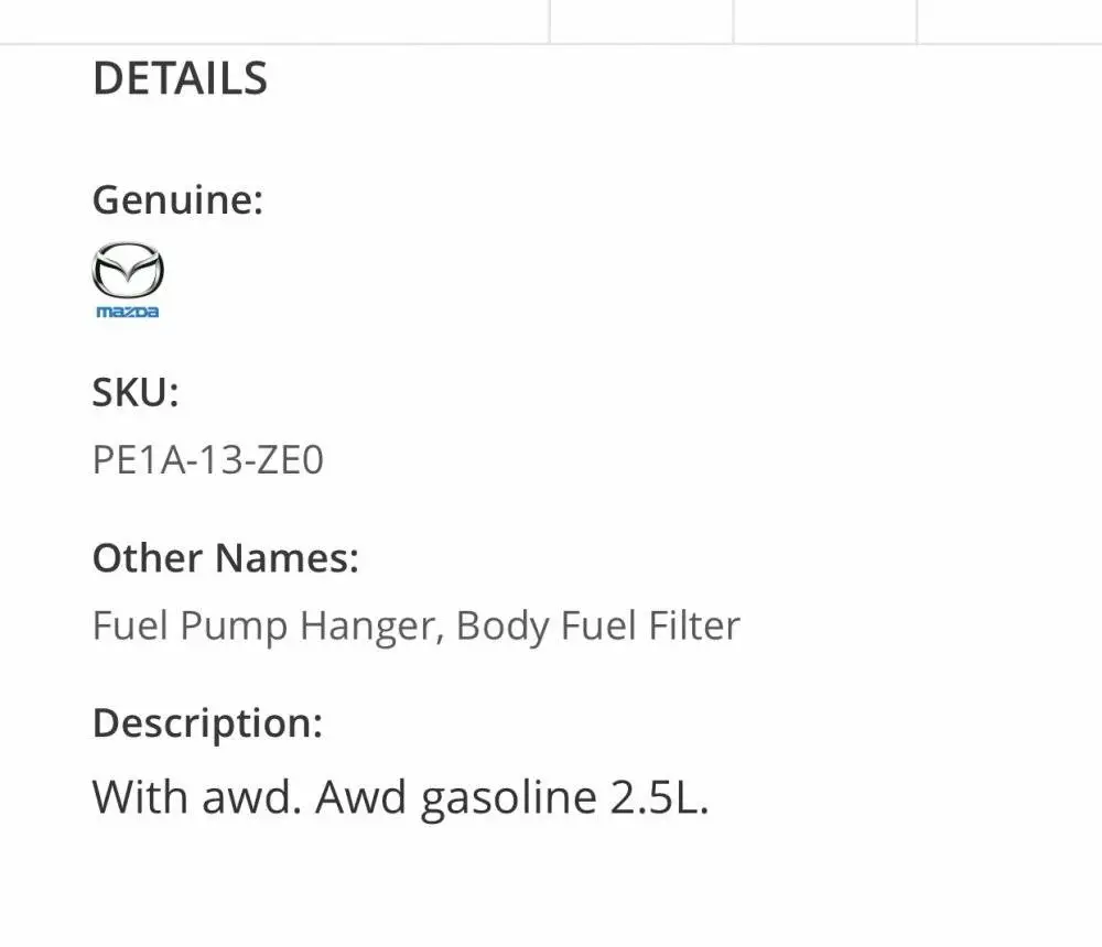

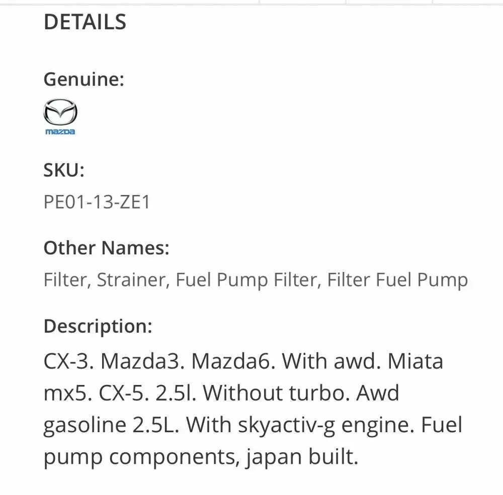

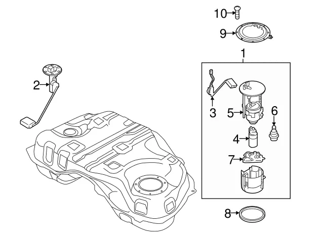

From parts schematic for AWD CX-5, #5 is high pressure fuel filter (canister-type); and #7 is low pressure fuel filter (strainer):
From parts schematic for FWD CX-5, #4 is high pressure fuel filter (canister-type); and #6 is low pressure fuel filter (strainer) which is the same as AWD’s PE01-13-ZE1:

If you do that you’ll have to pay additional $229.32 MSRP for the low pressure fuel pump. Might be better off just to get entire “fuel pump assembly” which includes fuel gauge sending unit and fuel pressure regulator (p/n: PE1A-13-35X for AWD and PE01-13-35X for FWD; #1 in parts schematic).
yrwei52: Thanks for info. This will be a long ways out but good PN to bookmark. Spark plugs next year or so will be next project... I'm currently near 64k miles on my '15 purchased summer of 2014.
