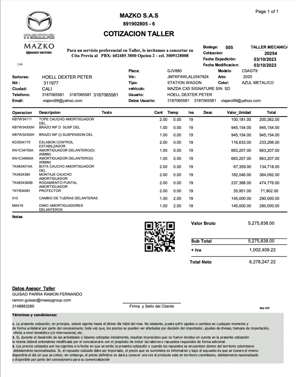

I took it to the deeler today. A service person test drove it with me on city streets. Fortunately for this test there are some rough streets near the dealership and he was able to perceive some of the rattling from right front. He was taking right angle turns on streets hard but it wouldn't work for the oversteering issue. Returning to the dealership, after consultation with my test driver I was told I have to leave the car for two to three days for them to run full tests on the issues. The test driver listening to the rattles said at the very least the shocks were bad, identified by the rattle I hear on un paved road. l' ll give a report as soon as there are advances. What a bummer and worth repeating this car has 33,000 miles on it. I commented a long time ago that I would be the test bench for this model on rough roads since my daily outing involves six kilometers of rough unpaved road. As can be imagined I am supremely dissapointed. I have enjoyed the dickens out of the turbo on paved highways. But by comparison I have owned five other vehicles in the last twenty years that I have driven over the same road none of which suffered suspension issues after far higher milage. I will update following feedback from the dealership.
A video at the dealership. Both front shocks to be replaced and some other front suspension components. $1,600. This with 33,000 miles on the car. Clearly the CX-5 suspension does not hold up when subjected to travel over unpaved road conditions. Driving this same road I have owned a Suzuki Vitara, Mazda 4x4 pickup, Nissan 4x4 pickup and Renault Duster. None suffered suspension failure during many thousands of miles. I love my Signature but it's the wrong car for my environment.
Looking at your video, to me it looks like from the amount of wheel 'wiggle' that the wheel bearings are loose. At least that's my first impression. Loose wheel bearings will make the car handle 'squirrelly'. Let us know what parts were replaced to fix the problem.
Actually, if you look again, it looks like the lower control arm is wiggling with the wheel (both sides). Doubt it's the bearings, just the LCA. Also, why are they changing the shocks? If they're not weeping, I would doubt you need need shocks at 30K.
Although it will be Greek (actually Spanish) to most including me I'm adding the estimate. Brazos" are arms so I imagine referring to the control arm.
