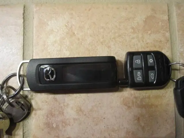

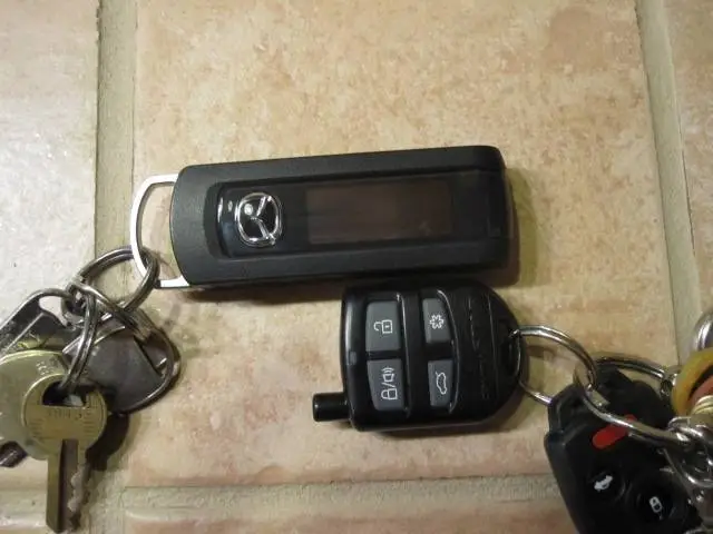

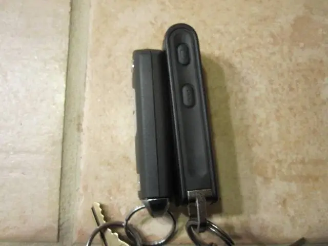

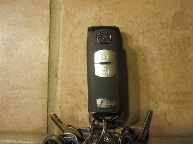

Ok, first things first. There is much discussion on this forum about the size of the RS fob. The car fob is 3" tall, and the remote fob is just under 3.75" and they are both the same width and depth. The size of the key ring on the remote fob should have been smaller, as that adds a good percentage of the additional 3/4" length. That being said, it would have been awesome if they would have combined the two fobs into one, because the two fobs do make for a bulky key chain. But to be fair, that goes for any remote starter fob.
Here are a few pics for comparison:
Remote fob on bottom:
And these compare it to a standard CompuStar remote starter fob:

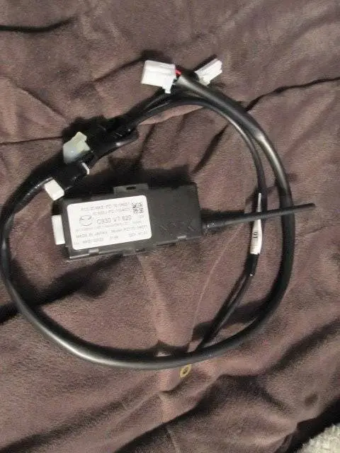

Here are a few pics of some of the parts fresh out of the box for reference.

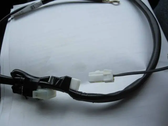

This is the ECU and the wiring that goes with it.

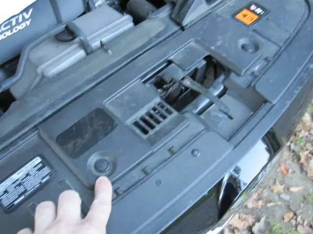

Begin by removing the two push pins to take off this panel. Be sure to pop up the center pin first with a screwdriver or you will damage the pins. You will need them for reassembly. Once the pins are removed, slide the panel towards the front of the car to remove it.
Remove this plastic cover piece by pulling up and gently outward on each side until you feel it disengage from the hidden clips and then carefully remove it, avoiding the parts it wants to snag on in the back. Also try to make a mental note of exactly how it looks when installed, it will help you when putting it back later.

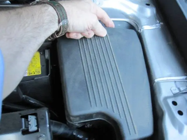

Removing the fuse panel cover is the first place that the instructions will lead you astray. They tell you to detach the tab at the front and then lift the rear. DO NOT DO IT THIS WAY or you WILL BREAK THE FRONT TAB!! The front 'tab' is actually just a hooked over piece. You need to push the clip in the back and lift first, then work the entire cover off of the front tab/hook.
The panel cover now makes an excellent place to keep track of all your pins, bolts, and screws.
For those of you following closely, yes this picture is out of sequence, we haven't removed all this stuff yet.

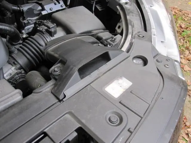

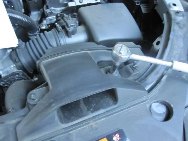

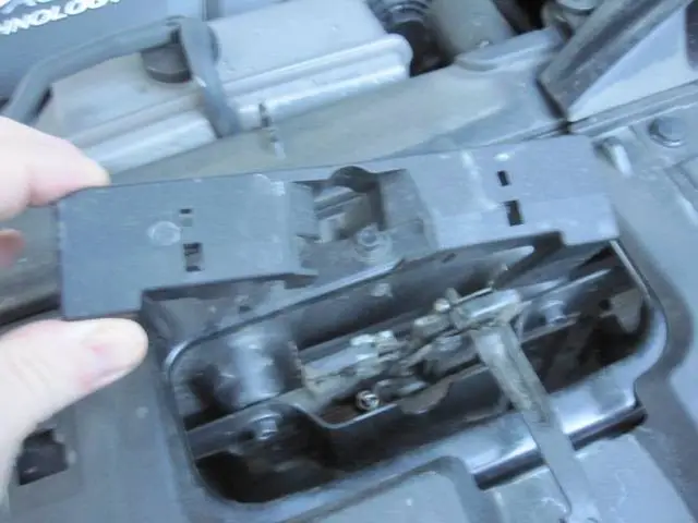

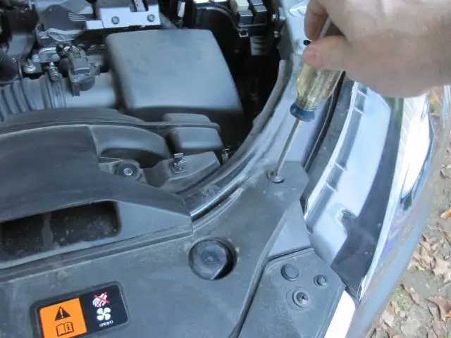

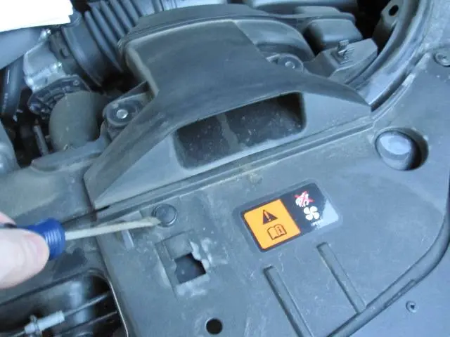

Remove the two bolts holding the air duct. The duct will not be removed, but you do need the bolts out.
This panel will not be totally removed either, just remove this push pin and one phillips screw on the other side.

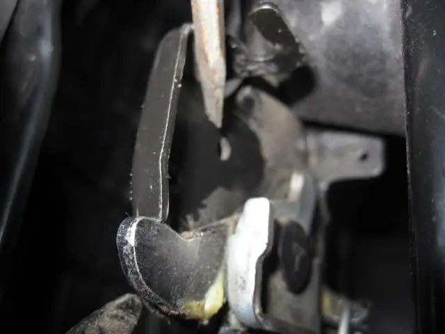

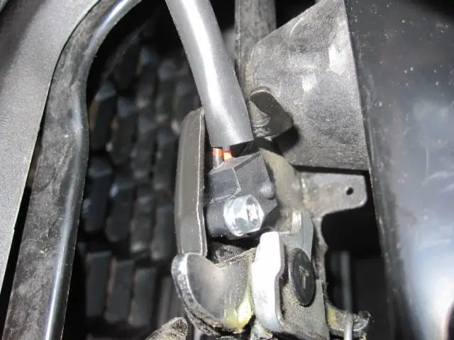

This is the next place that the factory instructions may frustrate you. Well, for one thing, they jump to removing the glove box next, which is ridiculous because the under hood part is not done yet. But also, the drawing of how to install the actual hood switch is virtually indecipherable (to me anyway). This will help...
Looking at the front of the hood latch makes it very clear where the one screw goes, but the actual positioning of the switch is as clear as mud.

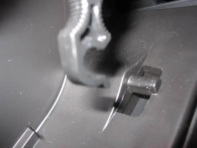

If you look at the switch, you will notice a tab protruding from both sides. I suspect this switch works on other Mazda models, because the CX-5 only makes use of one of the two tabs. This picture of the backside of the hood latch shows where that tab will go into.
The entire switch sits at a random awkward angle, but when you blindly try to put the switch into the right place, you will feel it when it pops into place. The thin metal switch prong goes towards the fuse panel side of the car, and the wires will go into the groove at the top of the image. Use the provided screw to mount the switch.

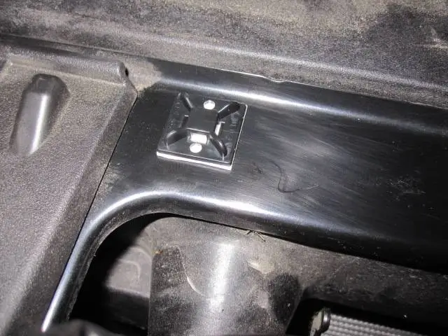

Next, you want to clean the metal panel behind the latch thoroughly and then stick on two of the three wire-tie tabs provided in the kit. Run the wire bundle as shown. Make the wire ties snug, but do not over tighten them. Clip off the excess from the wire ties.
Run the wiring bundle under the duct and panel we loosened earlier. Make sure that when everything is fastened down that the wire bundle is not pinched. You should be able to grasp the bundle from each side of the duct and tug it back and forth slightly.
The bundle will come out here, not at the far end of the panel. Clean the area and mount the 3rd wire-tie tab as shown, then tie the wires into place.

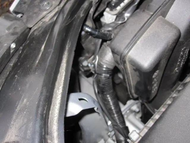

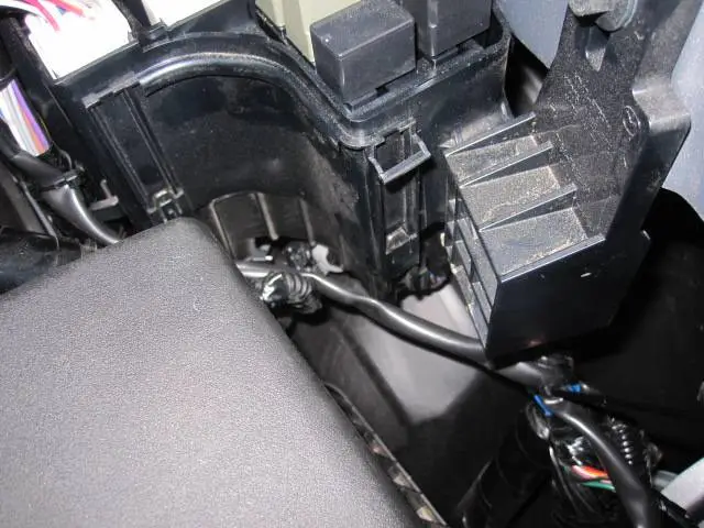

Run the wiring bundle around the factory wiring harness as shown.
Run the wiring bundle down along the factory harness, using zip ties in a few places to keep it in place.

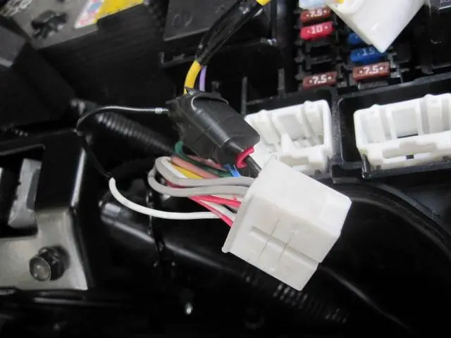

As you start to come around to the fuse panel, do not zip tie the bundle in yet as this will make it harder to work with the fuse panel connector. Do make a note though to not block the air filter cover from being removed in the future.

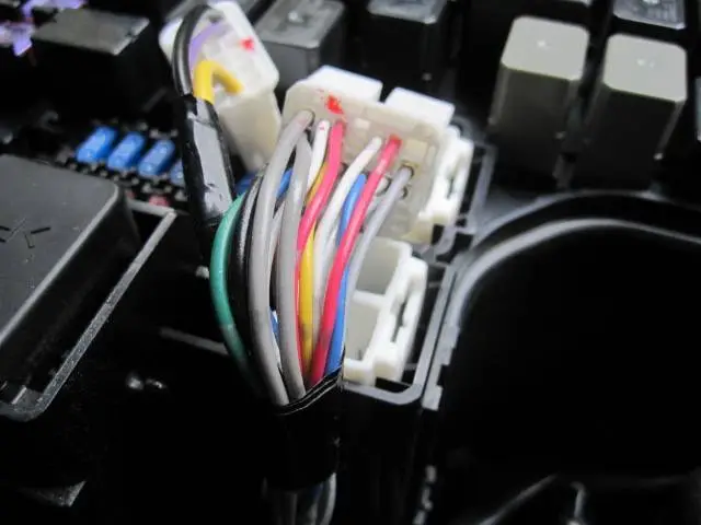

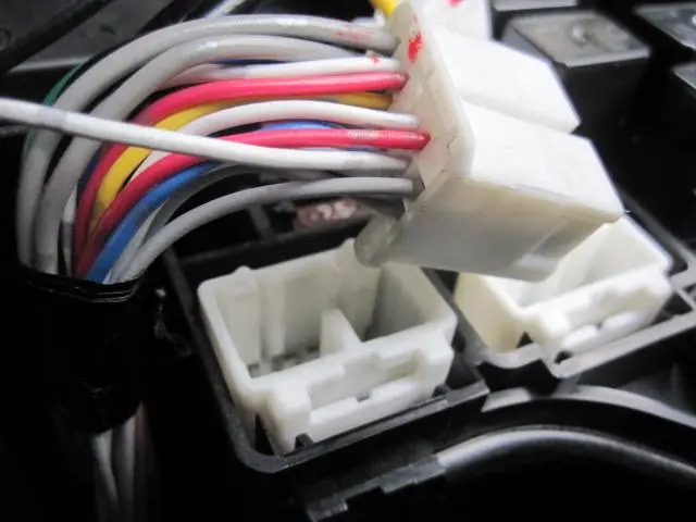

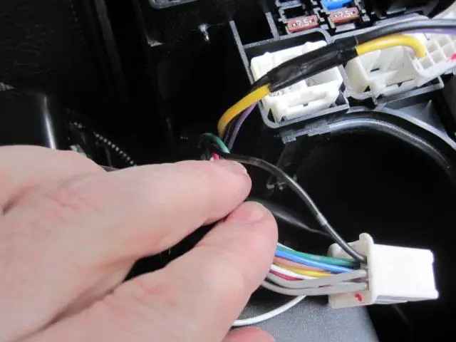

I removed both of these connectors to make my life easier, but I only used the connector with a lot of wires, not the one with only three (or more, depending on your fuse panel model) wires.
*** NOTE: This will vary depending on which model of CX-5 you have. The factory instructions clarify this, so please reference them as needed.
Regardless of which fuse panel your car has, the white wire from the hood switch will go into this empty slot I am pointing at. It is behind the red wire in my car, but the red wire may be a different color on yours. Again, refer to the factory instructions here to be sure.
Gently push the wire as far as it will go into the slot without forcing it at all. This will just help set it up for the next steps.
Use a tiny screwdriver or other tool to loosen the retainer clip using the two small slots on this side of the connector. It only needs to be loosened a tiny bit, not removed.
Now push the white wire in until it bottoms out. You may hear a small click, but make sure it is all the way in with no metal showing. Then push the retainer clip back into place; it should take only a small amount of pressure to get the clip back in. If it feels hard, then your wire is probably not in the right position yet.
Now, if you see the black wire shown here, then you have the same fuse panel model that I have (Type A) and this is the black wire that you want to tap into using the provided red 'electro tap'. If you do not see the black wire and that slot is empty, then you have a Type B and you need to refer to the factory instructions for the correct black wire to use from the other connector. Either way, the next steps will be the same, except the black wire you use may vary.
Remove the factory black tape that holds the wires of the two connectors together. Then separate the black wire to make it easier to work with.
Attach the black wire from the hood switch to the factory black wire using the electro-tap. The factory wire goes all the way through on one side, and the hood switch wire goes into the other side, all the way until it stops. Use pliers to push the metal tab in firmly until you can close the plastic flap all the way. It may not stay closed though, so be sure to use black tape to wrap the whole thing up.
You can now put the connectors back in, replace the fuse panel cover (taking care of the new wires) and finish adding zip ties to the wiring bundle as needed in a few places to secure it.

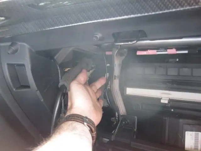

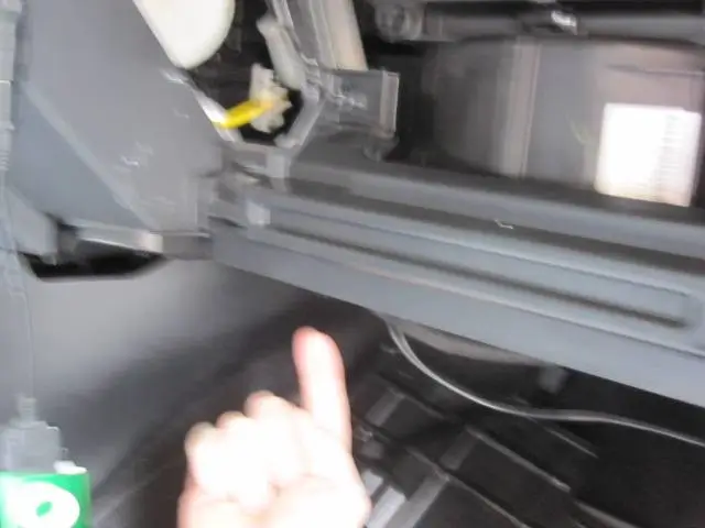

Now we can move on to the inside of the car. Surprisingly to me, this part of the procedure proved to have more snags than the part under the hood. There is nothing overly hard here, but the instructions were not clear at all, and you are working in tight places in awkward positions that the human body was never meant to be in. Have fun. :)

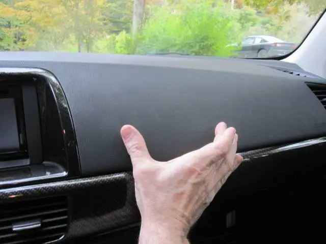

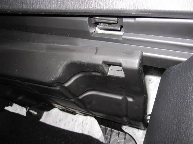

Remove this panel from beneath the glove box by using the two push tabs. Then guide it off of the one hook on the other side'
Open the glove box and push in the sides to release the pins from their holes on each side. Lower the glove box some more and then pull the bottom from the clips. There is a damper shock that needs to be unclipped as shown. You can now put the entire glove box in the back for safe keeping.

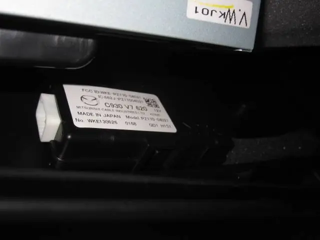

Use the provided foam to wrap the antenna of the ECU and cut off the excess. You will need the extra later, so don't discard it. Also, attached to 2-sided tape to the ECU as shown.
Clip the temperature sensor into here. Do not take off the black tape that is on this bundle.
Mounting the ECU is the next place that the factory instructions failed for me. It took me forever to figure out the spot where they wanted it to be mounted. Even with real pictures though, it is hard to describe exactly where it should be. The picture with my hand shows it the best though. Mount the ECU up and inside of the dash where my hand is, just above the black trim panel, with the antenna lightly touching the area by the head unit. Picture the antenna coming off of my lower thumb joint. The connector will be towards the passenger door side.
**Phew!**
Use the remaining foam to wrap the temp sensor as shown, leaving the actual sensor portion exposed.
In this picture, I am pointing with my middle finger (coincidence, I promise) to the factory connector where the 2-pin ECU bundle will plug in. Ignore the ECU bundle in this picture though. The bundle will be zip tied up where the pink tape is along the top of the glove box opening, and then run the connector behind the metal rail and plug it into the factory connector. Then run the other end of the bundle around and plug it into the ECU.
The bundle seems a bit short, and I had to use a zip tie to loosely attach the bundle to the factory wiring harness on the upper right side of the glove box opening. I didn't get a picture, but you should be able to make it work. Just make sure the bundle is up high enough to not interfere with glove box movement.

Went to my dealer yesterday to get a quote for parts. Apparently there is a new C930-V7-620 module, called C930-V7-620A.
The quote states that C930-V7-620A replaces C930-V7-620.
Anyone aware of this and what changes it brings?
The part is listed on the MazdaUSA site under accessories, not much description about what it does different compare to the other part. I just ordered my so if the C930-V7-620A replaces the older C930-V7-620, I may get the newer part.
After a search on this, I would say that the "A" at the end indicates that it is for automatic transmissions only.
