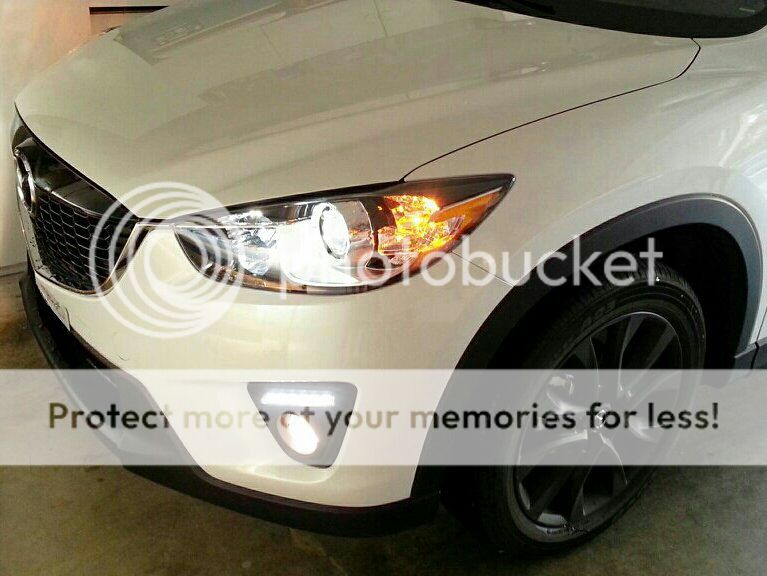

Here is a pict:
I have completed my install recently but haven't gone around to work with the dim/off function of the LEDs. The blue wire (when attached to a 12v switchable source) will dim the LED when there is current. The white (when attached to a 12v switchable source) will turn off the LED when there is current.
