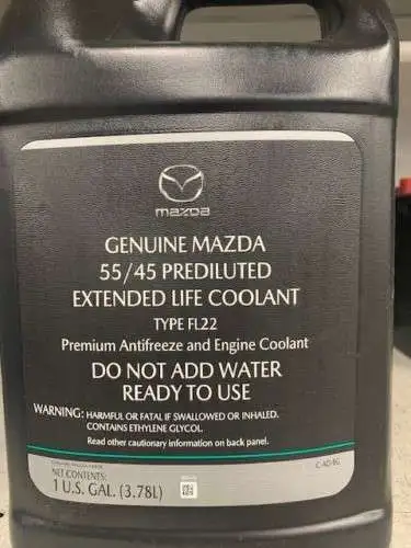

I recently purchased coolant for my CX5. Its a different part number than the one you posted. Do you think its ok to use?
If your Mazda genuine FL-22 coolant has p/n 0000-77-508F-20, it’s fine. It’s the US FL-22 coolant in 1 US gallon package.
