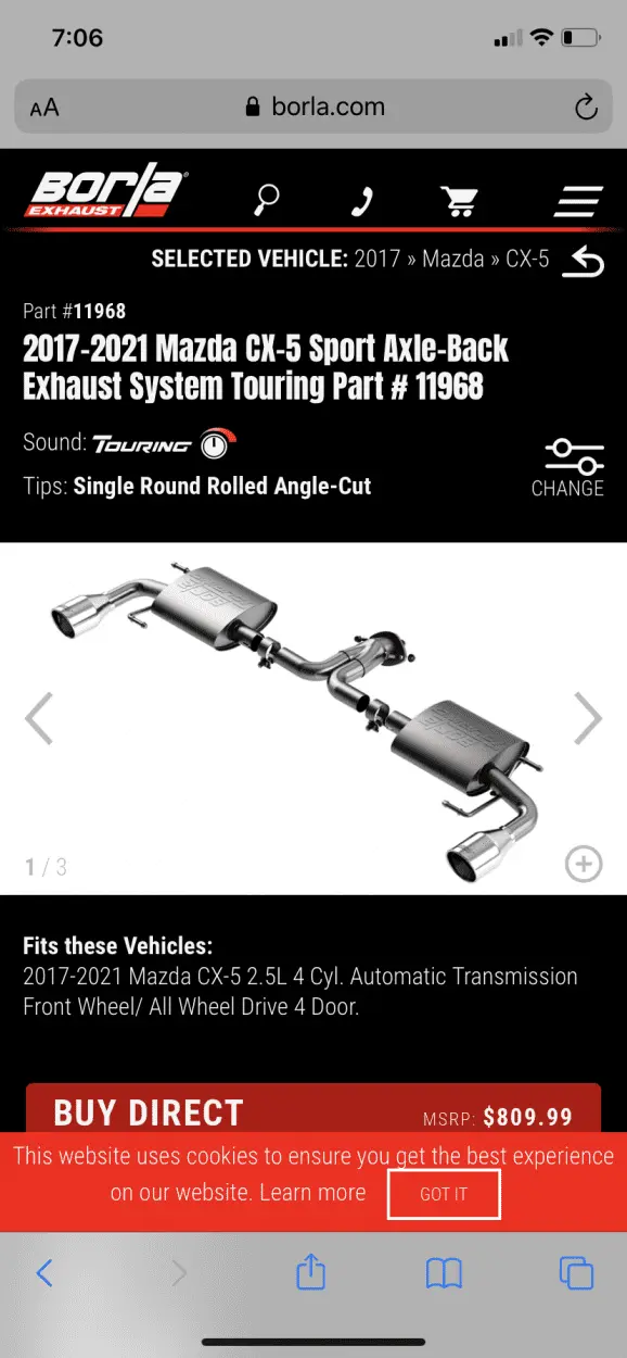

Pulled the trigger and purchased a Borla Exhaust from Summit Racing today. They had the best price with free shipping.
Is that for Turbo or NA?
This was the question I asked Borla during my research because there was no mention of “turbo” in the listing. (My Carbon Edition is turbo.)
The listing states NA. I was told by Borla, the exhaust is setup for both, and there is no plan for a seperate turbo version. I will know on Saturday if this gamble pays off.

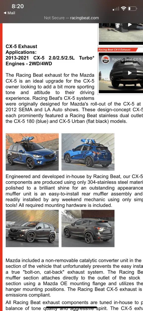

Same size. It seems Race Beats is also using the same setup for NAs and turbos for their CX5 exhausts.

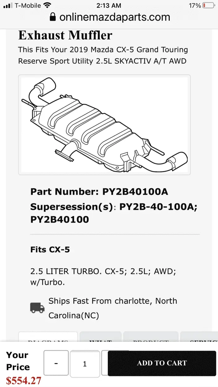

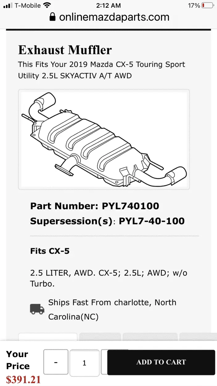

I believe so, or at least they’re different. The part number on muffler is different between 2.5T and 2.5L. And the 2.5T’s muffler is more expensive.
