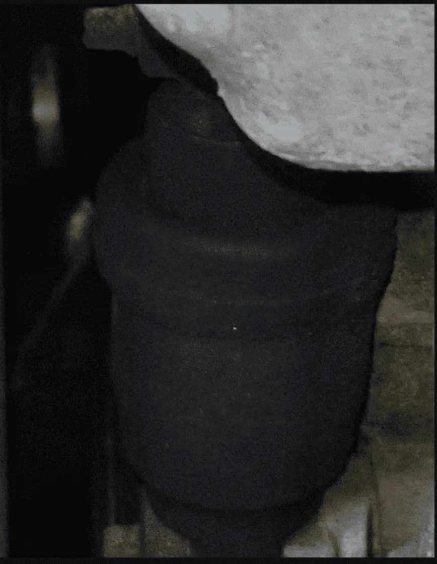

2013~2016 CX-5 Belt Tensioner - Shouldn't this be a warranty item?
i cant see much from the picture, too dark,
but it kind of looks its oily residue mixed with dust. touch it with your fingers to confirm. Changing it is a good thing except the money factor :) and its not hard to change, there are some quite good instructions as well.the wheel needs to drop off and access to the bolts is from there.
Also if you've never changed the belt, it would be good to do so with removing the tensioner.
