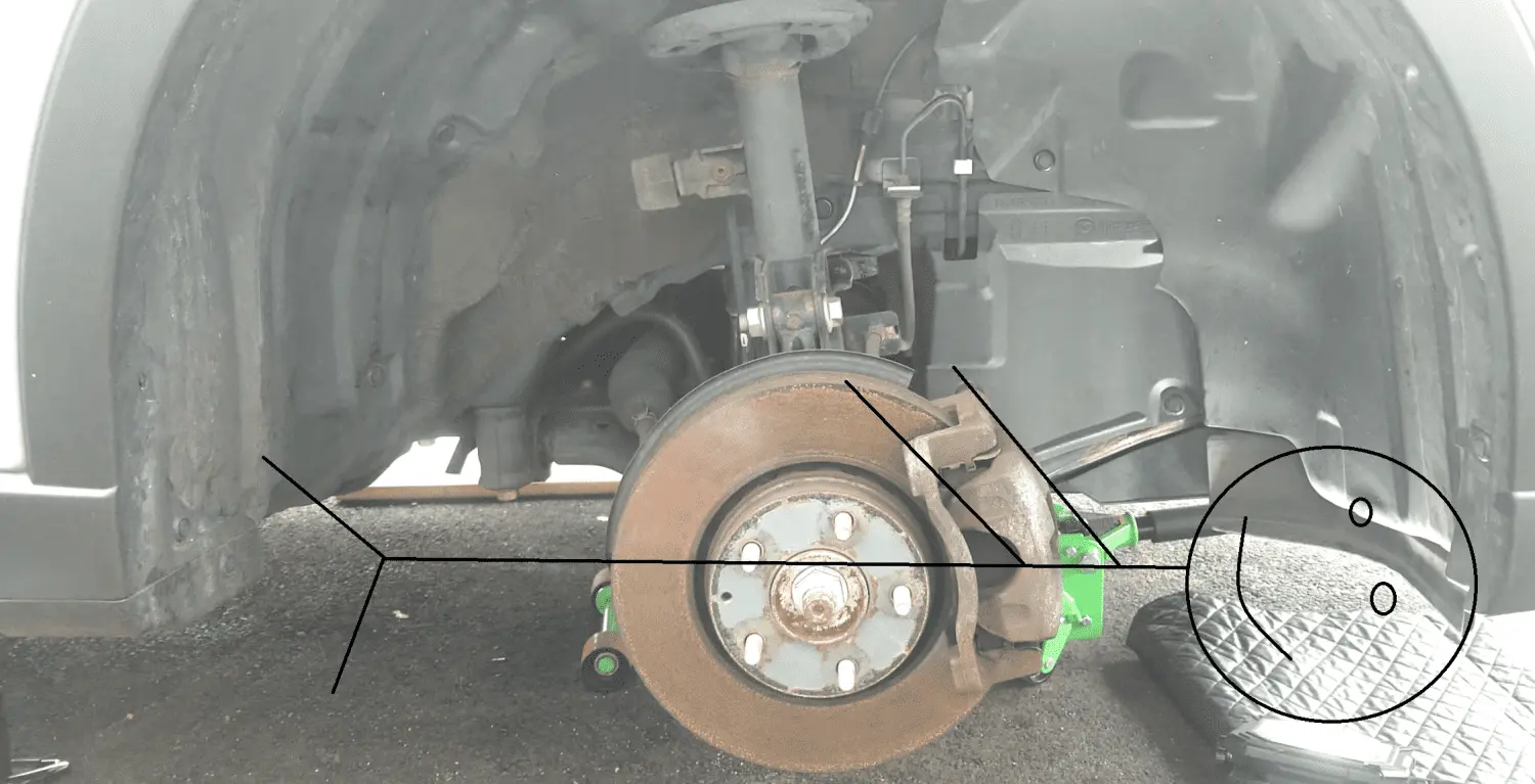

I think most people are using creepers with casters (rollers) but I am not. This would also affect your leverage as well. My way of going underneath the vehicle 100% of the time is using a "https://www.amazon.com (commissions earned)" and this allows me to not only be flat against the floor but I also don't need to jack the vehicle that high to access anything.
My Body Position (Example)

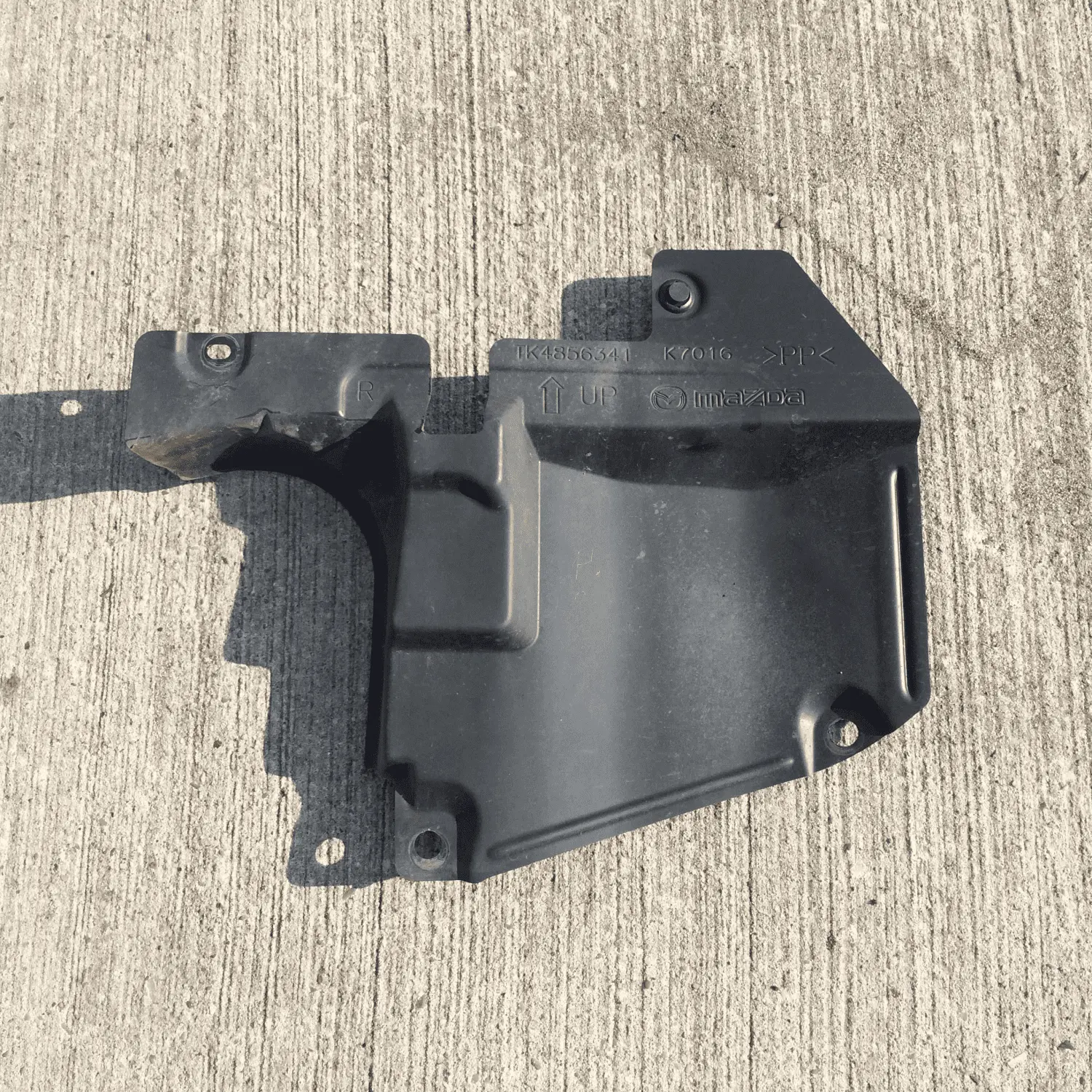

Inner/Outer Splash Shield + Wheel Splash Shield Removed

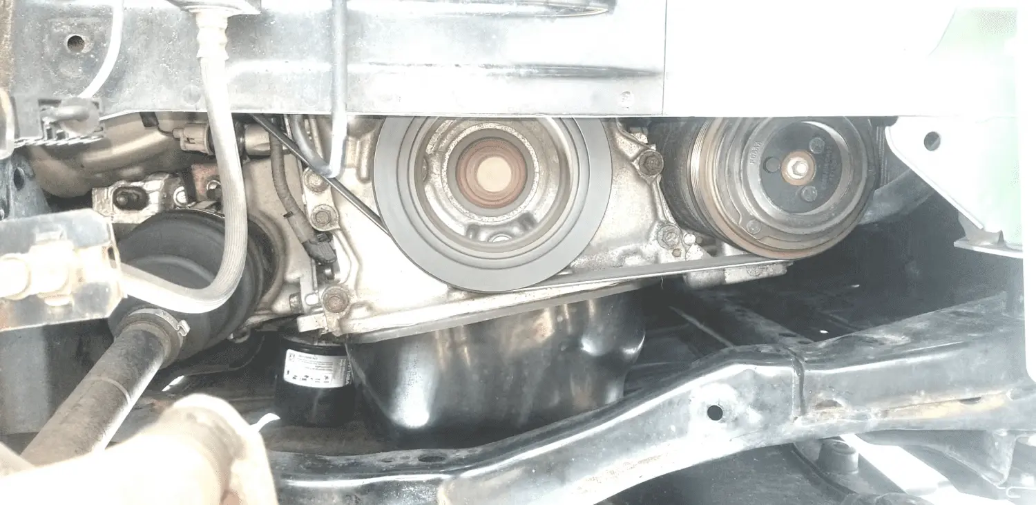

Tensioner: I crouched in wheel well to simply relieve its tension and replace serpentine belt.
Water pump belt: I used a creeper and kept rolling away lol. I must've used a towel to keep creeper in place. Laying on creeper gave me leverage to be able to push the belt into pulley. Did you use a tool or simply pushed it in with your hand?

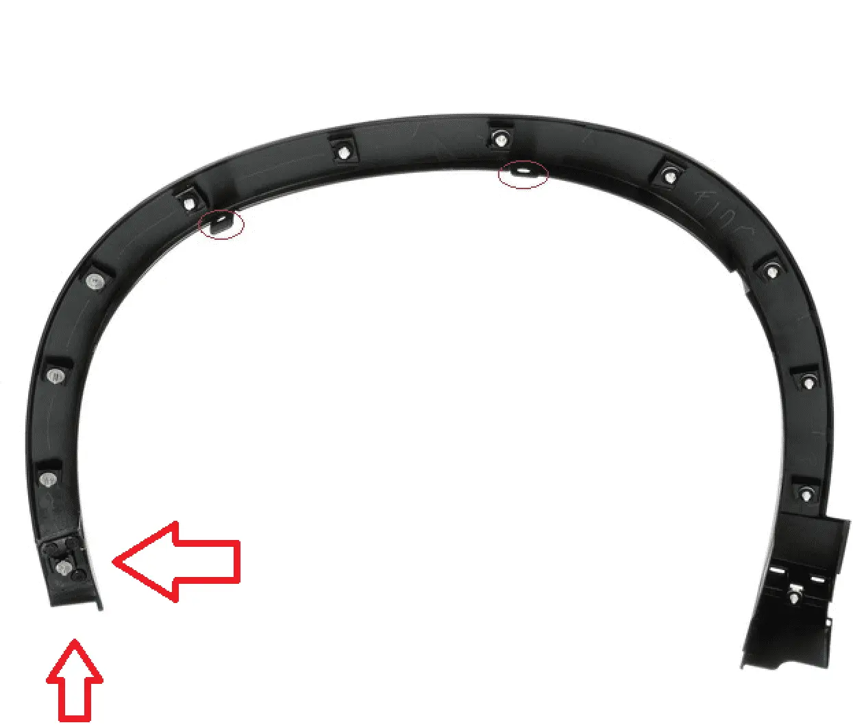

1. Fender: This part is pretty easy to take off. All you need to do is pry off these rivets (see red) securing this fender using a tool. Afterwards, you choose a corner and start prying it towards you using your hands and they will come off, no tool required. The corner with the red arrows was the easiest for me to start.

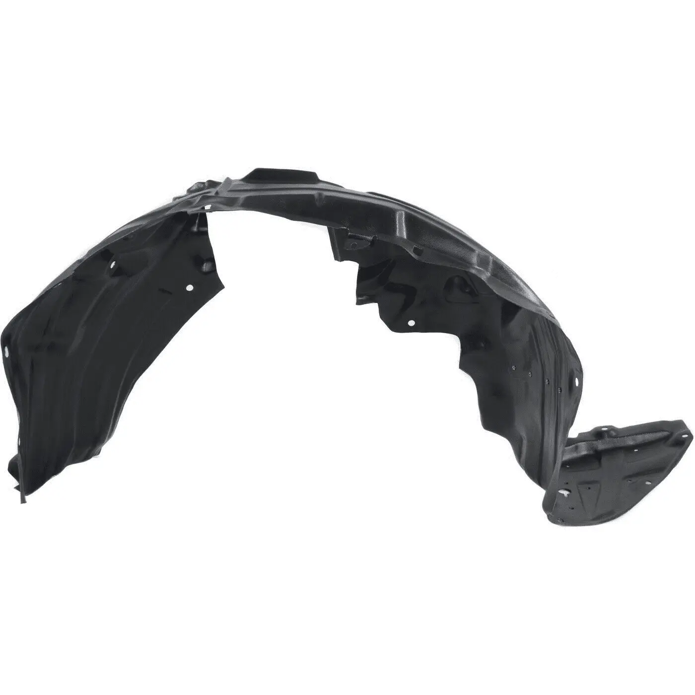

2. Inner Splash Shield: For this one you just need to pop off (4) rivets and it comes off.

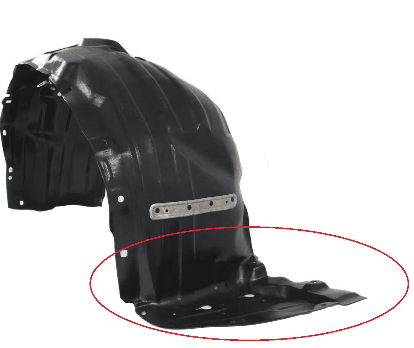

3. Wheel Well Splash Shield: This whole thing is pretty much held on by rivets and two bolts. I think it was 8 mm. You should start off with the portion that I highlighted in red first because that portion is blocked by the underbody covers that are held on by (1 - 2) rivets + a few 10 mm bolts. Once you have that part highlighted in red removed, just work on the bigger portion and the whole thing comes off.

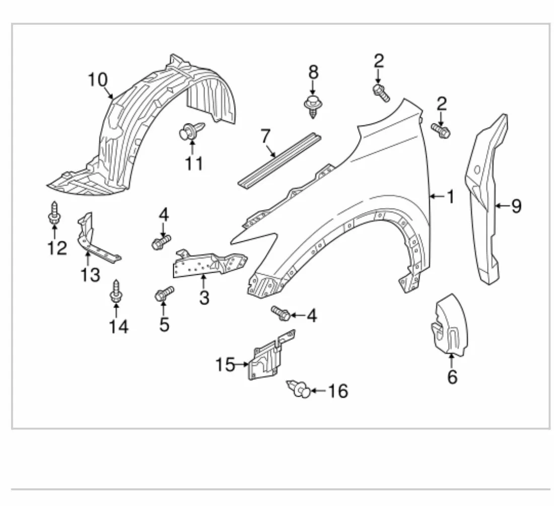

Mazda uses several different kind of plastic clips and rivets. In fender liner area they have:
#8: Body C-Pillar Trim Panel Clip - Mazda (p/n: GJ21-68-885B-02)
#11: Splash Shield Rivet - Mazda (p/n: L33X-13-209)
#16: ?
p/n L33X-13-209 rivet is used the most on CX-5 and the one Digbicks1234 got should be compatible to this OEM rivet.
#16: ?
When I took out all of the rivets for the (3) splash shield items, all of the rivets looked the exact same to me aside from the Fender rivets which did not break at all. I don't think the other rivets in that diagram are applicable. I wish I took a picture of my tray but I forgot to. You guys will just need to take my word for it I guess :D
