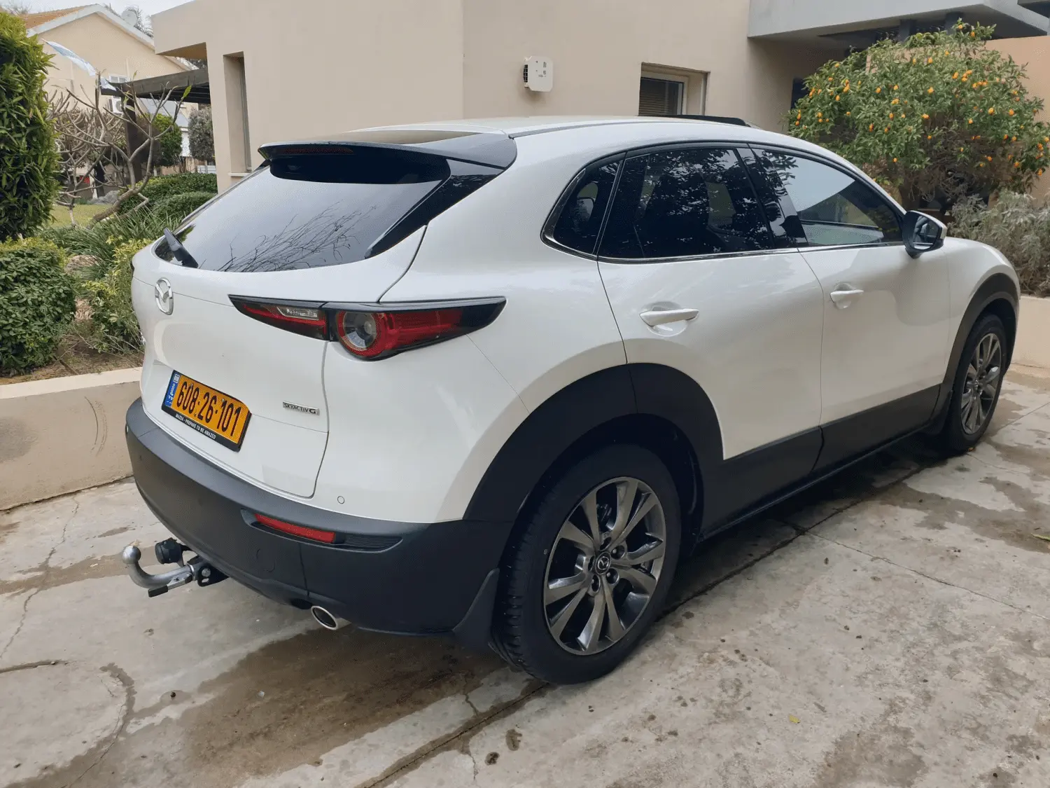

This is an European CX-30 with a tow hitch installed (called a "tow bar").
I saw this in a CX-30 group, and HERE is the link.
