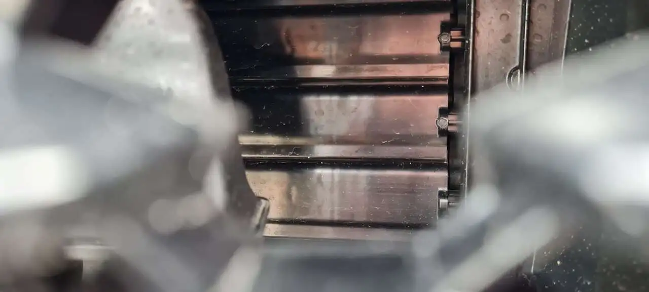

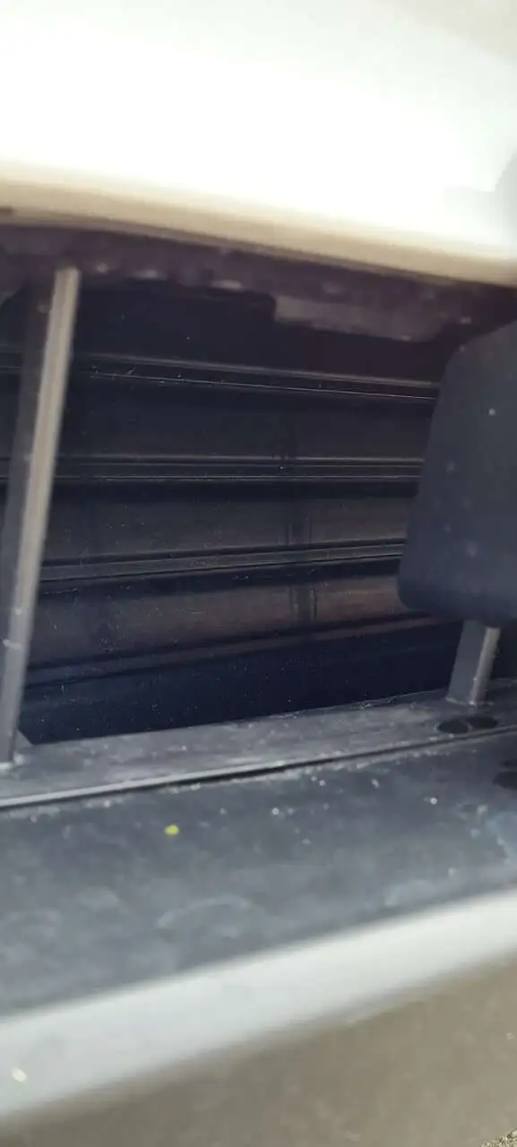

Question for you all, does your CX-30s have these "flaps" in front of the engine bay/cooler?
They start out closed and open up when the engine gets warmer.
