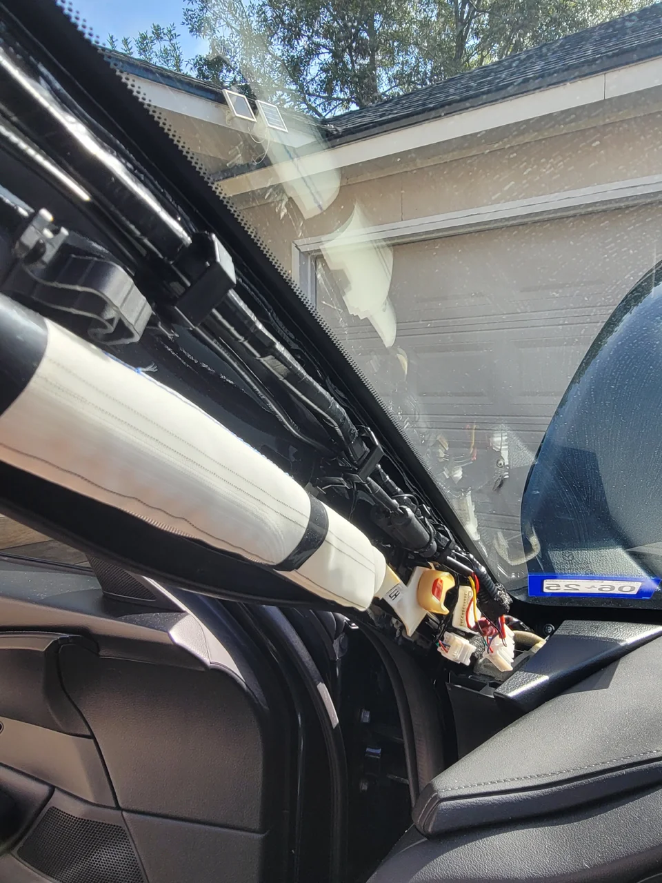

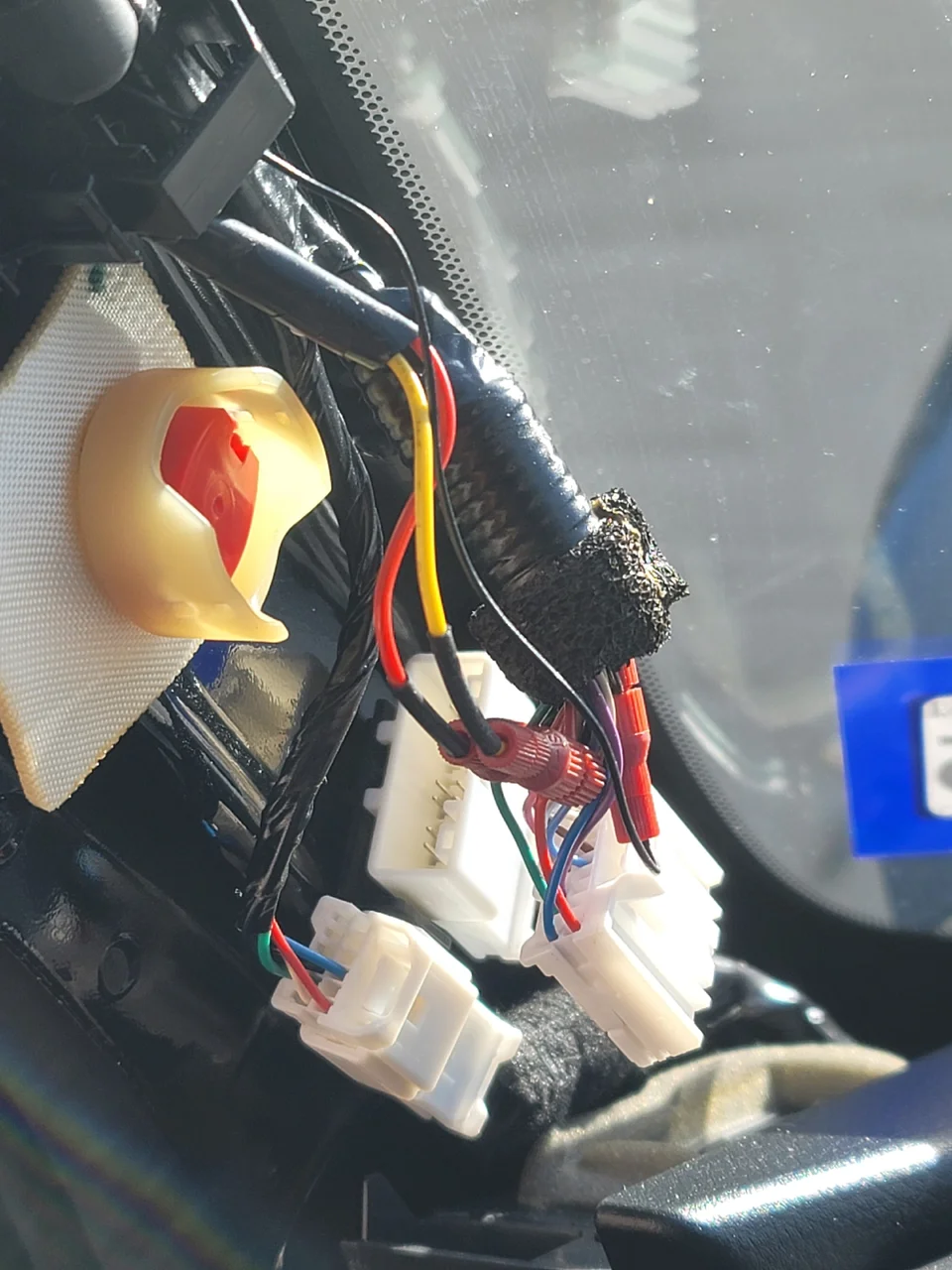

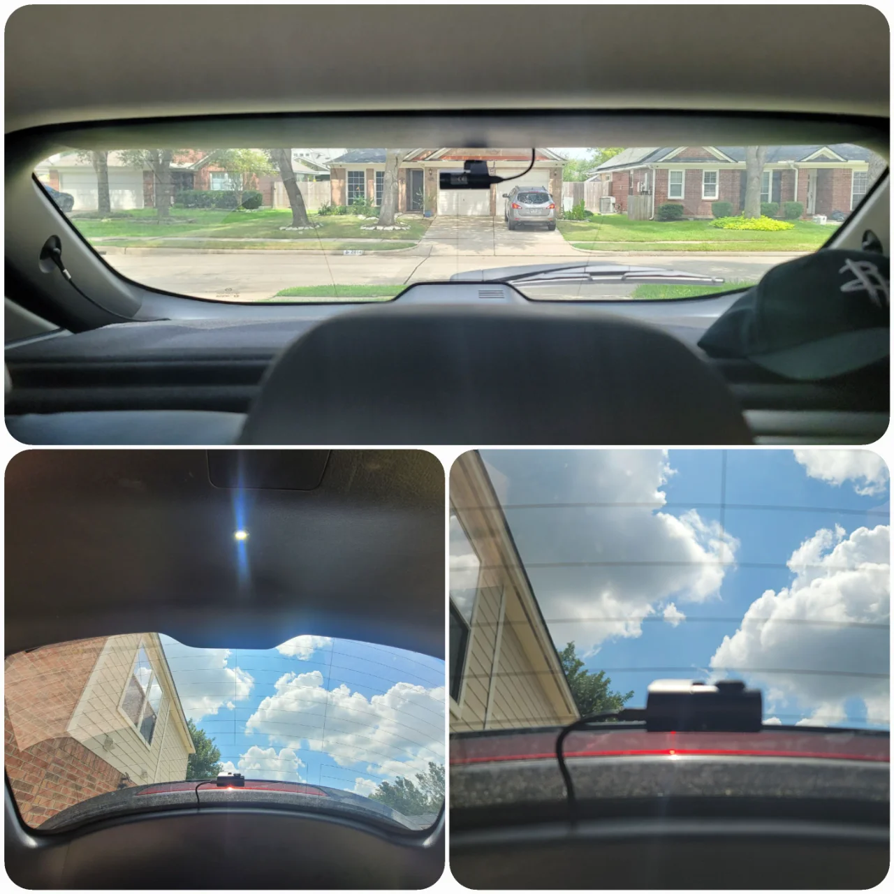

Last week, I installed my Thinkware U1000 (I had to install it lower than normal because it would hit the rearview mirror if it was higher).

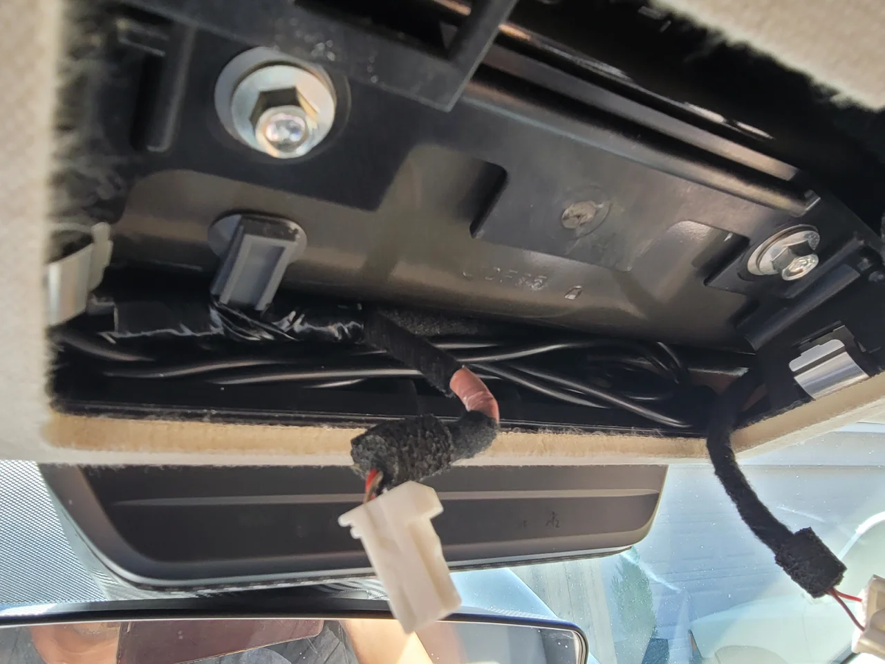

Since I didn't have the frameless mirror/homelink. I used the instructions to install one so I can get the "hot", "acc" and "neg" from the harness shown. I used posi-taps.
I tucked the extra cord behind the map lights.

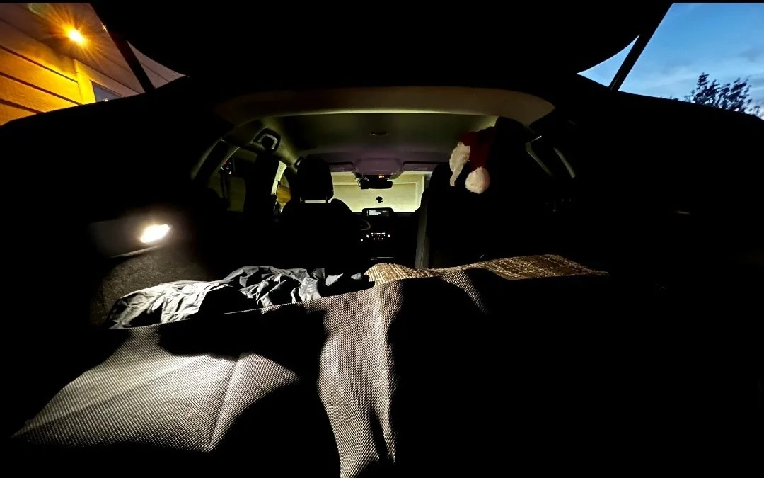

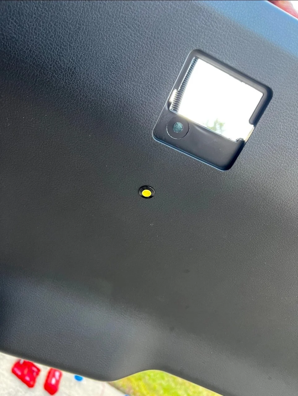

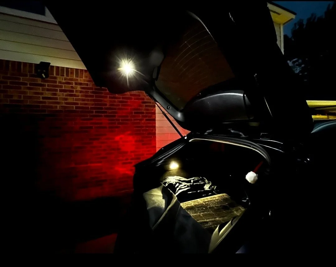

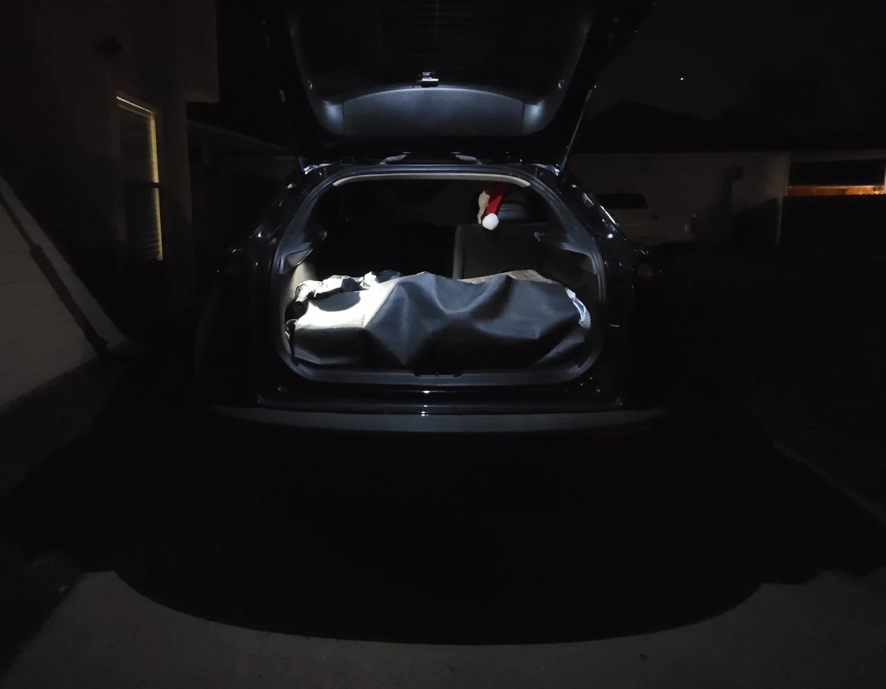

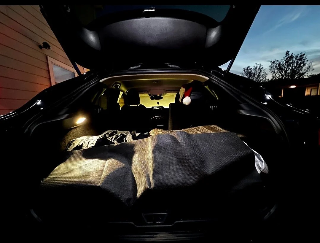

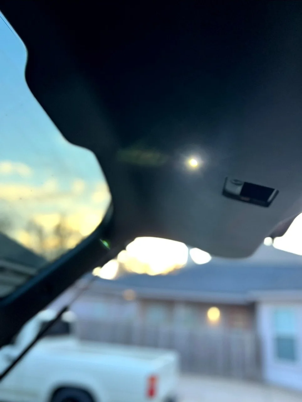

Since I had to run the rear camera, I went ahead and added a oznium led light. The OE light is not enough IMO. I tap'd into the existing OE light.
Here's the before and after of the trunk space lighting.
