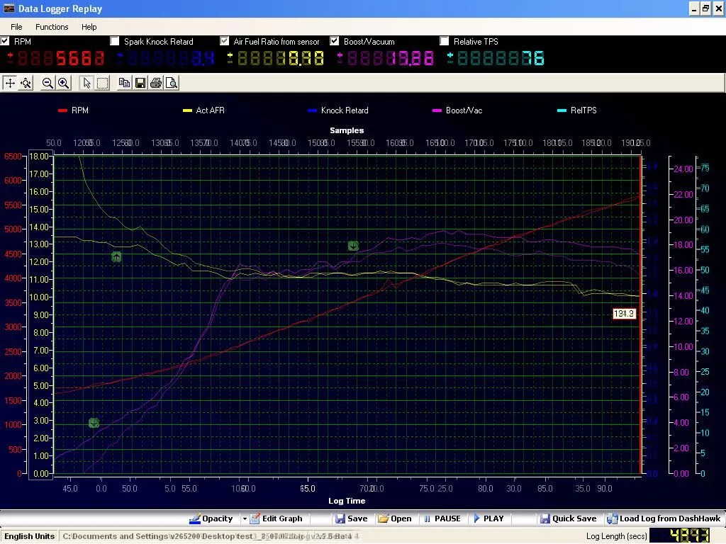

I included AFR in my log to show you on spool up its safe!
the log is done from 4th gear 1500rpm WOT to max rpm to give MAX load on the motor.. i dont see a lean condition do you ?? I would definatly do some homework on how your motor is running b4 doing ANY mod thats always good advice.

Here is an over lay of b4 inlet and after inlet green arrows are point to the after inlet lines... (scaling for RPM Boost and AFR are equal) this shows a good example of the effect....

I think whats happening in this case is that the air from this inlet is smoother, thus allowing the turbo less effort to make its boost targets. So we see commanded boost hit it's target sooner.(drunk) lol
