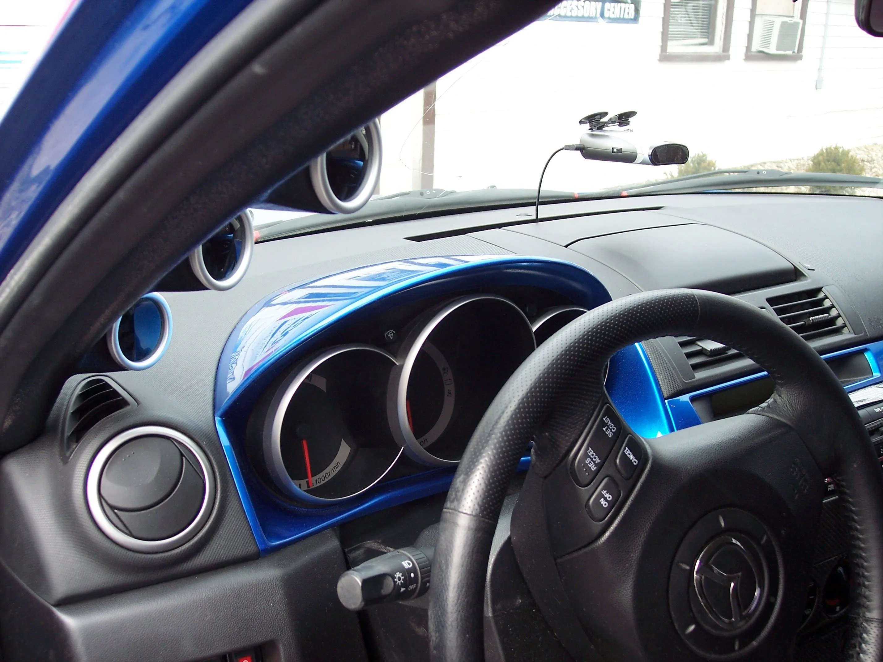

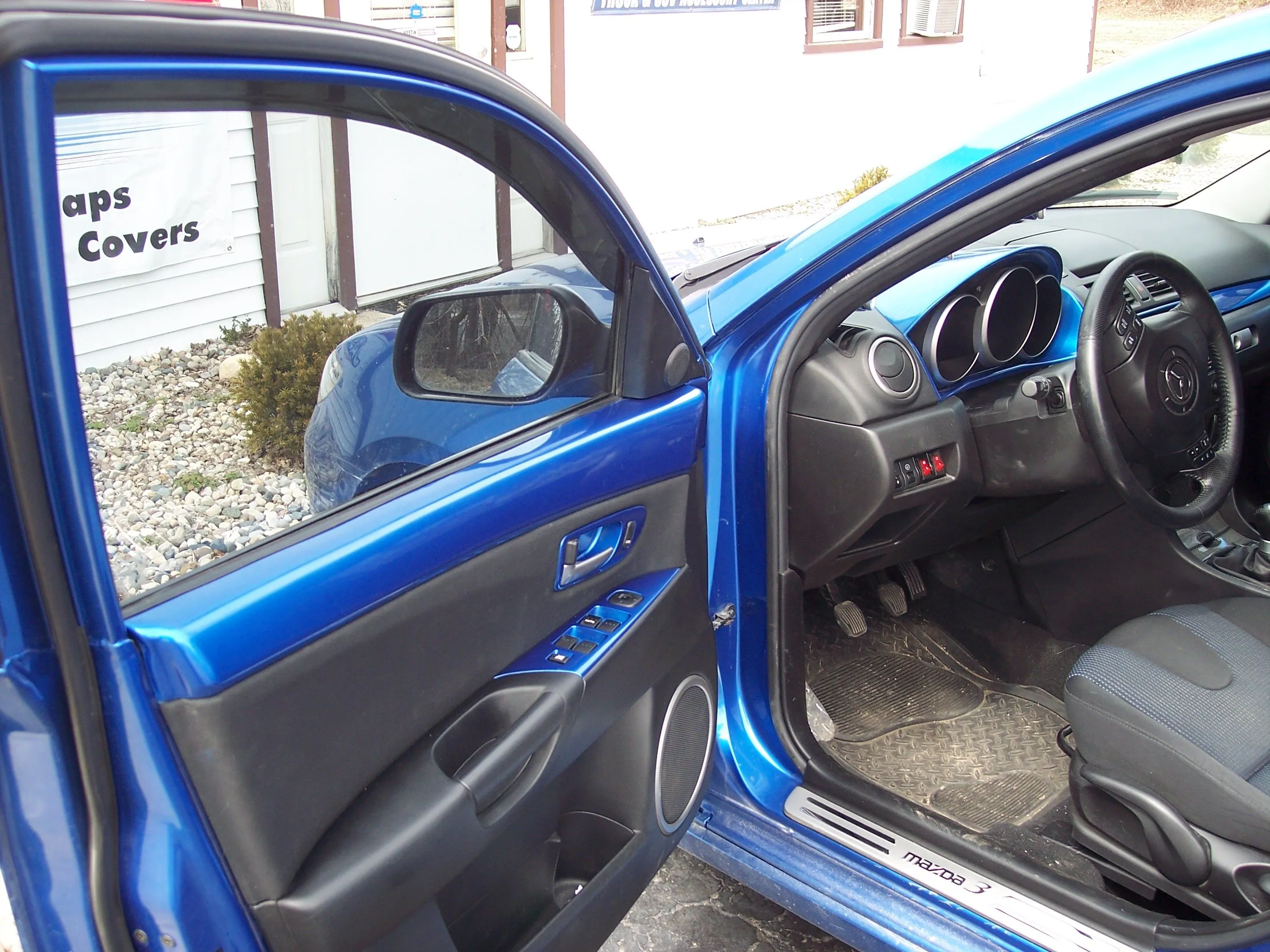

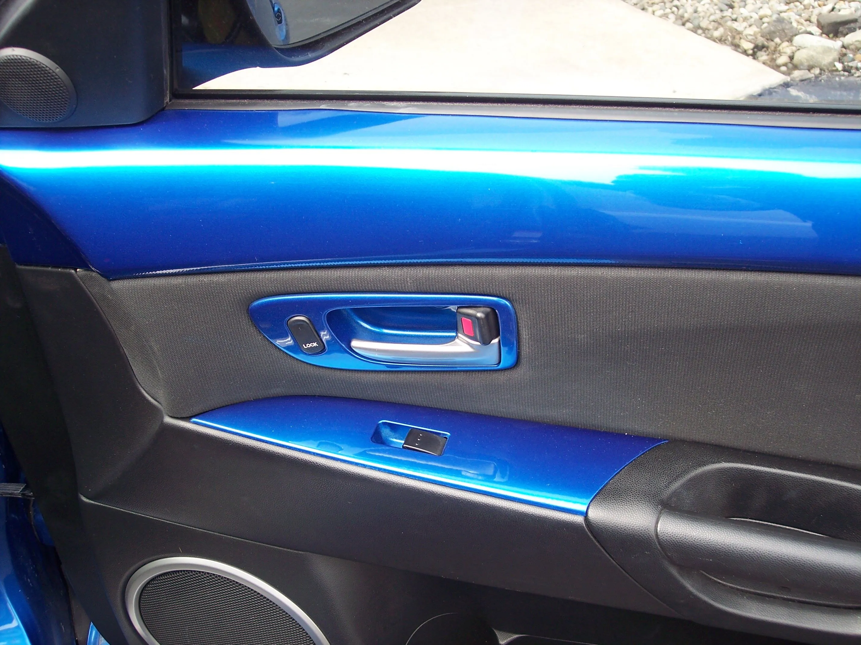

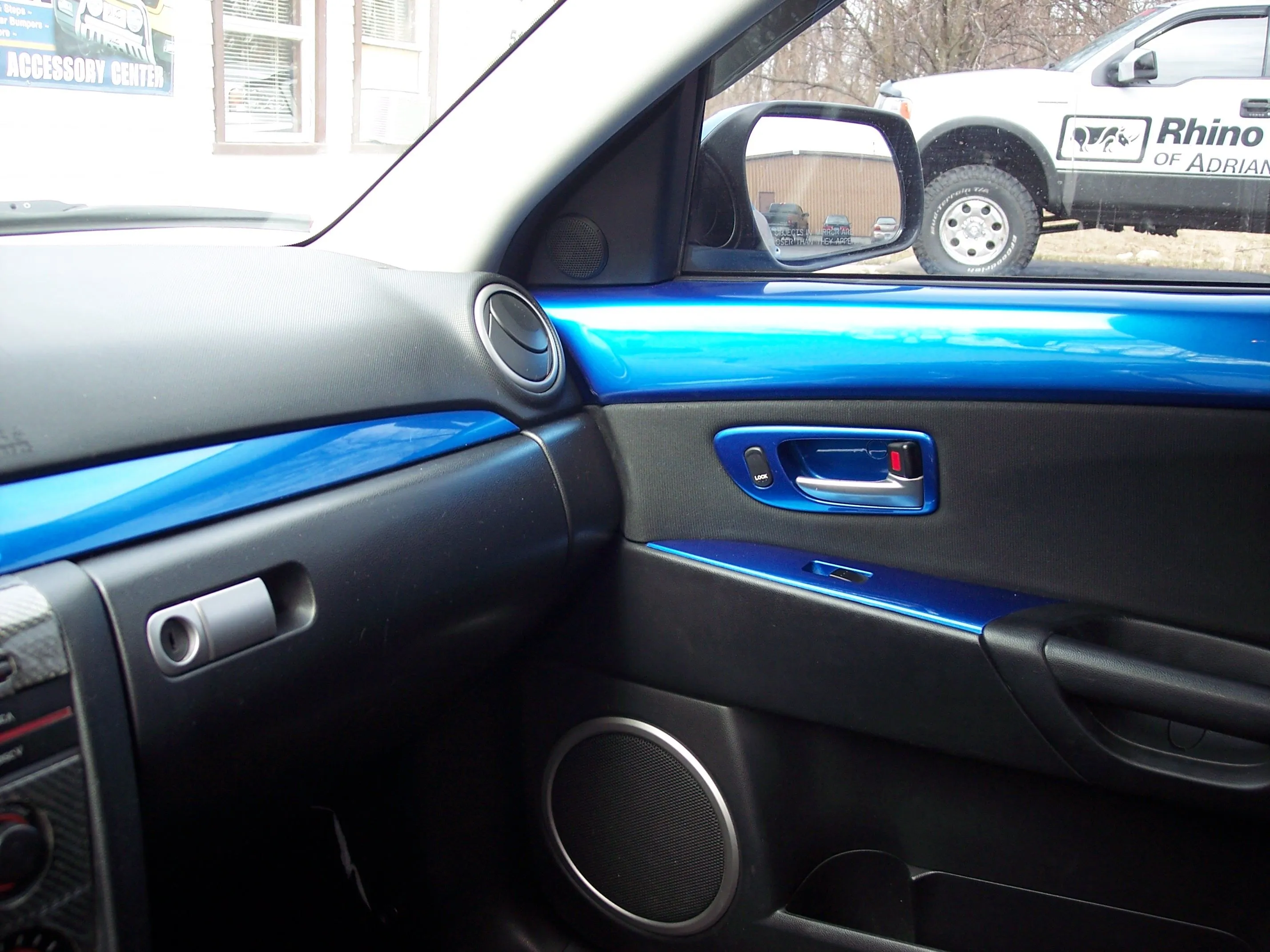

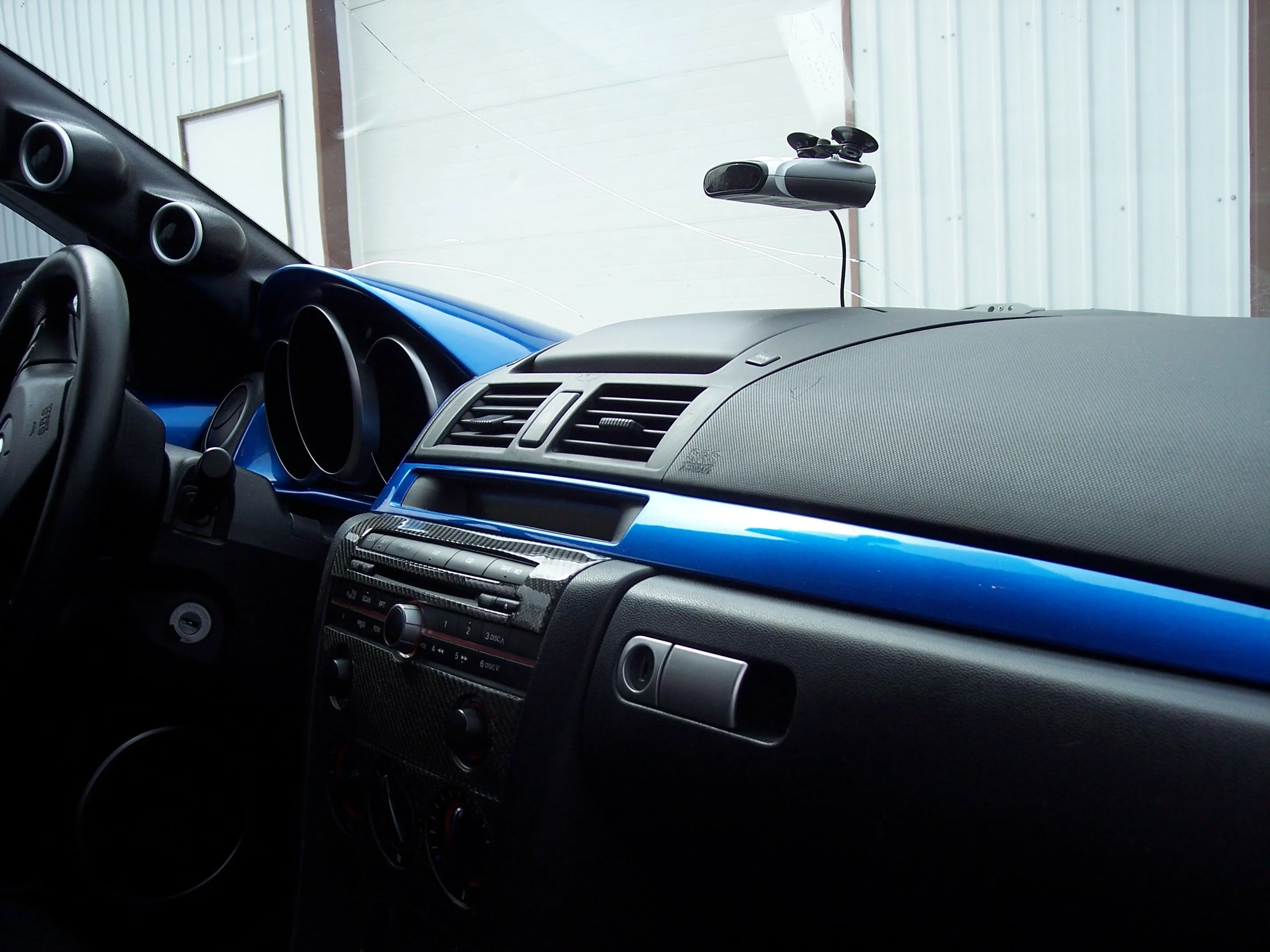

Ok so it took a lot of work to get the texture off of the top of the door pannels, but i got it done. The color is PPG paint and its the color code of my car. At night if you take a flash light to it you can see all the purple in it, just like my car. Anyways enjoy.
P.S. I plan on getting my seats reupholstered, i was gonna go with the katzkins but couldnt bring myself to spend $650 on seats, Especially when i need a new windshield.

Umm $60 for everything painted. My girls dad works at a body shop and has everything out in the garage to do the stuff. He had me pay for the paint and do all the prep work and then he sprayed them. Not a bad deal at all. (cabpatch)

I dont know what dolphin glaze is but we did have to use a little bondo in some spots. For the most part to get rid of the texture we used some sort of primer called 2 K. Its a thick primer and then i sanded it down and that left the low spots and then we primed it again and sanded, then that took care of most of the texture.
