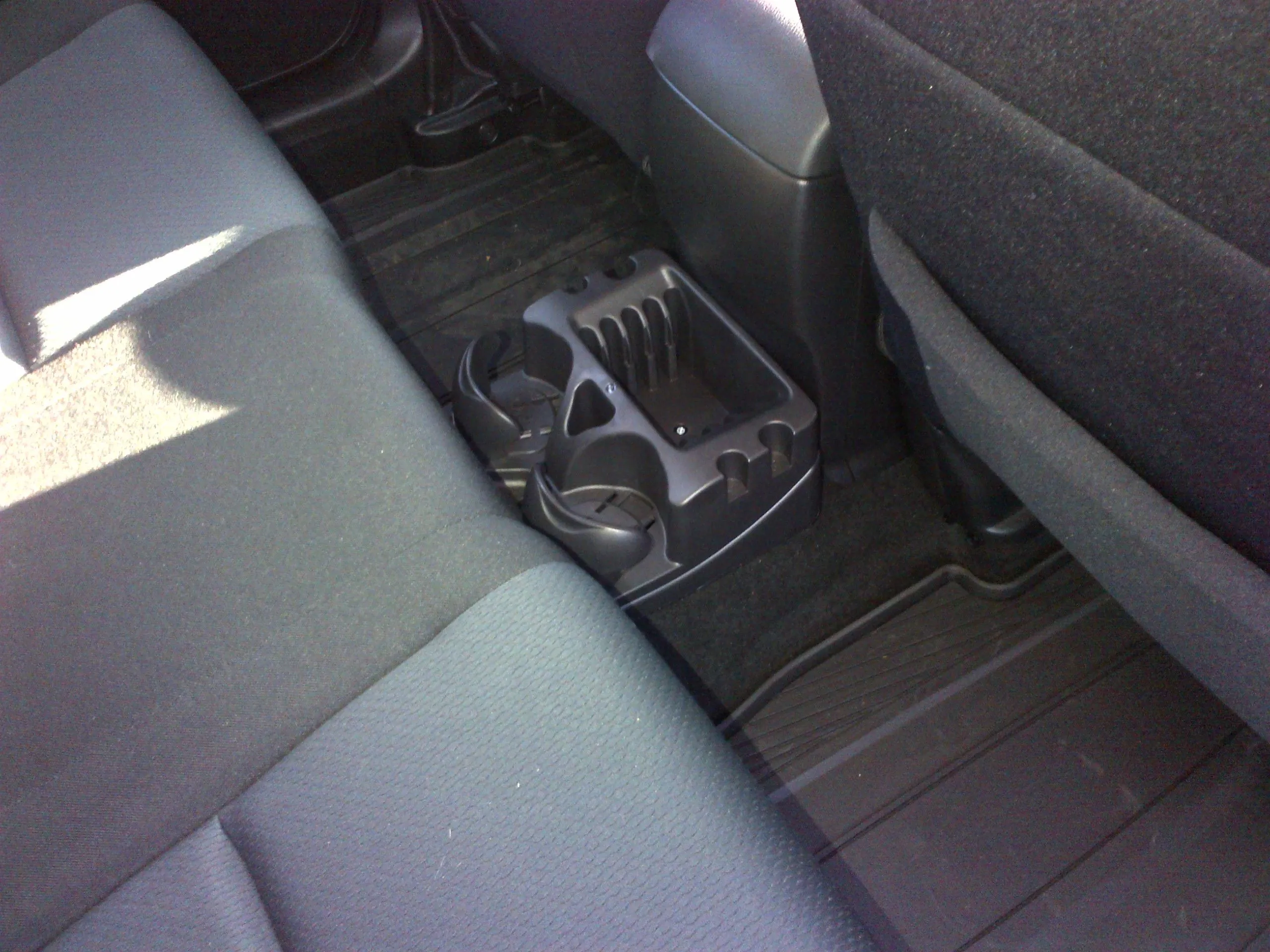

This may not suit everyone's tastes but it's working for us. This cheap ($9.99) cup holder from K-Mart is just the right size to fit on the driveshaft hump between the console and the rear seat. It matches the interior colors well and gives our grandson a place to put his drink.
It fits fairly tightly between the rear seat and console but I wanted to fasten it a bit more securely. I cut a piece of 1/2 inch thick wood to a 4x4" size and covered one side of it with self adhesive Velcro, stapling the edges of the Velcro to the wood to make sure it doesn't come loose. Then place the wood Velcro-side down on the driveshaft hump, place the cup holder in place on top of the wood, and run a short wood screw through the mounting hole in the cup holder and into the block of wood. Nice thing about mounting with Velcro is that it can be easily removed if you need to haul three passengers in the back seat.
I wish Mazda had used the 40/20/40 rear seat with cup holders in the Sport but, since they didn't, this is a cheap solution. Hope this post helps someone out.

I installed the same cup-holder from Pep Boys today. Used the dremmel to cut part of the plastic out to make it fit level and snug. Did not need to drill or use Velcro... I can pull it out of needed but it is in very snug and no worries about it moving or shifting. Let me know if anyone wants to see pics.
I absolutely would like to see photos-only a couple miles from a Pep Boys-would be very helpful-thanks!
