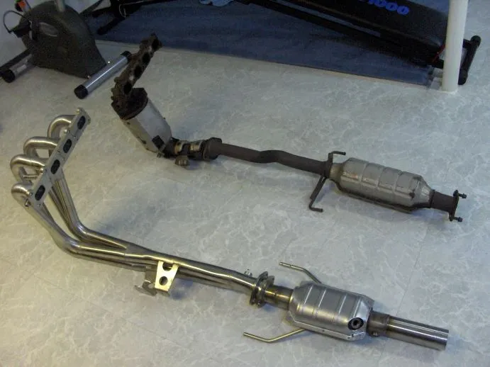

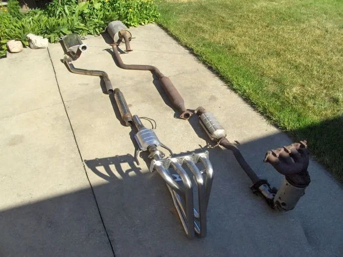

Probably, but I think I've moved on to something a bit more custom...what do you guys think of this? I'm seriously considering it (and modifying the rest so that I can sell it as a bolt-on for others).

Whats the header in the pics?
The pipes are really long, not sure if they might be a bit too long.
without measuring them i couldn't tell you if they are too long...however - long headers ARE The way to go... the proliferation of short headers makes everyone think they are the way to go - but the opposite is true. the shorter the runners (particularly primaries in tri-y designs), the higher the RPM they are "tuned" to. The run of the mill shorty headers that are available only provide power gains by virtue of increased flow - they do not really start working until well over the engine speed that the engine is capable of running. Long runners allow you to leverage the scavenging waves earlier, and put them in the usable rev range......basically long headers (if you can afford the custom price tag that often goes with them) are the way to go..
I like that longheader..........
I do have one question though, how would you get thatsucker in the engine bay without disconnecting radiator hoses and lifting the car up on a lift?
lol....i think that's exactly how you have to get it in.
then that answers my question. lol
Sorry, i had just woken up
Yeah...... I'm not seeing this going in from the top...lol
Totally custom!
